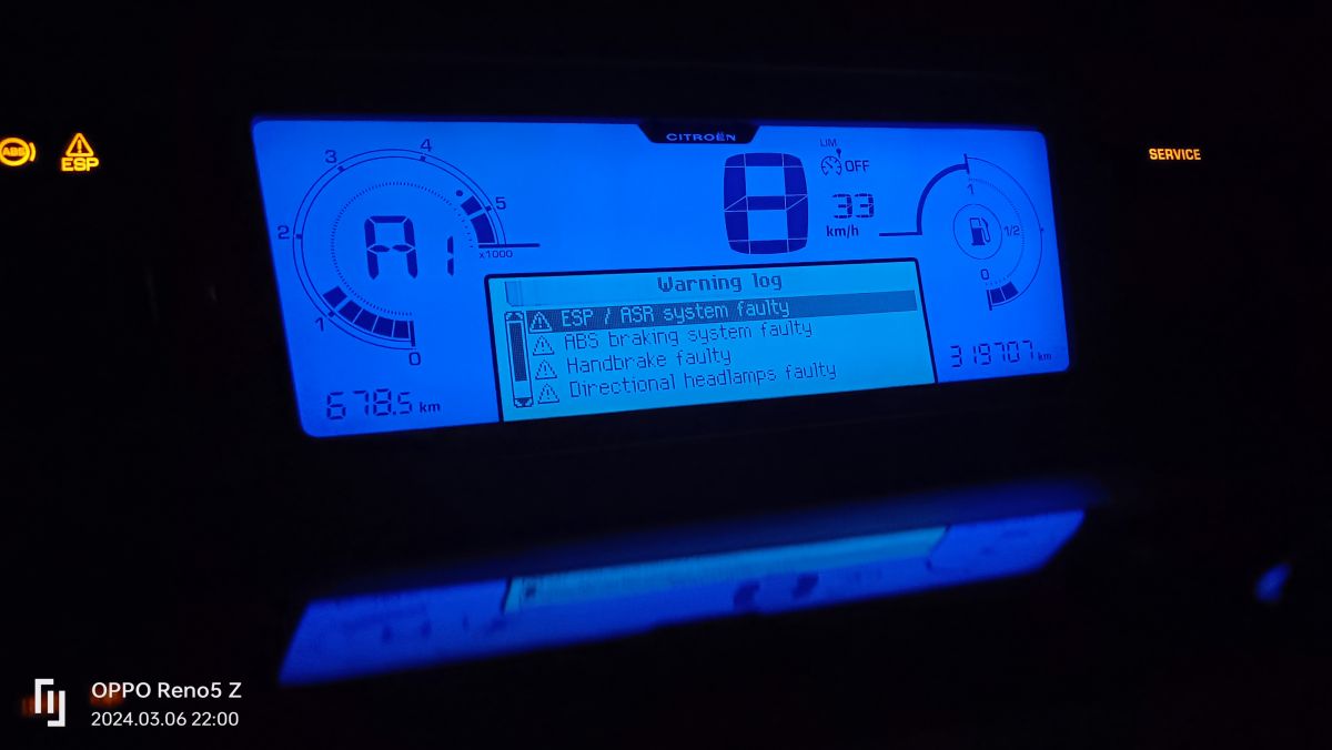

    I connect to the topic I have a similar problem every now and then the manual i / Esp light turns on (photo connector) plus the word service in orange, we are fighting with the mechanic, but the replaced cubes sensor under the pedal does not help much, the sensor under the pedal generally runs ok when throwing an error only what the hill start block is missing, then it does not work and sometimes there is a problem with manual lowering (normally electric is on). Do you have any ideas where to look ???
    C4 Grand - 2007 1.6 HDI
    • Citroen C4 Grand Picasso 2007 - Esp / asr handbrake error, emergency mode IMG-20190806-WA0005.jpg (79.93 KB) You must be logged in to download this attachment.
