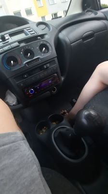

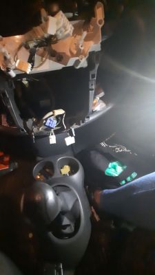

  • #8 18792485
    Patrycze97
    Hello gentlemen, I have a problem I have toyote yaris 1 from 2005 1.0 and I can't find the iso cable for the radio I ordered but it is a few mm too small.
    Maybe someone knows what to order?
    And now the question is important up or down the radio?
    Toyota Yaris 1 (2003, 1.4 Diesel, Japanese): New Radio Installation, Costs, Speaker Replacement Toyota Yaris 1 (2003, 1.4 Diesel, Japanese): New Radio Installation, Costs, Speaker Replacement

  • #10 18792754
    Patrycze97
    I can do it tomorrow maybe because I'm on the road ... And so the radio connects to the main radio on top or the one which is the cassette because I still see iso but on such small cubes ... even with a plug down and I don't get it now this: // and not the first time I see that there were balls in the stupid radio haha
  • #11 18792903
    SZYMON BYDGOSZCZ
    Posts: 3845
    Help: 340
    Rate: 1710
    Because it's not the cube.
    The power and front speakers are blue and the back speakers are smaller.
    This large cube is from the display on top.
  • #12 18793100
    Patrycze97
    I ordered something
  • #13 18793176
    SZYMON BYDGOSZCZ
    Posts: 3845
    Help: 340
    Rate: 1710
    Patrycze97 wrote:
    I ordered something
    This is it.
    Added after 54 [seconds]:
    Down is the radio.
    The top is an on-board computer and a radio display.
  • #14 18793655
    Patrycze97
    Thank you very much the audio is boasting how everything will be ok; p
  • #15 18796064
    Patrycze97
    It is only on Saturday to connect the amplifier wiring and it will roar ^^
