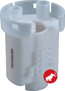

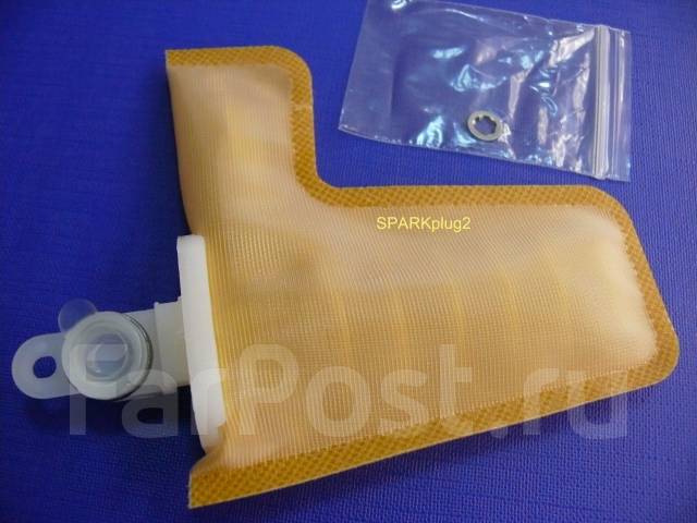

    I am looking for a fuel filter for a toyota yaris 1.0 16v 2003 (after lift), vin number:
    VNKJV13380A1999916
    The fuel filter is in the tank, unfortunately the replacement No. JPN30F2047JPN does not match.
    I send pictures attached.

  • #5 16994633
    Eidems
    Posts: 2115
    Help: 83
    Rate: 253
    I bought one but it doesn't fit and I am looking for the correct one.

  • #7 16994702
    Eidems
    Posts: 2115
    Help: 83
    Rate: 253
    mtd wrote:
    And this is the only one in catalogs after this car.
    I am not interested in the general catalog because it is followed by a thousand not matching items ...., I have given the VIN, and I need the correct one, the catalog is followed by ADT32373 and ADT32360 but they look similar and are rather not correct.
  • #8 16994747
    andrzej20001
    Posts: 17829
    Help: 1578
    Rate: 6669
    This is not a filter to protect the injectors.

  • #10 16994925
    andrzej20001
    Posts: 17829
    Help: 1578
    Rate: 6669
    Pump filter. Disposable filters are in the nozzles themselves. Generally, a maintenance-free disposable system like most. Full fuel pump is installed
  • #12 16995084
    Eidems
    Posts: 2115
    Help: 83
    Rate: 253
    bandi21 wrote:
    http://japancars.ru/index.php?route=catalog/toyota&mdf_id=8690&area=EU&cat=116510&blk_id=7701
    The ori catalog says it's a complete set with a pump. Replacements don't have to match.
    The car is made in French, there is no fuel filter here, the replacements match the Japanese version, the whole riddle has been solved. Well, we won't do anything, thank you for your help ;)
