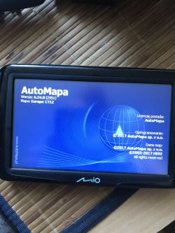

    As in the subject, I do not know how to upload automape on mio spirit 670, I'm completely green in this, please help.

    You must first unlock the device - you had to unlock this model on the electrode - just search.

    I have unlocked, i.e. I have a map selection menu. Nwm is this unlocking, I don't know. I have it on the screen all the time when I choose automape and nothing happens.
    Yes, it is possible to run something other than the factory navigation program
    Change the startup to start the wceAm.exe file (instead of automapa EU.exe). If it does not help - split the AM (folder with map on the SD card, program on the device).
    Of course, the AM startup script should be modified to run from internal memory.
    PS. How do you start Automapa? What do you have on the screen when you turn on the device?
    P.S2 AutoMapa is not a map - it is a navigation program (together with the map)

    You must change the name of the wcAm.exe file to Automapa EU.exe
