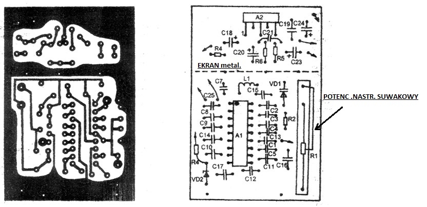

    I want to build an expandable fm radio.
    I am a beginner.
    I have the equipment.
    I remember something from school.
    I will do the housing myself
    I mean a radio, which may consist of several components, has a clear timbre and has a good reception of the wave.
    It can additionally have an equalizer, speaker power amplifier up to 25W.
    And not too expensive components.
    As if someone showed me what you need and diagrams to connect.
    I want to combine everything on universal plates before I learn to etch.
    Regards and thank you for your help.

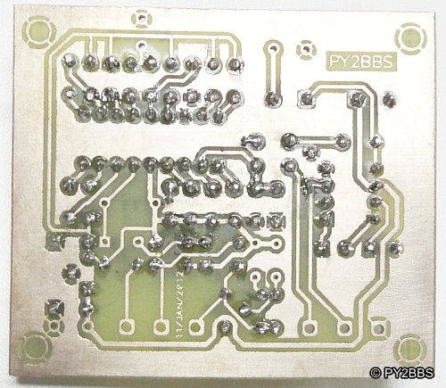

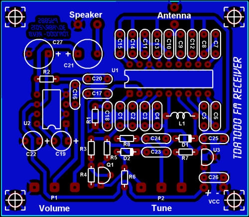

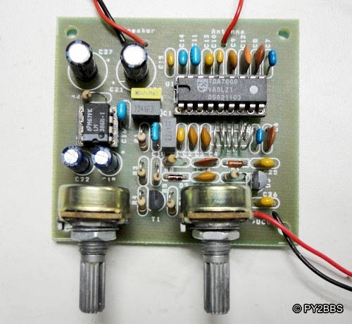

    #7 17197242
    aksakal
    Tube devices specialist
    Posts: 8948
    Help: 1669
    Rate: 3002
    And which description are you asking? Everything you need, even for a beginner, is in the diagram and photos! The only element for a self-made product - L1 coil - the parameters of which are indicated in the diagram.

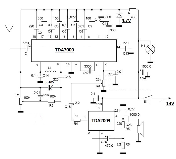

    Rate: 3002
    If you want to increase the output power to 4W - 4Om (8W-2Om) then use the US TDA2003 amplifier. The diagram of the radio is little different from the previous one. Beginner's Guide to Building an Expandable FM Radio: Components, Diagrams & 25W Amplifier Beginner's Guide to Building an Expandable FM Radio: Components, Diagrams & 25W Amplifier
