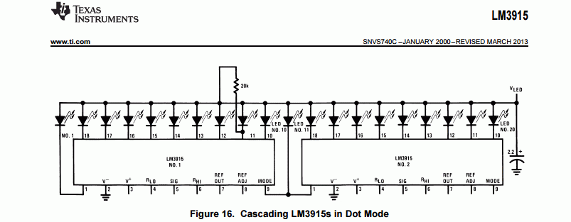

    Series connection of LM3915 chips. Just note that the display is not multiplexed, which is terribly wasteful. These layouts cost a bit.

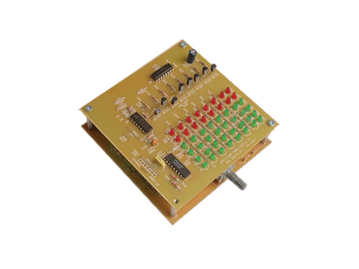

    Pitupiter
    From the AVT 2864 chip:
    Is it possible to replace the LEDs with 7 white and 3 blue ones, since their operating voltage is over 3v?
    if so :
    Do the values of the resistors change and what, can you leave the same, but you have to take into account that the diodes will, for example, "start later"?

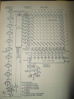

  • Examples of UL1980 and LM multiplex analyzers
    #12 19450864
    zybex
    Helpful for users
    Posts: 15919
    Help: 2094
    Rate: 2939

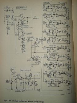

    I made my first analyzer on 20 UL1980 chips, 10 per channel. Red LEDs 220 pieces. The 20 extra ones were always on, i.e. even without music. I just added them. It was all housed in a large tower panel. A buyer was quickly found. The second analyzer is the multiplex analyzer from Praktyczny Elektronika (on LM) shown above. I made two plays as a stereo. I sold it without the housing.
    Here is another diagram in an old book (1986).
    DIY Acoustic Spectrum Analyzer: Schematics & Expansion for 10+ Lines, 40-LED Video Guide
  • Practical Electronics issues contain 10-channel analyzer circuit
