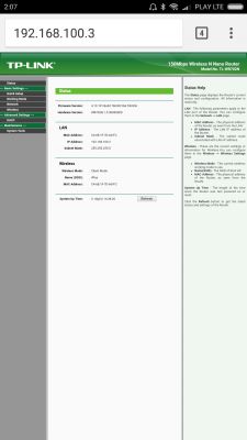

    Hello, I have a problem with my internet connection, the following message is displayed all the time: the website requires logging in. I suspect that someone has hacked into me and has login details. I cannot access the administrator data change page, although I have an IP number.
    I attach a screenshot to show what the website looks like after entering. I also do not have the software for this router loaded, it starts from the board with only the router manual but no drivers. Nevertheless, the router works and after entering the data from the router, the connection worked for several days. Now, unfortunately, the page appears as in the attachment. Besides, that, for example, I could use the connection for an hour. Unfortunately not now. The one who broke is probably using it.
    Please help.
    • Resetting and Securing TP-Link TL-WR702N Router: Addressing Unauthorized Access Issues zrzut.PNG (64.13 KB) You must be logged in to download this attachment.

    From the screen it looks like you are not logging in to your device.
    Link read about the configuration of your device.

    RP-N12 is a repeater, not a router. Go to cmd and enter ipconfig and show the result.

    cefaloid wrote:
    dr.master wrote:
    Reset the router to factory settings and configure again with the wizard.
    And what is that supposed to give? Can't you see that a friend is connecting to a completely different device ?
    Like a bull, the page you open is that of some other router, specifically the Asus RP-N12 router. It is as if someone was looking for the reason why they cannot log in to their account at the PKO bank, and in the screenshot there was the login page https://login.aliorbank.pl
    And you would then suggest resetting the password on the hotline ... Why and what would it give, if the problem is a bad bank login page?
    What you advised only destroyed the configuration that now needs to be done from scratch.
    I suggest logging in to your own router, not someone else's. It should have a page that looks like this:
    Now, after destroying the configuration with reset, you need to search for a wifi network with the name on the router's label (with tplink in the name), connect using the password from the label and open the page http://192.168.0.254 as the user admin with the password admin.
    There are settings. Further attempts to hack someone else's Asus router are pointless.
    If it is not able to find its router by address / name, how to get to it if not restoring factory settings?
    Factory reset and going to the router page clicks the wifi creation wizard does a new network and everything.
    Has a new network, knows the name, password, etc.
    I believe that this is the fastest and best solution after all ...

    The problem was not resolved. The router was replaced with an older one that works
