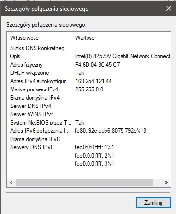

    I have a problem accessing the title router's configuration screen. I need to change its working mode from Router to Client and connect it to an existing WiFi network. I have already checked different versions of tips found on the internet but I still can't access the router.
    The router normally creates its own wifi network, but the "tplinkwifi.net" page does not respond, I can't get to the IP addresses, but I do not know what is correct, because I checked several versions of the Internet. I have changed the TCP / IPv4 settings
    Here ip config / all

    I do not know if you paid attention to what was in the spoiler, but during the test it was connected with a cable and via wifi ...
    I tested both forms of connection both separately and together, with the same poor effect.

    Erbit wrote:
    The address of your network card has not been assigned by the router. As a result, your network card and router are in a different class and therefore you cannot access it.
    In fact, your router is a gateway for your network card and you should look for it under this IP address (under the gateway address). As you can see the "gateway" is empty.
    How can this be fixed? Is it a matter of your router or computer settings?
    I will add that I did a 30-30-30 reset.

    Erbit wrote:
    The default IP addresses of the TL-WR802N have two: 192.168.0.254 for AP mode, Range
    Extender mode and Client mode, and 192.168.0.1 for Wireless Router mode and Hotspot Router
    mode. And the default Subnet Mask is 255.255.255.0. These values can be changed as you
    desire. In this guide, we use all the default values for description. Here we also take "192.168.0.254"
    as an example.
    It is true that the lack of DHCP suggests that you are right but .... I would set a static network card address to the same class (e.g. 192.168.0.2) and tried to call 192.168.0.1 and 192.168.0.254 on both ports, i.e. 80 and 8080.
    I would do it on both network adapters (WiFi, LAN) with only WiFi connected or only LAN (configuring the IP for both adapters).
    It helped :) It turns out that the router has off. DHCP: / After setting the static address for wifi TCP / IPv4 as you specified, i.e. 192.168.0.2 and calling 192.168.0.254, the configuration page fired up :)
    I hope this will help others :)

    3h setup attempts and success! :P Thanks for the advice, I don't know if I'd figure it out myself. :)
