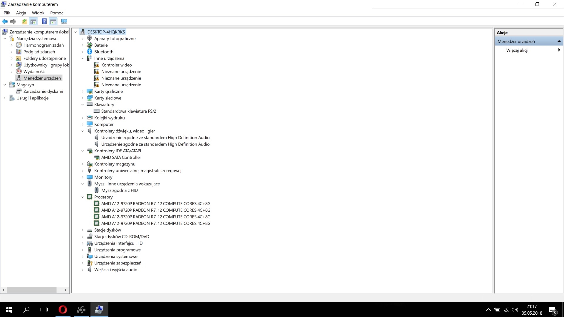

    Hello, the girl bought a new laptop from lenovo. I installed win10 and the touchpad does not work, I tried to push fn + f6, I was looking for synaptic touchpad drivers, supposed to be installed but I still can't see it in the hardware manager ....
    80xs board model
    AMD chipset
    x64 system
    I have heard that win7 has problems with detectors, but win 10?

    Hello. Post screen from Device Manager?
  • #3 17205172
    Jachu171
    Posts: 55
    Rate: 31
    Lenovo 15 ABR 320 - Win10 Touchpad Issue: Synaptic Drivers, FN+F6, AMD Chipset, 80XS Model
    Please, here is the screen.

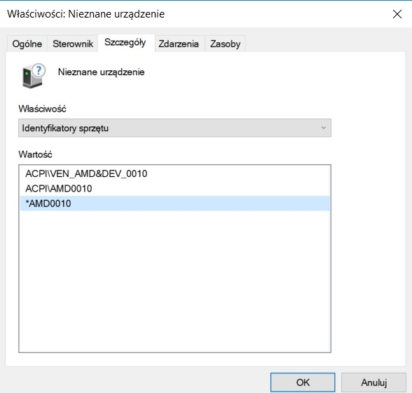

    Provide identifiers for these drivers with an exclamation mark.
  • #5 17205206
    Jachu171
    Posts: 55
    Rate: 31
    Lenovo 15 ABR 320 - Win10 Touchpad Issue: Synaptic Drivers, FN+F6, AMD Chipset, 80XS Model Lenovo 15 ABR 320 - Win10 Touchpad Issue: Synaptic Drivers, FN+F6, AMD Chipset, 80XS Model

    Type normally by hand or by copy and paste. Paste these IDs into your browser and you will find all the drivers you are missing. Here is an example of how to do it. https://www.elektroda.pl/rtvforum/topic1228905.html

    First remove this installed something. Is in Programs and functions is not for this version of the system. And do you have any driver not yet installed or not recognized in the Device Manager?
  • #9 17206474
    Jachu171
    Posts: 55
    Rate: 31
    Hello. Already overtaken. The touchpad works flawlessly, it helped to install all missing drivers
