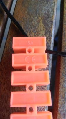

    Hello. I do not know if I am writing in the right place, but I have a question for people who know electricity because I am concerned about a certain problem. I was renovating the kitchen and the arrangement of household appliances changed, so my father-in-law started to move the sockets for the dishwasher, oven and refrigerator to me. So I have a question because I used a 400V terminal block, six amps but a 10 amp load. Will this cube burn? Shouldn't there be a higher load capacity? Please reply.

    Rate: 204
    He did it poorly. It all depends on the total power of household appliances

    Posts: 345

    The cables themselves should be checked in advance if they have at least 2.5 mm2. If it is 1.5 mm - to the oven itself, however, I encourage you to replace the wires. You can rather let go of the refrigerator and dishwasher, but I would verify the power of the dishwasher - a 1.5 mm cable should have a 10A fuse, i.e. up to 2.2 kW in practice.
  • #4 17208301
    Adula1
    Posts: 20

    Ie. used a six terminal block but its load capacity is 10 amps, the oven supports 3.6kw, will it hold up?

    The oven draws 3.60 kW and used a cube of six but 10 amps

    No, he won't. The current carrying capacity of this strip should not be less than 16 A.

    The connector will heat up under high current load for a long time. The contacts will loosen and burn out over time. As a result, the cube will melt like plasticine and the conductive elements will shorten, triggering the protection. It could happen in two months or maybe in two years. At best, only this part of the installation will suffer. If something sticks to the wall permanently, you need to connect it firmly.
    I wonder, where did you read the load capacity of this strip? And everyone thoughtlessly picked up the topic and are discussing.
    Upload a photo, I will believe it, but I bet that the strip is 400V and has an acceptable cross-section of 6mm2, not a current of 6A.
    The smallest strip, e.g. a 2.5mm2 simet, has a load capacity of 24A! And 6mm2 has a load capacity of 41A, so each of them is theoretically suitable for an oven, but I personally link in such strips always "overlap", i.e. two wires overlap each other so as to were always tightened by 2 screws. And this forces the use of larger listers 6, 10 or 16mm2, depending on the cross-section of the conductor.

    The cross-section is 6mm , a current 10 and mper that :

    I ask again: where did you read the 10A? If this is the "cube" of the simet I wrote about, then 6mm2 has a rated current of 41A.
    https://www.elektrykasklep.pl/towar/21412108-...MIivDbtr712gIVUEkZCh2-2w0nEAQYASABEgL8JfD_BwE
    This is not a Simet cube. I have the last one here, but on the back of the back it has 10A written on it.

    It is not so much about the amps, but about the surface of the guaranteed contact of the connected wires and the fact that such a connection can "release" on the thread. The bigger cube has only a bigger opening and is made of the same material, so it won't significantly improve the surface. If the wires were twisted and insulated together, it could be without a cube at all.
    I ignore other issues, i.e. the quality of the ankle itself and the possibility of damaging the cord during forceful tightening. If the wires were not twisted together, or at least threaded through the ankle for the passage, I would not sleep well.

    It will get hot / ignite sooner than the protection will work. Sparking from an insecure connection can damage the equipment. Re-examination is necessary and performed by a specialist.

    I took the 10 'strip, 15A current from the anlux manufacturer, so 6' can have 10A
    http://www.anlux.pl/a_zdp-10.0.html

    Exactly the same strip, only 6mm and 10A

    These strips are useless, easily break the thread with light pressure, the screws fall out when they are completely unscrewed, the body deforms when the screw is slightly tightened.
    And where is the meaning of 6mm2 cable connections, but with a permissible current of 16 or 10A?

What connector rating should I choose for appliances above 3 kW?
Select screw or lever blocks rated at least 16 A continuous, 400 V insulation, and sized for the cable cross-section [Elektroda, kSmuk, post #17208424]
Which cable cross-section is recommended for an electric oven?
Use 2.5 mm² Cu minimum. It carries 24 A in walls, leaving headroom and complying with PN-HD 60364-5-52 limits [PN-HD 60364-5-52].
Will my 10 A breaker protect an undersized terminal from heating?
Unlikely. A loose joint can glow at 5–8 A without tripping a 10 A breaker, yet still reach ignition temperature [FireLab, 2022].
What signs indicate a loose or overheating screw connector?
Warm wall surface, plastic discoloration, or intermittent appliance shutdowns signal trouble. 70 % of kitchen-electrical fires start at loose joints [PSP Report 2021].
What is the safest way to extend hidden kitchen wiring?
  1. Expose junction box. 2. Join wires with 16 A+ lever blocks or solder and heat-shrink. 3. Re-bury only after pull-test and insulation check [Elektroda, zybex, post #17209651]
