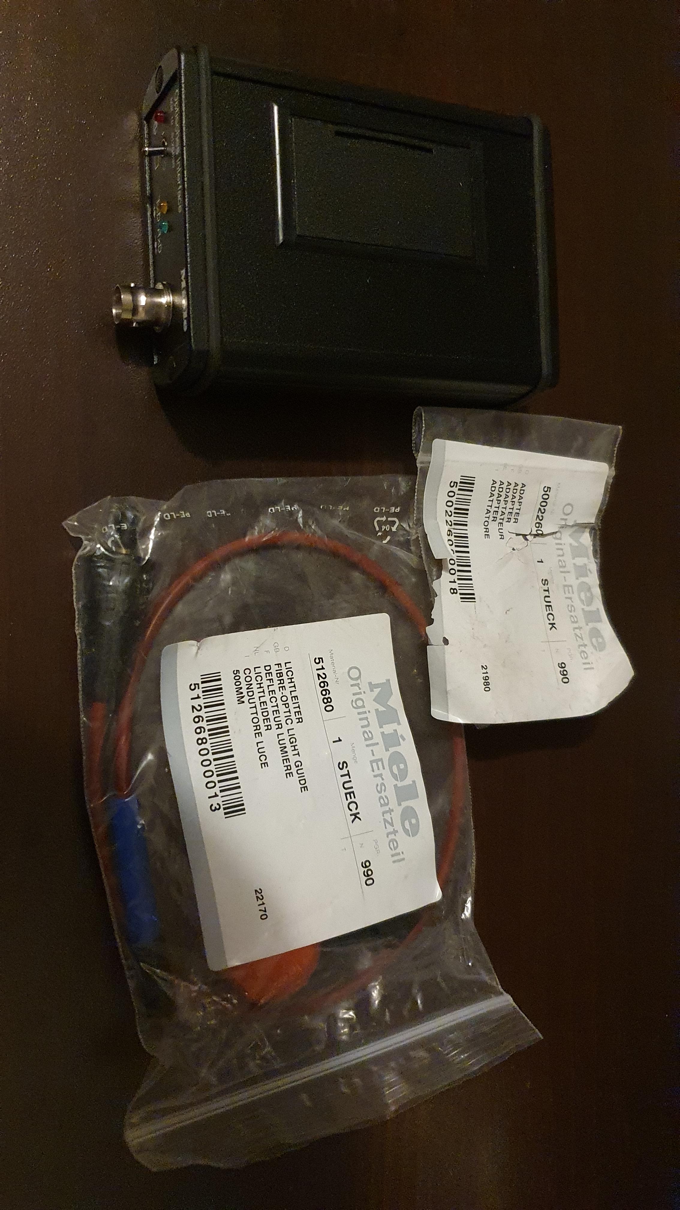

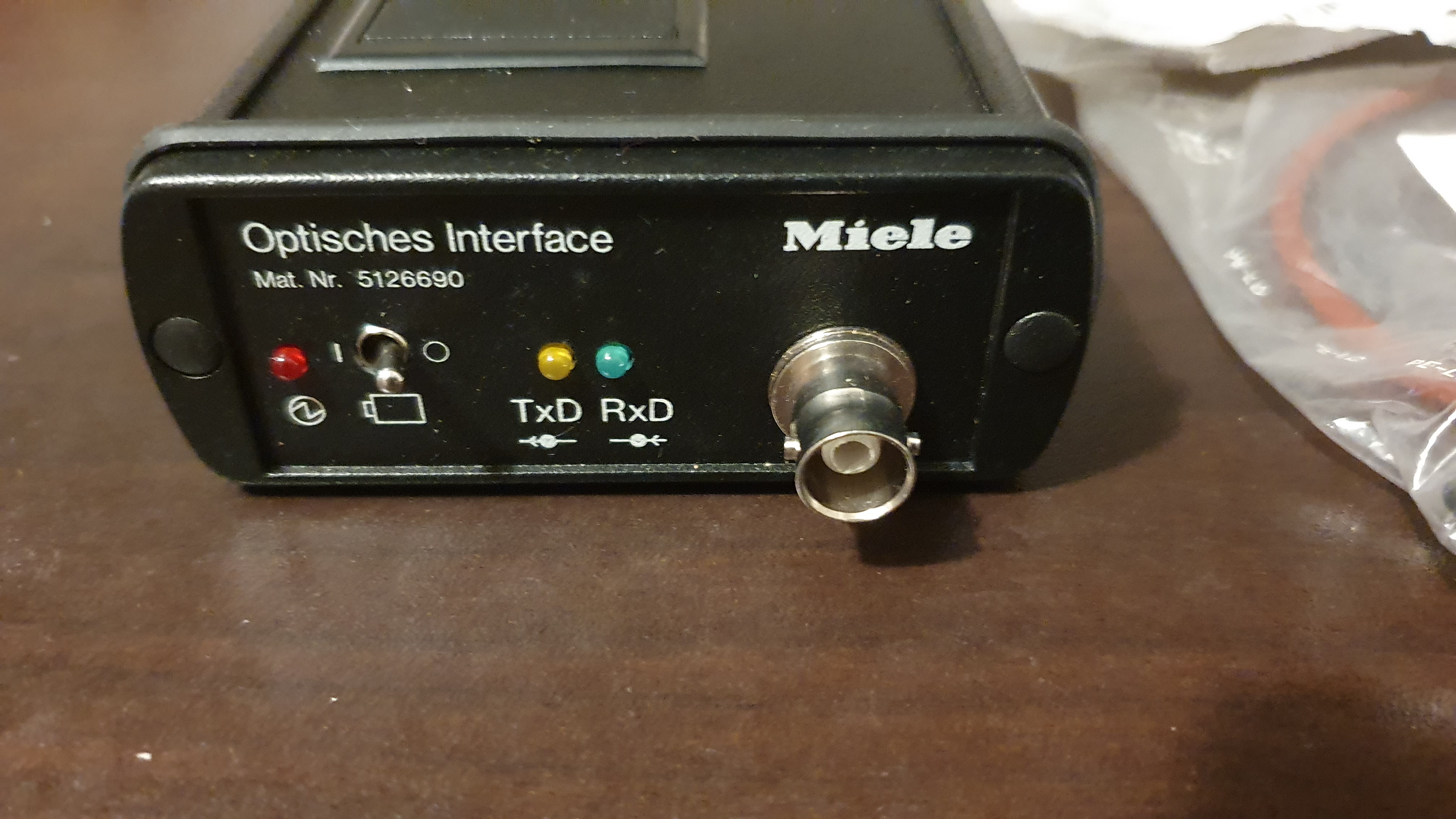

    Tadek_76
    I dug it out today, if anyone wants it, I have it, write a PM, I'll get an e-mail, I'm not here every day :D
    • [Looking to Purchase] Miele Optical Interface and Software for Device Connectivity 20230106_173606.jpg (1.04 MB) You must be logged in to download this attachment.
    • [Looking to Purchase] Miele Optical Interface and Software for Device Connectivity 20230106_173610.jpg (2.33 MB) You must be logged in to download this attachment.

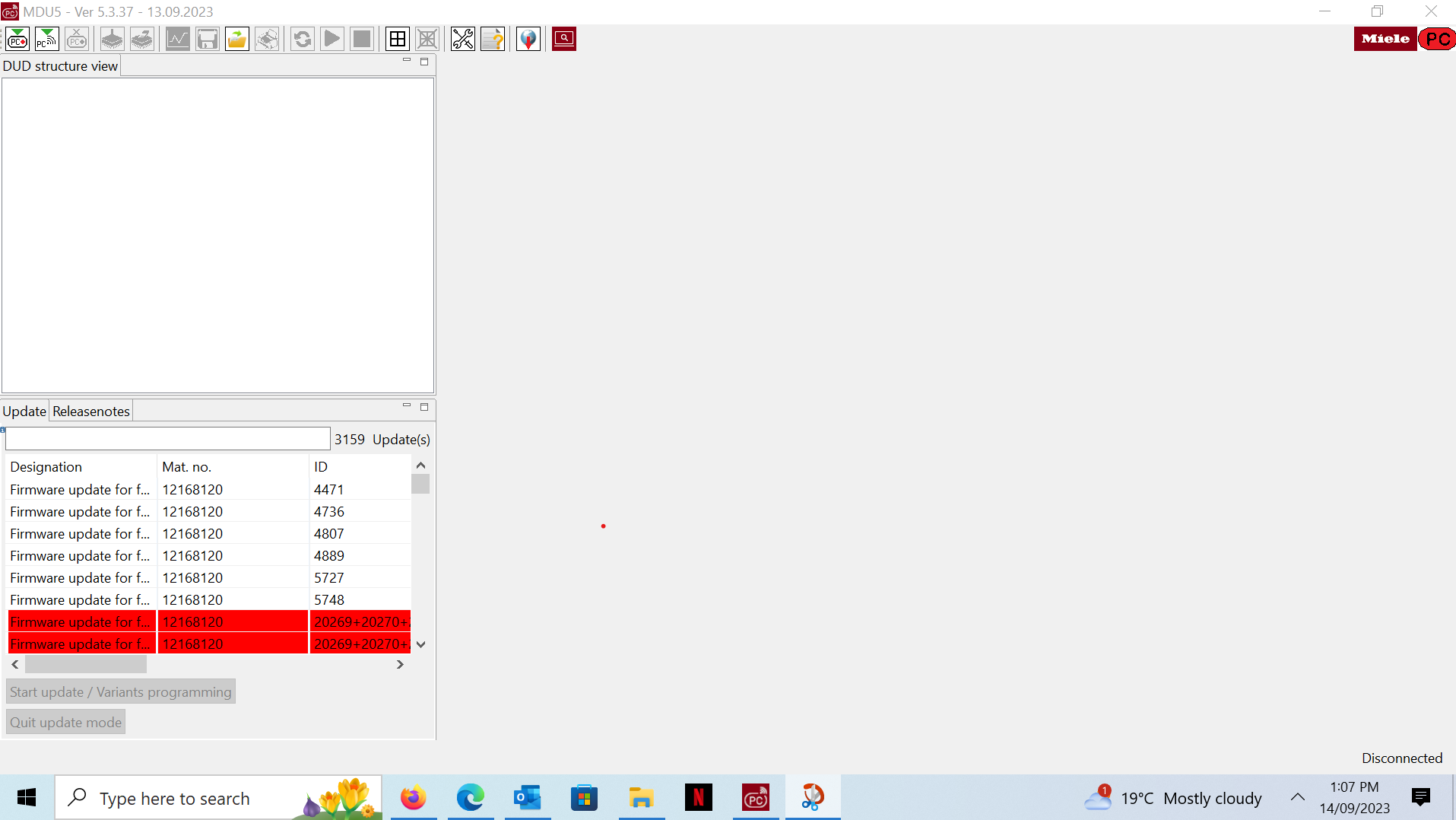

  • Miele MDUs require service partner access
    #16 20732488
    AllstarAppSvc
    Level 4  
    FYI, these MDUs are basically locked without the software. The only way to be able to utilize them is to have access to Miele service. In other words, you need to apply to become a service partner. Once you are in the circle, you can do a lot with them, including programming software onto bricked boards and updating software, all via a laptop and internet connection.
    #17 20733032
    abuhamza
    Home appliances specialist
    Posts: 2744
    Help: 383
    Rate: 1032
    AllstarAppSvc wrote:
    FYI These MDUs are basically locked without software, the only way to be able to use them is to access Miele service, as in applying for service partner status, when you are in the circle, you can do a lot with them, including programming the software on the brick boards and updating the software via your laptop and Internet connection.
    Screenshot of MDU software
    Screenshot of the Miele MDUS software interface for firmware updates.
    For dog money, it doesn't pay to waffle miele service in exchange for an interface.
  • Miele MDUs are useless without proprietary software
    #18 20733796
    AllstarAppSvc
    Level 4  
    The MDUs are helpful, though I'm not sure how Miele service is in your country. But in my country, they are good to deal with. If you work on their appliances, it's a must-have. It takes all the guesswork out of diagnosing faults most of the time, without even opening the appliance, as you can see everything the control board sees. So, without the proprietary software, which must be kept up to date or it will stop working after X amount of days, they are completely useless to anyone who doesn't have access. If this is the case, I would not buy one that's floating around the internet.
