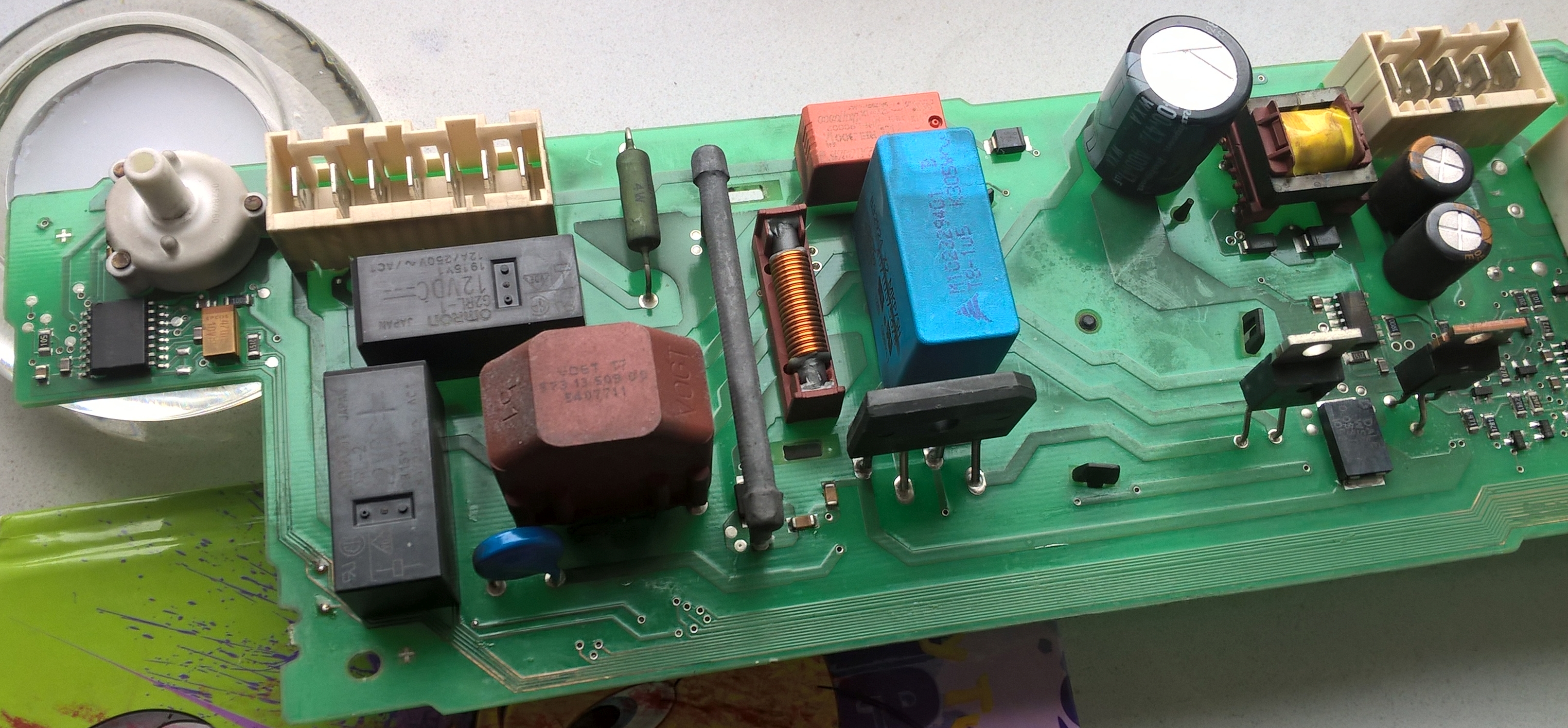

    Miele Softtronic W2241 washing machine - after the last wash (everything ok), I wanted to do the laundry again, wanting to turn on the washing machine, there was no reaction, as if the washing machine was not receiving power at all, the only thing I could do was remove the top and check if the electricity reaches the first receiver it meets on its way, and that's where it comes and I don't know it anymore. :) maybe someone, something, somewhere? I would be grateful.

    However, this is not an anti-interference filter, a man who knows himself said that everything is ok there. Probably the programmer is sitting, and here you need electronics or a washing machine for scrap, which is a pity because it was good.

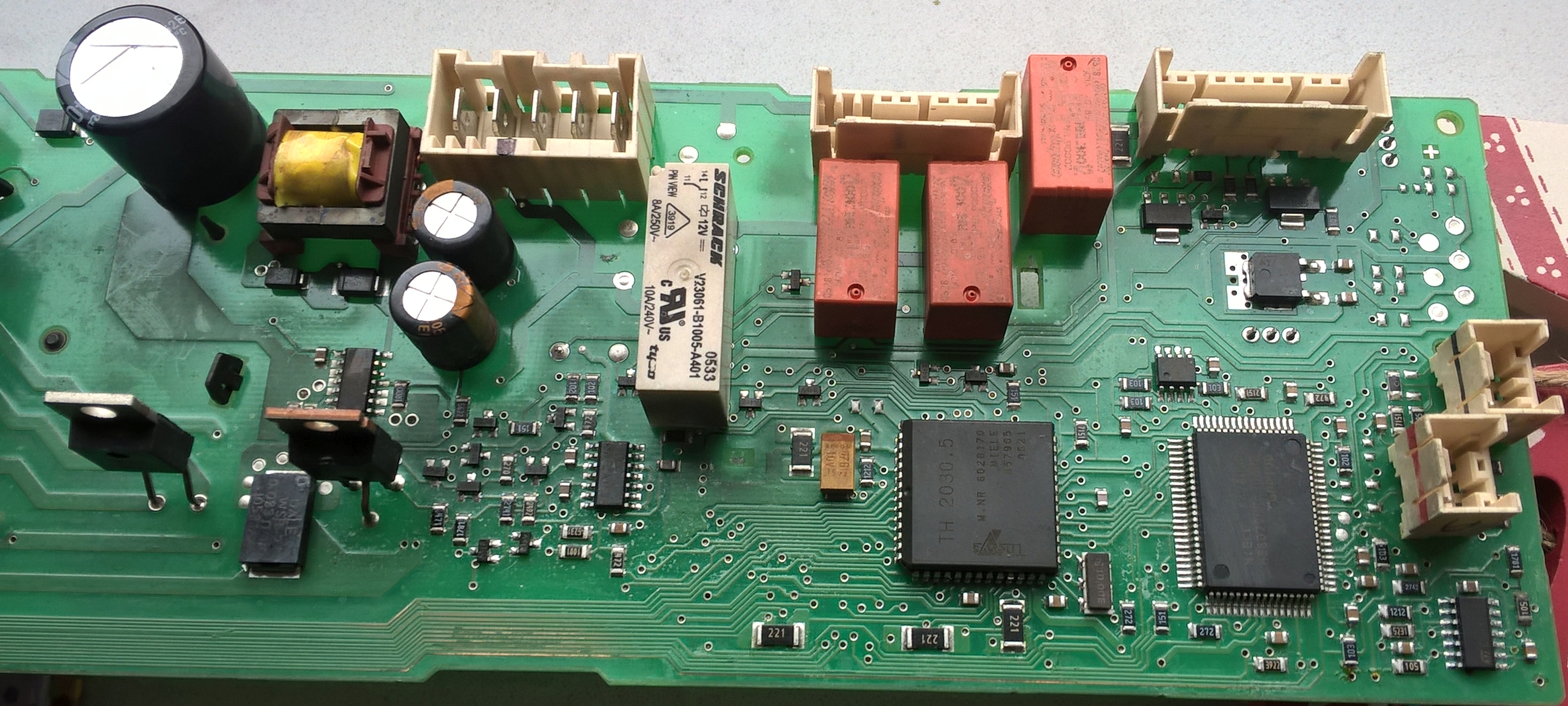

    So give a few pics for both sides of the Driver Board (PCB) and maybe it won't be too bad :D

    Tile photos:

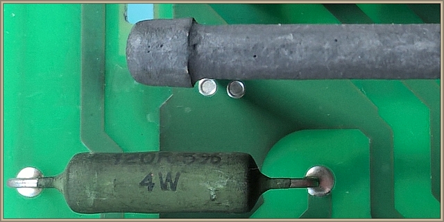

    #7 16365699
    TONI_2003
    Moderator
    Posts: 15334
    Help: 2195
    Rate: 3826
    This is true, I marked it (not everything) because the photos are too weak and dusty for that, but many paths show signs of damage (overheating or maybe even burnout). Added to this is the integrated circuit, the one marked with a red frame, and I don't know what's writing on it (can you read it or take a photo?) ...

    #9 16367785
    TONI_2003
    Moderator
    Posts: 15334
    Help: 2195
    Rate: 3826
    Miele W2241 washing machine - complete lack of response to the power supply
    The TEA1522T chip has a lot of malfunctions at Miele where it occurs, but they are usually visible. So all these paths of their inverter vias or the CPU power supply to check and these resistors below. Without a good specialist, it will not be possible (unfortunately) :cry:
