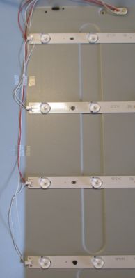

    I have enough of a "heavy" TP board. MSD309.BP85 - generally it is a Blaupunkt Bla-40 / 133L-WB-5B2-FHBKU_EU TV with LSC400HM06 matrix. On the TV everything works, except for the matrix's backlight (there is sound, the matrix displays the image, etc.).
    I got used to the backlight, giving +/- 25V for each of the four LED strips. Two of them did not shine, so, going one by one, came the exchange of a total of three pieces.
    Currently, when giving 25V for each strip, all the LEDs light up, so it should be OK - unfortunately, virtually no improvement, while switching on, there is still no backlight. The board has two separate sockets for leds, STBy is 35V, and when switched on it jumps at about 90V and after a while drops to 35V - as far as I know, this is typical for backlight damage, which I fixed, although I know that it would be appropriate to provide external voltage probably 60V to check if they ignite in a set (60V for two stripes) - unfortunately I do not have too much to organize such a voltage, I would like someone to give me an idea for external power supply, and generally for the repair of this TV.

    And the slats are connected in what way? There are sometimes breaks at the joints.

    At the junctions everything looks fine, I think it would be good to give 60V for one and the other plug to check whether both pairs will ignite, only the maximum voltage I have is 30V, I wonder where and how to organize such a voltage.

    chek all led

    Something like this, I have one with volt and amper display, additionally led current change.

    wentyl215 wrote:
    Currently giving 25V for each bar all LEDs are on fire so it should already be OK
    Together or separately they will shine from an external power supply, even if you find one on 100V. You have damaged the other LEDs, or at least one (with an efficient driver and connections). To find a damaged diode, supply each string separately with 25V and start gradually reducing the voltage. Diodes that will turn off or will be less shining than others should be replaced.

    It depends on how many diodes there is on the strip and on what voltage is the diode I usually check each separately for two sharp tweezers, connect the power supply and pierce lightly with the laminate in the pads or to check the whole strip I attach power supply from an HP full-size printer it has 32V 940mA and 16V 625mA and with a 32-inch backlight it's enough to light up all one strip.

    I have a similar problem with LEDs on Blaupunkt TV.
    I wanted to use "LED module 3 diodes at 12V" 8 pcs of such modules, that is 96V, but it does not work. :(
    When the TV starts up, about 100V diodes are flashing and that's all in the subject. 38V as much as on STB.
    Any ideas? Does the driver have to see any particular resistance?

    You disassemble the panel and you will see how many defective LEDs. I am trying to exchange for new ones. The possibility of corrections and re-disassembly of panel pozdr is minimized.

    kiko_tychy wrote:
    Does the driver need to see any particular resistance?
    The driver has to "see" a certain number of LEDs with specific parameters for a given backlight model.
