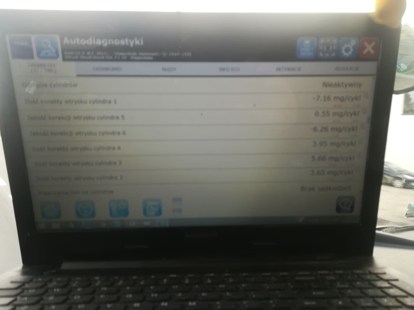

    I have a Man TGX tractor unit 6x4 EURO4 480 KM 2008.
    The problem is black smoke and lack of full power, when adding gas at a standstill, there is also a black cloud of smoke, which should not happen in E4.
    I will also add that the car once clogged the catalyst with soot so that it had to be flushed because the pressure in the exhaust system was increasing.

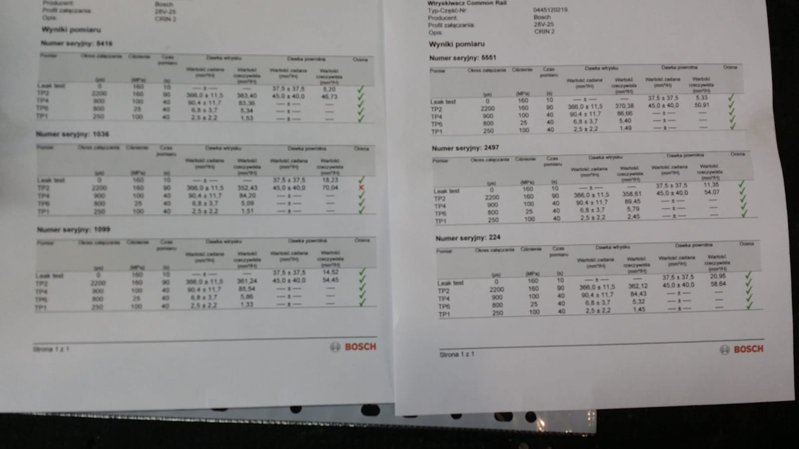

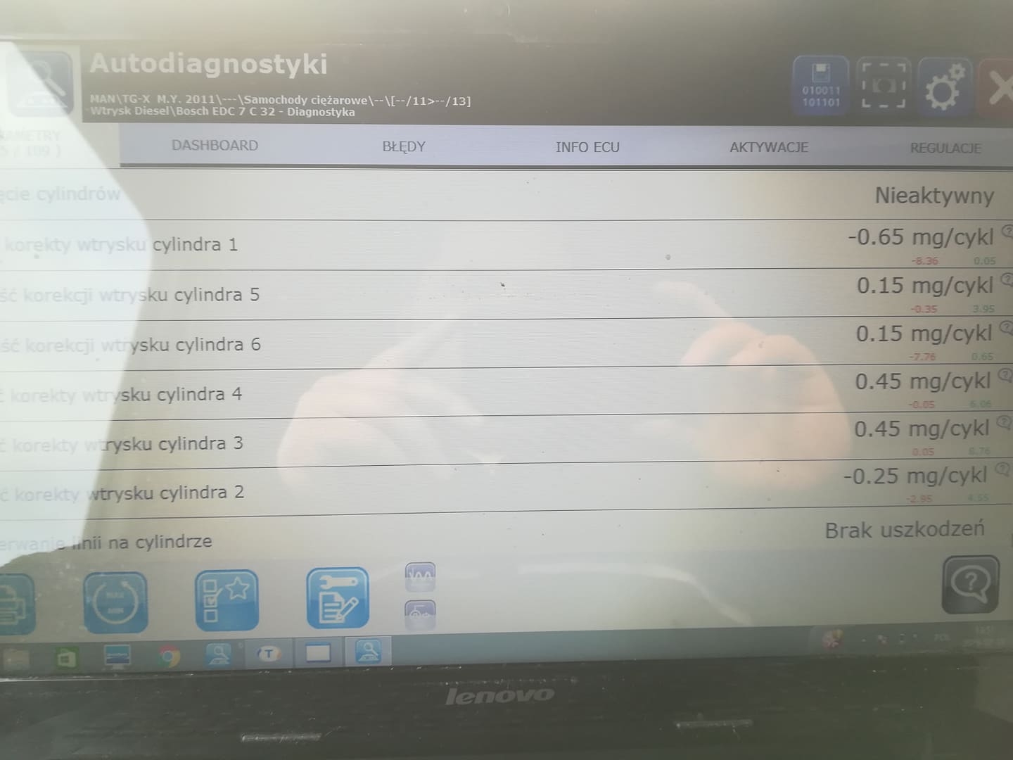

    The injectors were checked in the car (printouts attached), the air cooler (there was a small leak), turbo (minimal play), the boost sensor was replaced with a new original one, the entire exhaust gas recirculation was replaced and I also tried to plug it, but without changes.
    Turbo parameters are in the norm tz. the turbine in higher gears beats 2.9-3.1 BAR
    after that no errors on the computer.
    I am asking for any suggestions, what else can be checked or what parameters to look at?
    Personally, my feelings are towards the turbine, but I would not like to replace parts for PLN 3,000 blindly, so I am looking for advice on how to check it.

    The injectors were checked for overflows and tips, if the injection was too much fuel or poured, the overflow would not detect it.

    What color is this smoke evidently black as in the tdi pass or rather gray black?
    Because if you have everything checked, do the compression test - you can do man cats.
    The Turbo has been checked - from the entrance and exit sides, plus not only the hatch on the mountain that it moves, but does it not lock in the closed position?
    Do you have control of the Evb valve (mountain or there) in this engine? Are there any bugs after your repairs, e.g. ffr?
    There is always backlash on the turbine - it is compensated by oil - of course possible
    (play) to be compensated.

    I am writing this post because I have mana tgx 18.400 2012. Mileage equal to 500,000. Suddenly, overnight, it began to smoke terribly black when accelerating and a total lack of power ..
    I connected texe and unfortunately there are no errors. Adblue works.
    I took photos of injectors correction on a hot engine.
    Here at load.
    MAN TGX 480 (2008) 6x4 EURO4 - Black Smoke & Power Loss: Turbo, Injectors, Exhaust Issues
    Here at idle.
    Can someone tell me which injectors to replace?
    best regards
  • #13 17788954
    hubert04
    Level 25  
    Posts: 642
    Help: 60
    Rate: 408
    At least 2, i.e. 1 and 6
