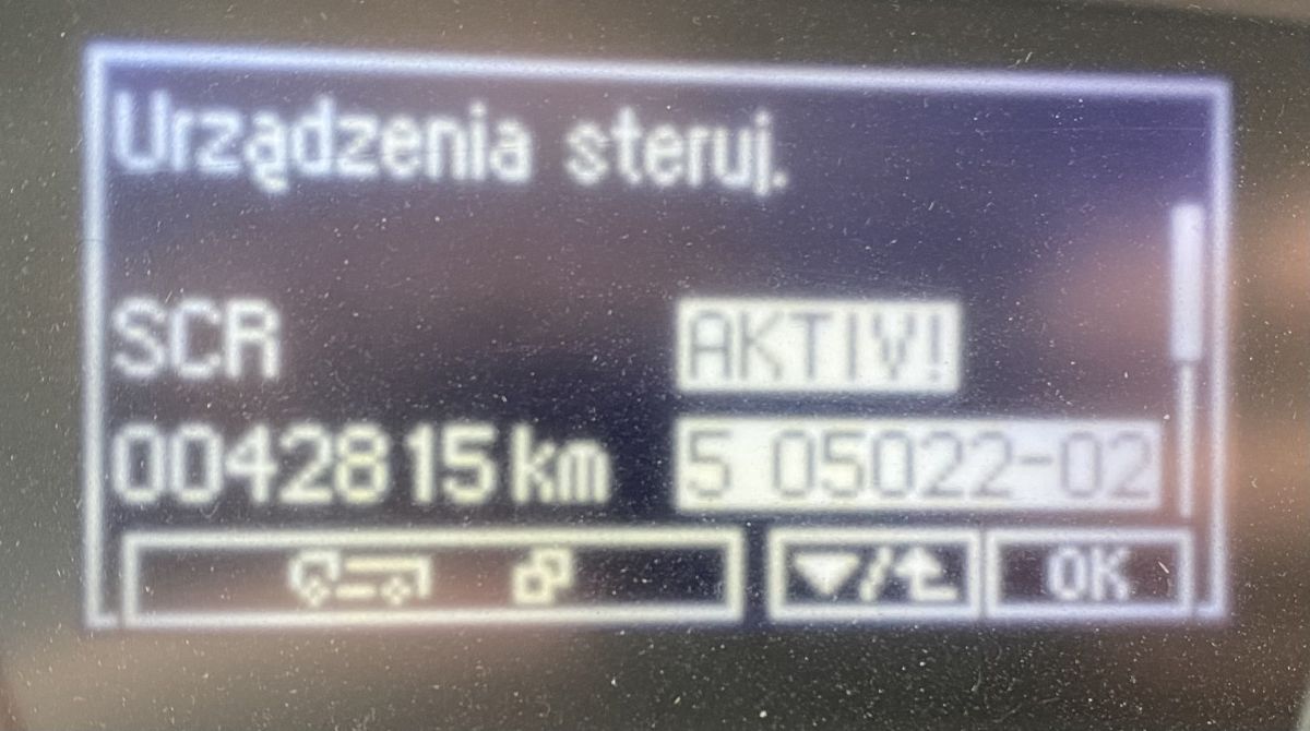

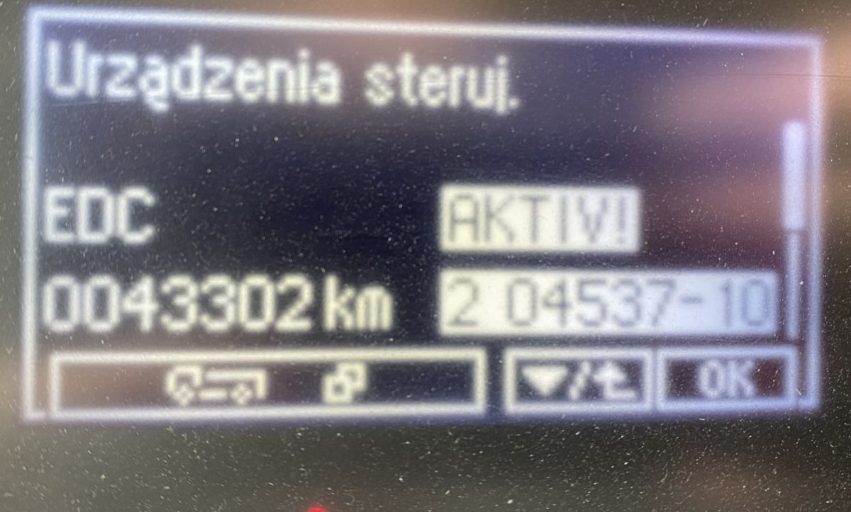

    MAn TGL 12-250
    The following error codes are similar to those of the author
    [img-0] [img-1] Man TGX 480 Euro 6: Adblue System Failure, Error Codes EDC 204547-02, SCR 505022-01 & More Man TGX 480 Euro 6: Adblue System Failure, Error Codes EDC 204547-02, SCR 505022-01 & More Man TGX 480 Euro 6: Adblue System Failure, Error Codes EDC 204547-02, SCR 505022-01 & More

    Oh well. I think on Monday I will start cleaning the adblue dosing system
  • #15 20267839
    TruckElectronica
    Posts: 495
    Help: 73
    Rate: 275
    what do you want to clean there? like the faults you gave about the electrics ...
