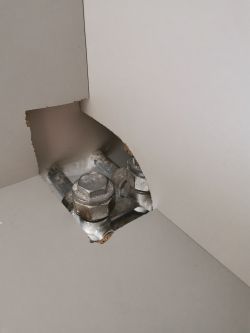

    Good morning,
    Nowhere can I find such a heater and instructions on how to remove it, so I am sorry if it was already somewhere.
    I would like to make sure that to remove the radiator with the connection as in the picture, all I need to do is turn the two flat screws and I can easily unscrew the nuts above?
    Are these screws valves? Do I have to turn the water off somewhere else?
    Is it enough to unscrew these screws and bleed the radiator after reinstalling them? (apartment in a block of flats, new)
    Procedure for Removing Radiator with Underneath Connection: Valve Operation and Bleeding
    Thank you for your help.

    These pins for a flat screwdriver are shut off valves. Set them horizontally, which cuts the radiator away from the installation. At the other end, put a bowl under the cork at the bottom of the radiator, cover the wall. Slowly unscrew the cap until it is unscrewed, water will start flowing out. Unscrew the breather in the upper plug (key for 3 bad not a screwdriver!). After the water flows out, close the cap at the bottom, screw the vent on top. put a rag under the valves at the bottom, unscrew both nipples (they are at the valves so when viewed from above according to the directions) something else will flow onto the rag (and this is a slush with low oxidized iron so black and dirty). Lift this side of the radiator up so as not to splash the apartment. Make yours. Put on the heater logical rest.

    Everything as described by a colleague @ Szczecin62 only the vent should be unscrewed first to check if the valves are holding :D
