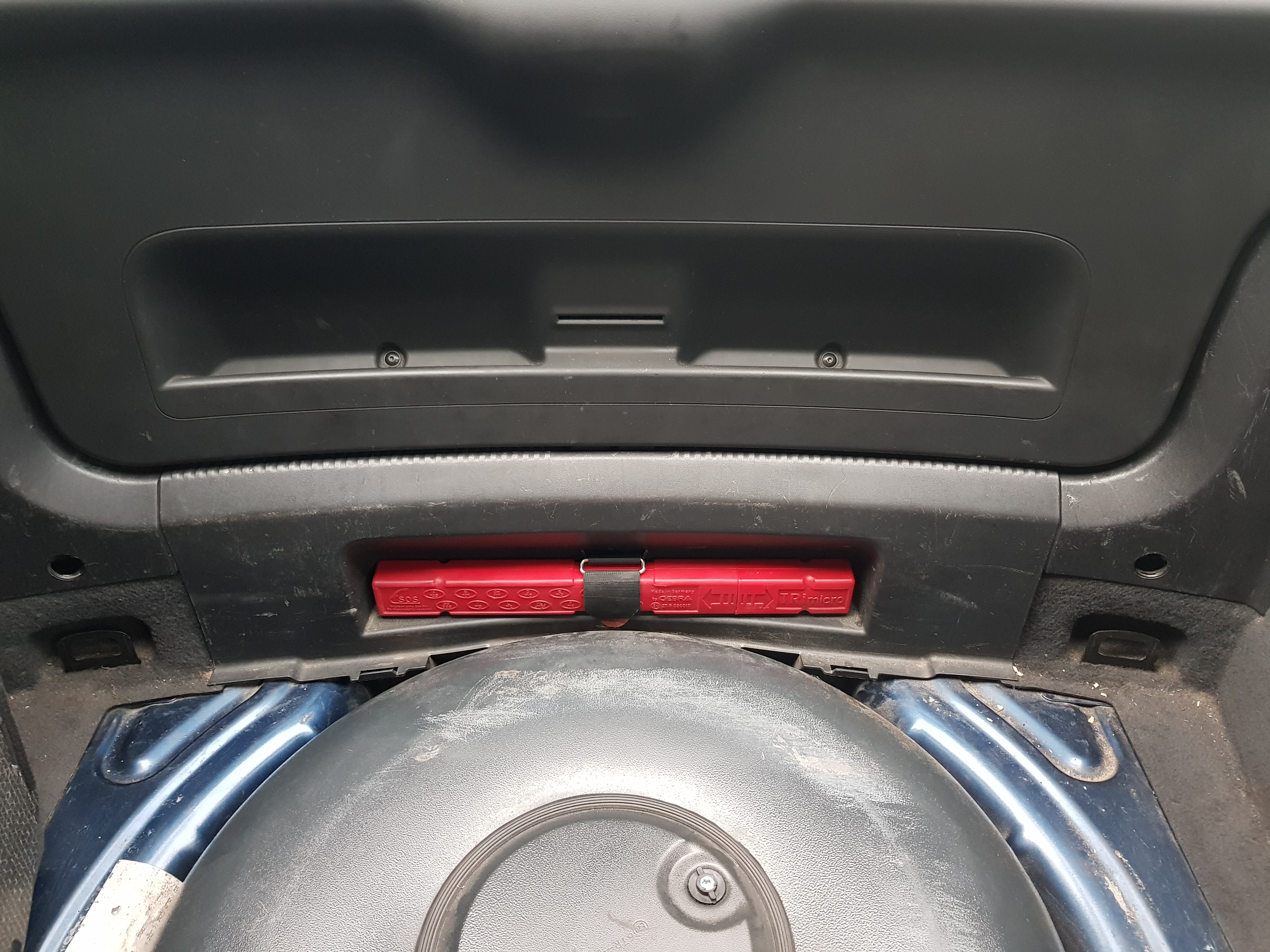

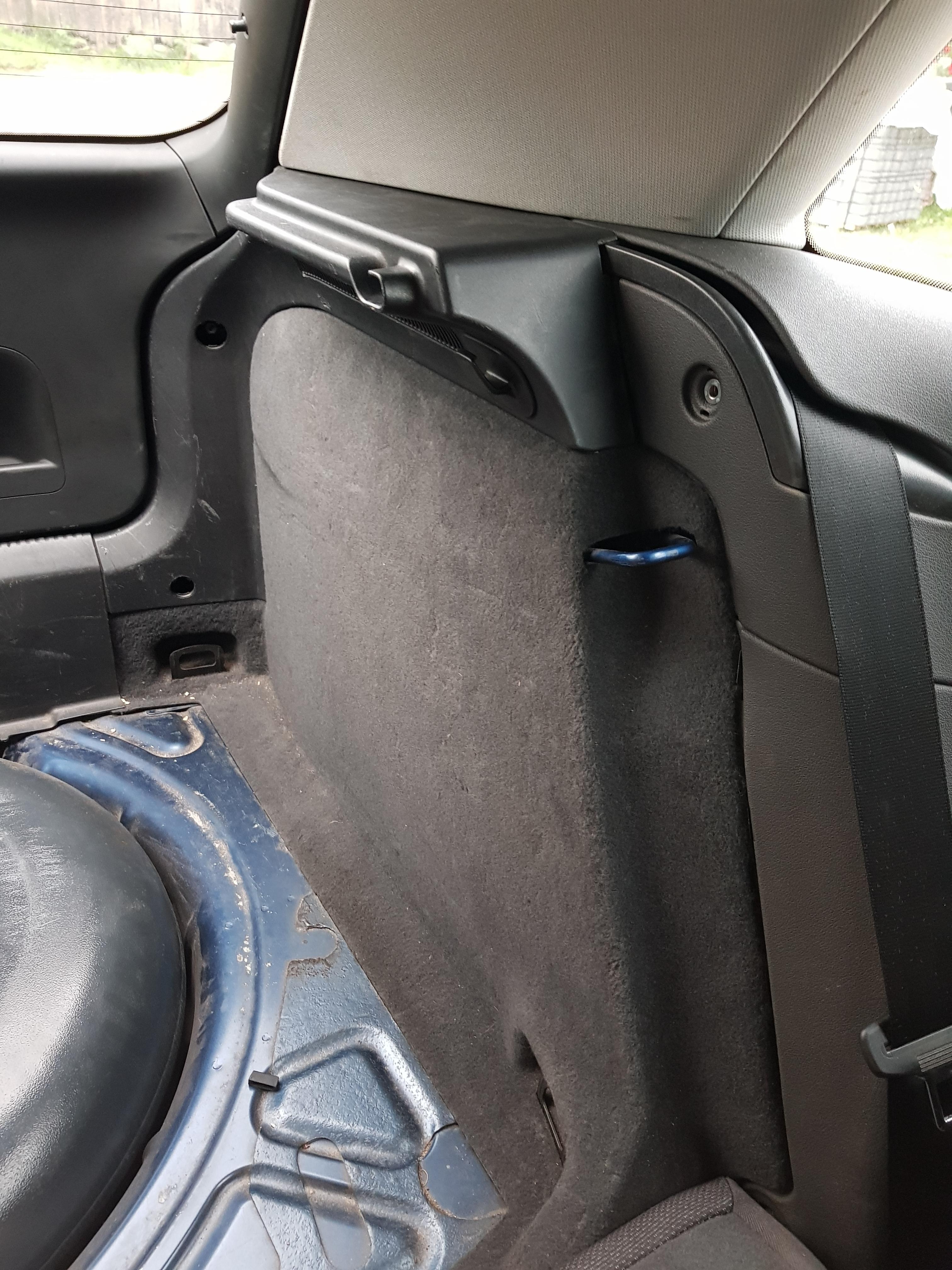

    Hello, there is such a situation that I want to get to the subwoofer located at the back in the trunk. I searched various forums but nowhere did I find a solution for my Audi because there is nowhere such a diagram as I have (no screw on top, nowhere).

    start by removing the flap seal, tear off the rear post, the rest are on dovetails and pull out too. Unscrew the holders for securing the luggage at the bottom, it may turn out that you will need to remove the upholstery under the rear window first, left side of the couch
    pull out = pry pull etc.
