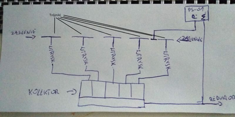

Can I connect the AC PS-01 map sensor anywhere in the gas line after replacing the reducer with a KME Gold and fitting Barracuda injectors?
Yes — with a two-sided reducer supply, the pressure is the same throughout the system, so you can connect the PS-01 wherever it is convenient in the line [#17260357] The PS-01 should be mounted in the brass tee together with the gas-pressure outlet and gas-temperature sensor, so use the original/compatible STAG tee rather than an improvised one with a narrowed passage [#17261508][#17263458]

    Hello. I have LPG installations in my V70 II. When I bought it, it was already in a tragic condition. First, I replaced the reducer with KME Gold. Now he wants to replace the injectors. And here comes the question. I currently have OMVL and they are not kneeling. I bought a Barracuda and I wonder where to connect the AC PS-01 map sensor now. Currently I have pinned in as in the first photo. If I connect it now like in my drawing, will it be okay? The power supply is from two sides because I have a reducer with this possibility, so I use it. Connecting AC PS-01 Map Sensor in V70 II with KME Gold Reducer and Barracuda Injectors

    barteksmrek
    Level 28  
    Posts: 1309
    Help: 89
    Rate: 224
    The supply is two-sided, the pressure should be the same throughout the system. In my opinion you can.
  • #3 17261508
    psooya
    Posts: 5344
    Help: 376
    Rate: 575
    You can plug in freely, and where is the gas temperature sensor? to PS01 is a brass tee with gas pressure outlet and temperature sensor ...

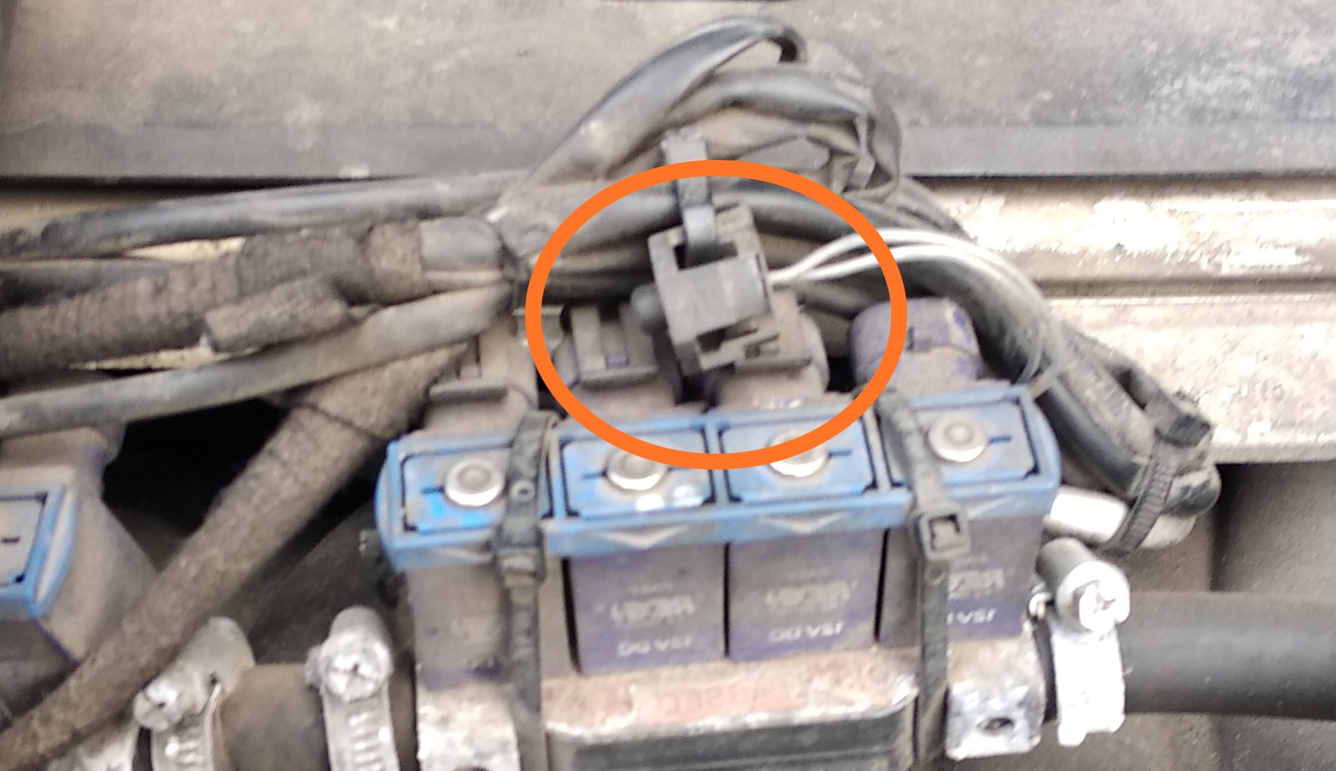

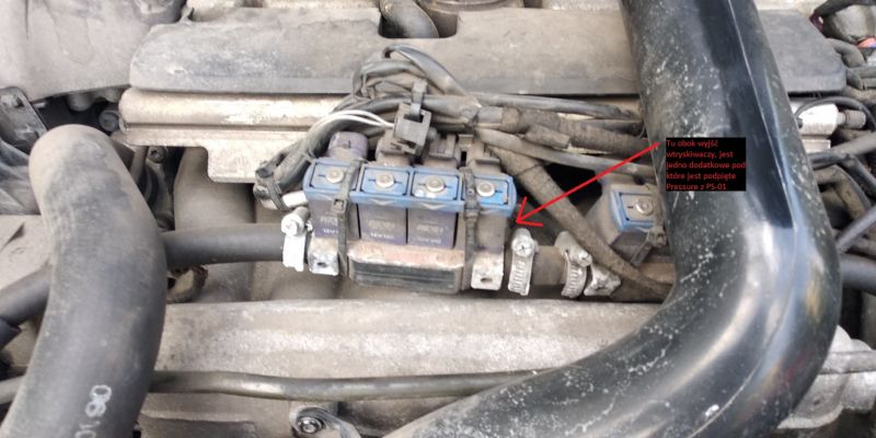

    Currently, I do not see a tee with such a sensor. But I wonder if these could be sensors? (Picture). At both injectors (I have two of them) there is something with a cable, they are connected to something. Are these sensors? When replacing, cut it off and connect the new one I have to tees (4.7k)

    #5 17263458
    psooya
    Posts: 5344
    Help: 376
    Rate: 575
    BUHAHAHAHAHAHAHAHAHA - sorry. Yes, it is and it is not authorized to stag because this sensor cannot be changed to another :-)
    https://www.phjacus.pl/T21-Czujnik-krociec-pomiarowy-p3266.html
    But buy the original not compatible some .....
    Regi at 40kkm is also a scrap ....
    Added after 4 [minutes]:
    https://www.phjacus.pl/T8-Czujnik-krociec-pomiarowy-22-kOhm-AC-STAG-p354.html
    It looks like the original
    It is also suitable to shorten the thread from the screw of the gas pressure measuring socket - the passage in the tee is unnecessarily narrowed.

    #6 17263523
    kielbi100
    Posts: 131
    Rate: 32
    Well, these Regi is nothing to regulate at all crap. As for this tee - thank you for the advice, tomorrow I'm going to replace it with the original. Well, as you can see in the photo there is a terrible upgrade, but slowly and it will be nice and solid :)
