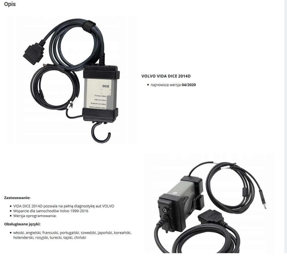

    I dug around in VIDA and found an option to reset any module.
    SOFTWARE->ADVANCED-> select the module, then press SEND PROG and SEND RESET.
    Regards
    GREGOR

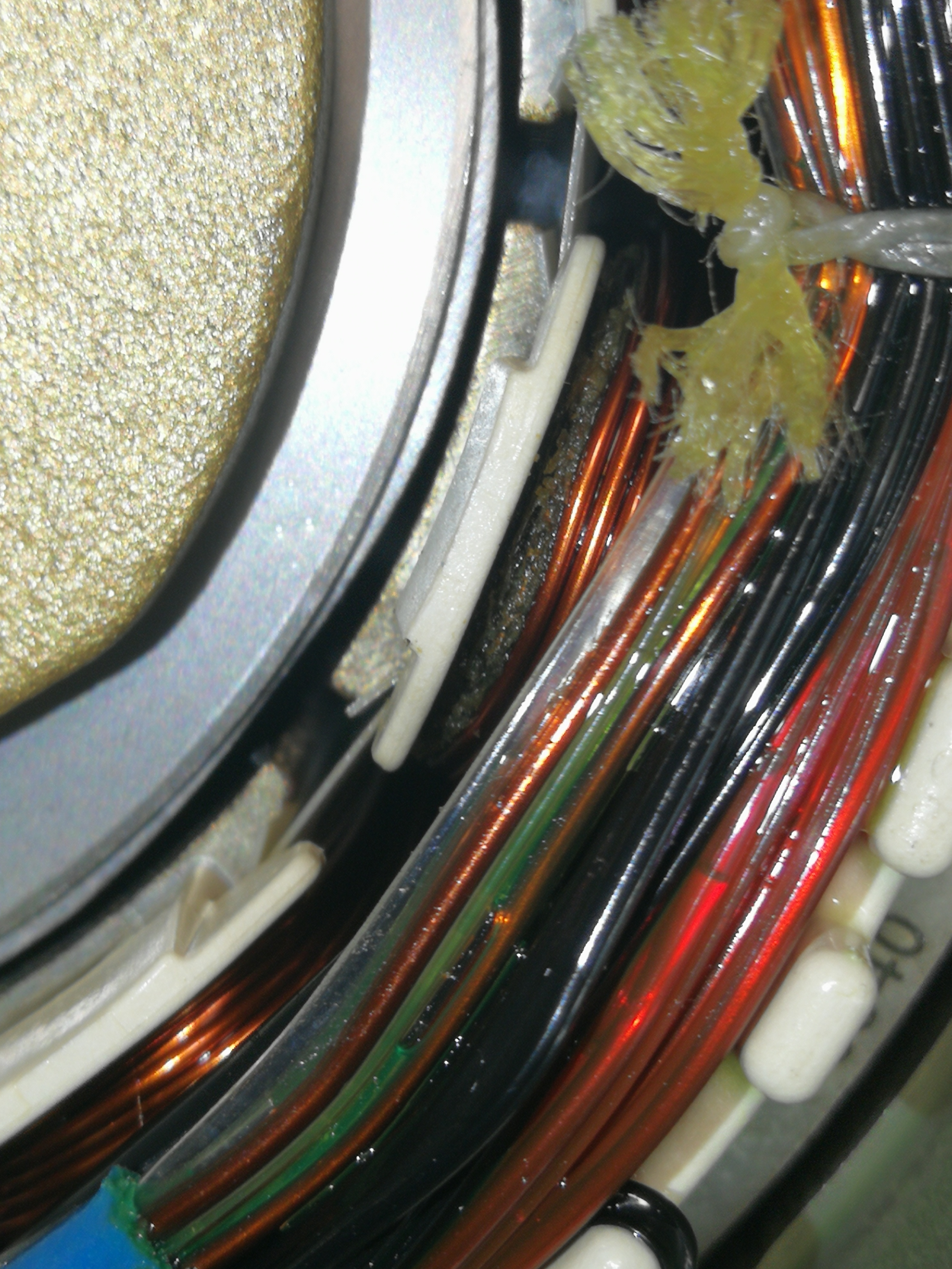

    Good evening Gregory. Took the compressor off today. The winding rang - no short circuit, no break, no failure of the case. I haven't paired the transistors, but they ring correctly on the board. He is an employee

    Desolder and remove the motherboard. Check the IGBT transistors if they turn on and off Vge=+/-15V.
    You can check the compressor motor using the generator/starter (IGS) from the car:
    What exact error are you getting on the volvo VIDA? number and description.
    If the IGBT transistors are operational, then some other element has failed. For your convenience, a list of chips:

    whether I will be able to handle this air conditioning with the following interface
    I meant if this version will be able to connect to ACCM and reset the system with the procedure you described:
    grzelecg wrote:
    VIDA->SOFTWARE->ADVANCED-> select the ACCM module, then press SEND PROG and SEND RESET.
    The question is will this version of the interface be suitable for this?

    The DICE interface you provided is fine. I have the same.
    Procedure:
    As the first word indicates, it's a procedure in the VIDA program, I have one too.
    This is an old version of the offline version of the software with the option of ordering software from the manufacturer.
    Currently, there is a newer version of the interface and software in the online version on the manufacturer's website - of course, paid by subscription.
    I have schematics. I have to rummage through them and look for the ACCM connection after CAN and whether it has a connection to OBD.

    I completely disassembled the compressor. I can clearly see the closure between phrases. I will rewind the stator.

    Mihalich wrote:
    Good morning, Grelec.
    Thanks for the info. So it is confirmed that the SP-A2 oil dissolves the insulation of the wires.
