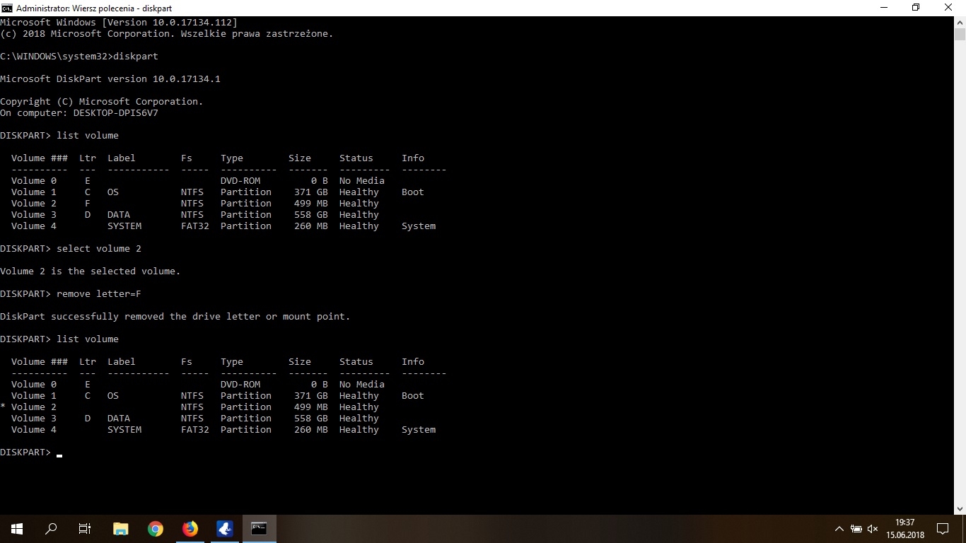

    For some reason, an additional F disk appeared with nothing. I tried to remove it but can't do it.
    Removing Additional Local Disk F: Daemon Tools, Low Space Alert, and Disk Management
    I have Daemoon Tools installed but nothing is added there.
    Hint how to remove this disk, because messages about low space on it pop up.

    Hello. It is not an empty drive F folders are hidden for System Restore. You have Win 10 64bit version 1803 and disk created after upgrade?

    It helped :)
    1. In Cortana, type cmd and press Enter. Then right-click on Command Prompt in the search results and select Run as administrator.
    2. In the Administrator: Command Prompt window, type diskpart and press Enter.
    3. Enter the list volume and press Enter.
    4. Make a note of the volume number for the drive letter that you want to remove. For example, if the drive letter you want to delete is Drive "G", note the volume number for Drive G.
    5. Enter the following command and press Enter.
    select volume
    When typing this command, replace with the volume number that you noted in step 4. In the example above, if the volume number for disk G is 5, type: select volume 5.
    6. Type the following command and press Enter.
    remove letter =
    After typing this command, replace with the drive letter you want to remove. In this example, enter: remove letter = G7. Close the Command Prompt window.

    In the event of a system failure, you cannot repair it without this partition, I would leave it, I do not mind and I have it hidden.
