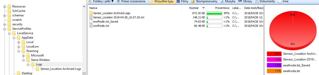

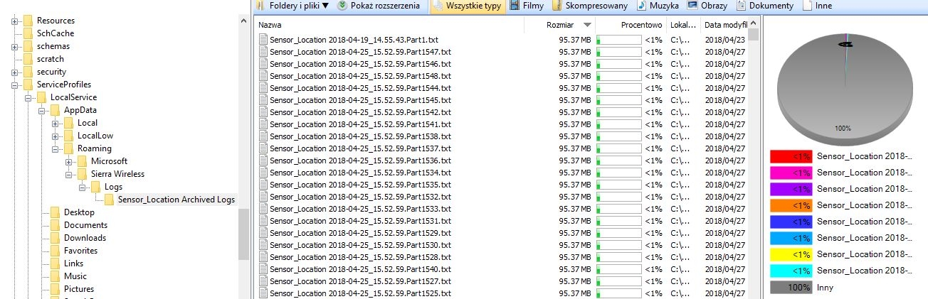

    Glary Utilities found something like this:
    Windows 10 - Disk Space Full Error, 1TB Drive, Usage Analysis Misleading, CCleaner Results Windows 10 - Disk Space Full Error, 1TB Drive, Usage Analysis Misleading, CCleaner Results
    What is this and can it be deleted?
    #6 17192539
    migel
    Posts: 39
    You can delete, these are logs. The question is why this device is so talkative.
    It looks like the position log from the GPS device.

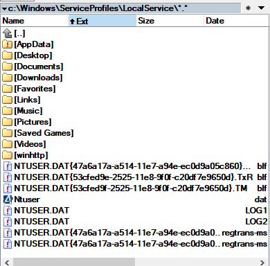

    OK thanks. It's weird because I do not have GPS.
    And how to show this folder in the file overview? Because it is more hidden than the law provides:
    #8 17192602
    Pedros050
    Posts: 17914
    Help: 2471
    Rate: 3926
    Hidden folders included?
  • #9 17192646
    Martinezzz123
    Posts: 227
    Rate: 23
    Nice. I did not know that the total Comander also works (in previous systems it was not like that).
    Thanks!
  • #10 17192649
    Martinezzz123
    Posts: 227
    Rate: 23
    Thanks!
    I deleted the Wireless logs
