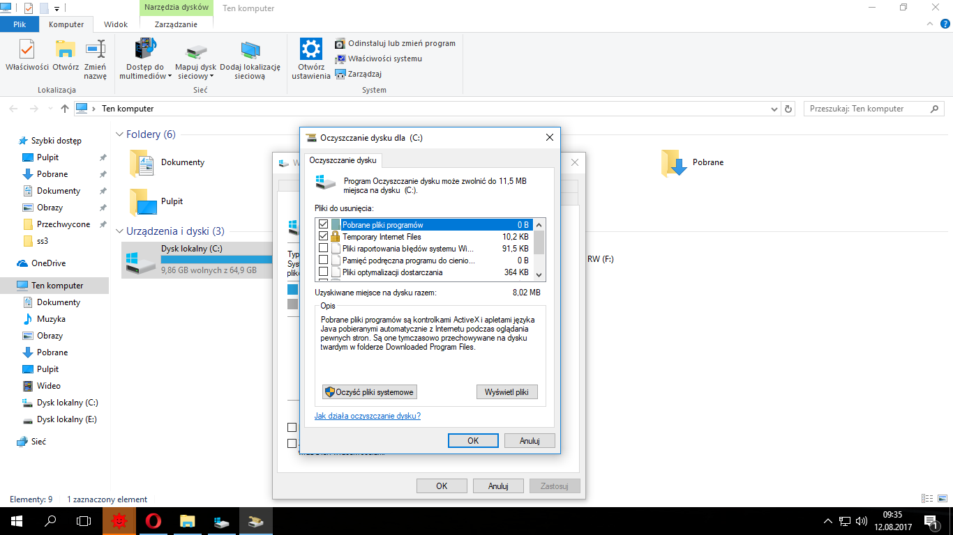

How can I find and stop the rapid loss of free space on the Windows 10 C: drive?

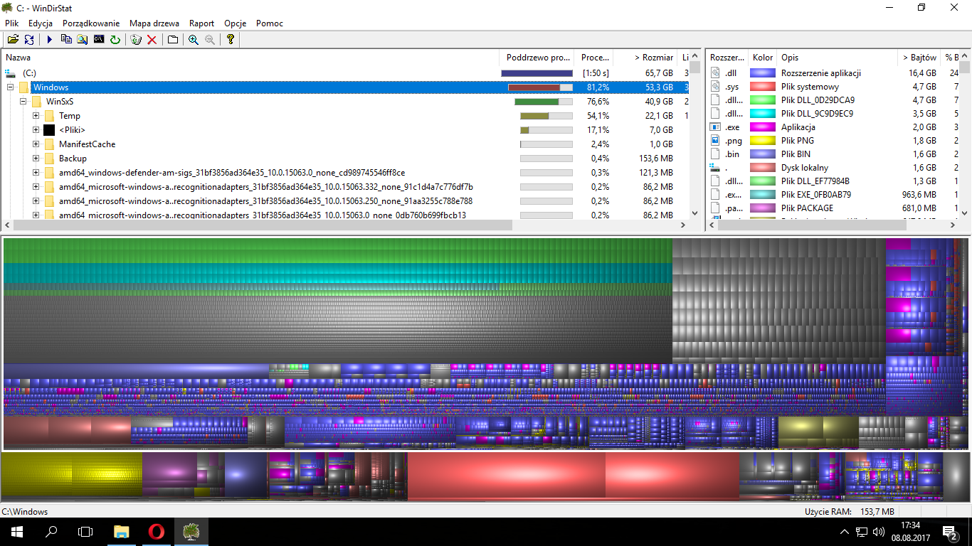

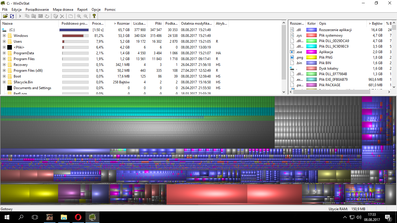

    Please use WinDirStat to find the folder with unwanted content.
    On the basis of what the Lord wrote, I dare not suggest anything more.

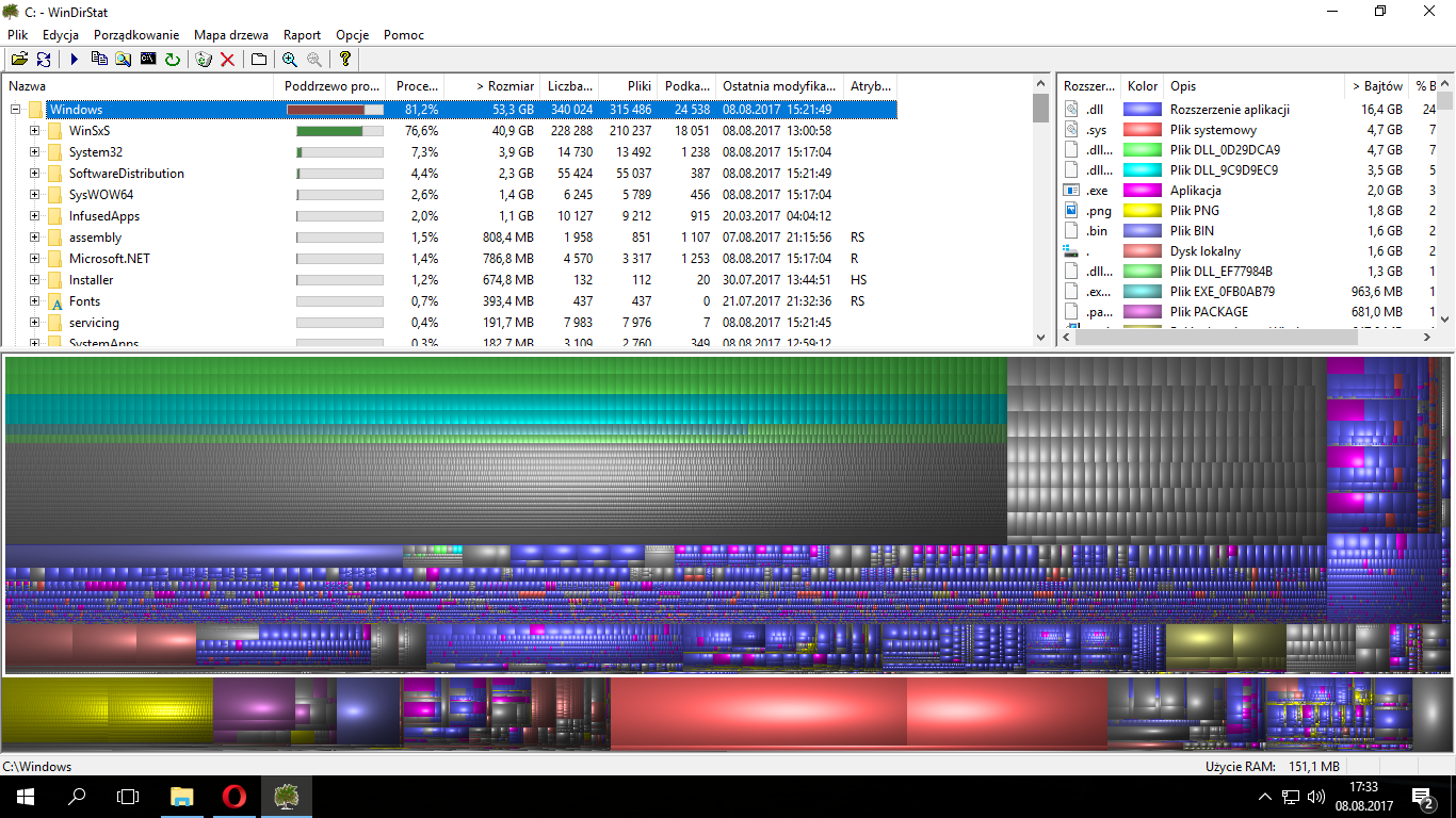

    Since it is WinSxS - I skip some opportunities for risk-takers, because they and weaving little as a result - it already takes up almost 41GB, it makes no sense to look for anything further until the system partition is enlarged (e.g. x2).
    You can clean - remove even the system disk cleaning "Clean system files" - SoftwareDistribution content (always> 2GB), but not much more.

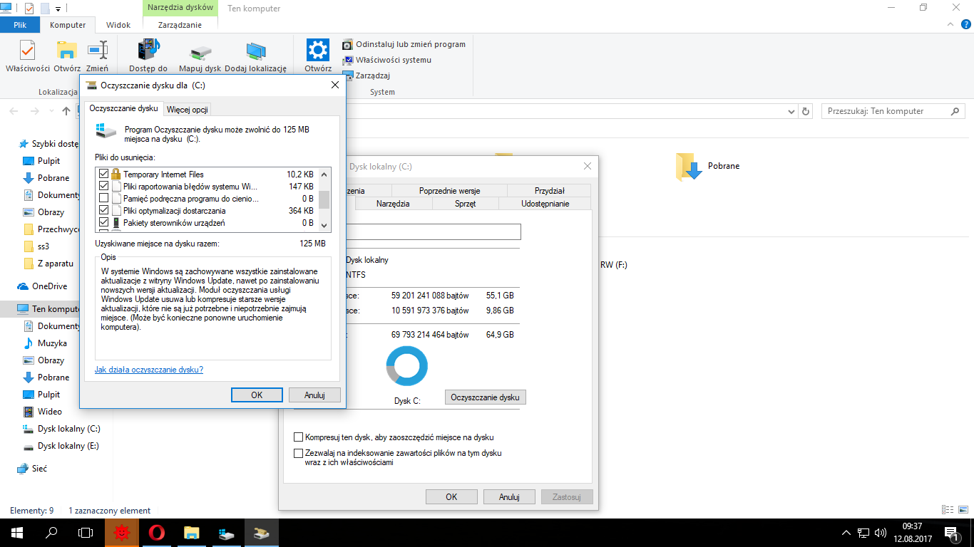

    First, you click "clean" and the "Clean system files" option will appear at the bottom left. :)

    Just out of curiosity ... What is this 1.8 GB PNG file? ;)

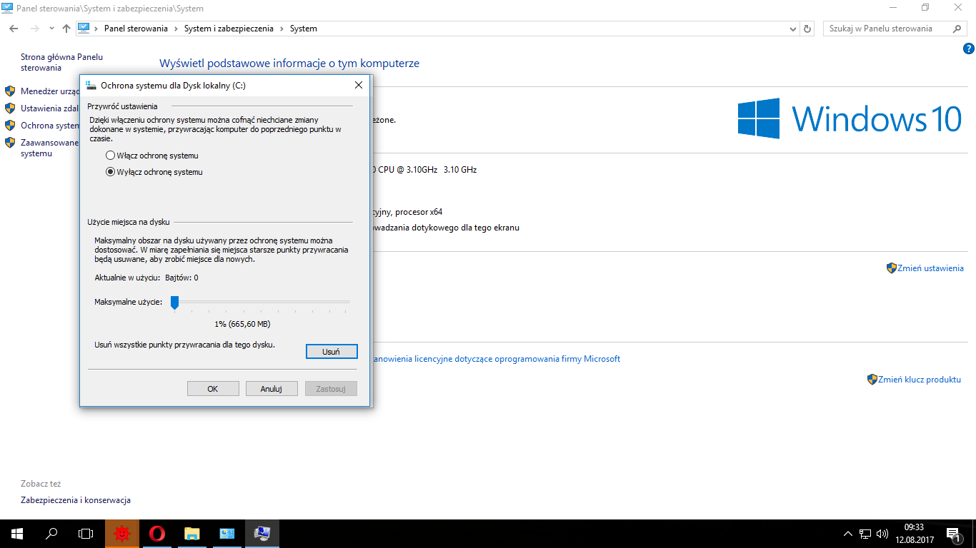

    Delete all restore points (if the system is OK) and limit the space for this purpose to e.g. 5-6 GB - I turned it off completely, I do Backup quite often (it takes 20 minutes with Acronis :)
    This is not one file!

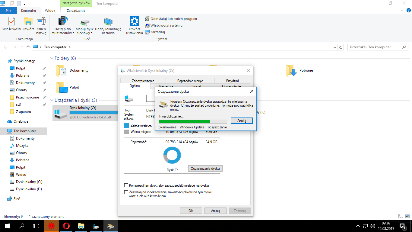

    Did you system clean the C drive?
    Have you cleaned up system files? -> mainly Backup files Service Pack + Windows Update + Thumbnails
    Have you deleted all restore points (if system OK) and limited the space for this purpose to e.g. 5-6 GB?
    I think restore points are taking your place ...
    System protection ->
    "D" -> configure, delete all points and turn off
    "C" -> configure and delete all points, then use the slider to reduce the space (you are sure to set it to 100% space - this is the default).

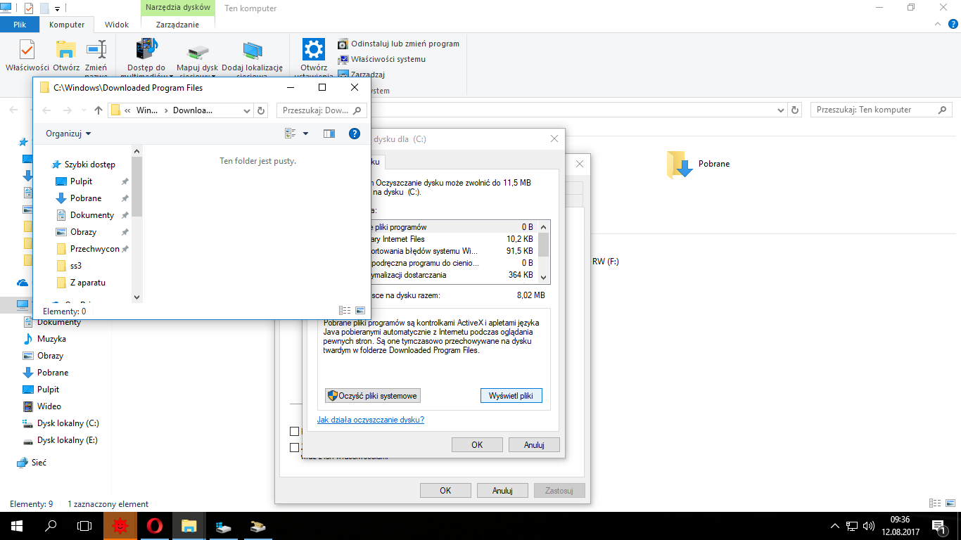

    Naweralny wrote:
    As for the restore points, they did not have a separate space, so they took almost nothing.
    I have a feeling that you have no idea about it, so let me show it graphically:
    Experiencing Rapid Disk Space Consumption on Windows 10 - Drive C: Details Provided
    Naweralny wrote:

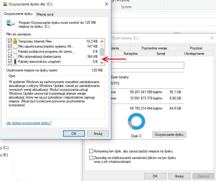

    Cleaning up the system files did nothing, it freed up so little space that I barely noticed it, maybe 2-3 GB was added.
    1. Click "Clean C drive" and wait for the result, how much space can be recovered -> you do nothing, just click "Clean system files" and wait for the result
    2. Select "Service Pack Backup Files" + "Windows Update" + "Thumbnails" and click "Clean"
    3. After cleaning you do RESTART - there will be system configuration and proper cleaning!

    Can you show the items "at the bottom" ?:
