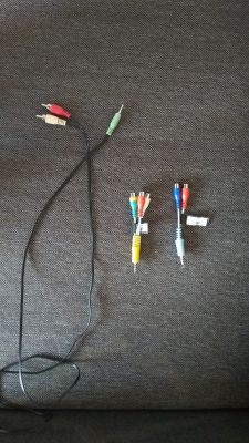

    Yesterday we installed the above-mentioned Samsung TV. Then I started connecting the sound and this is where the problem arises. The TV has two adapters attached, with an indication that the sound should go to the yellow output. The yellow adapter has colors that match the colors of the speaker cable. Unfortunately - the sound does not work. I tried every cable configuration in every potential input, of course I also set the TV to audio / optical output.
    I enclose a photo of my cables.
    Can anyone help?

    What is your audio equipment to which you want to connect the TV?

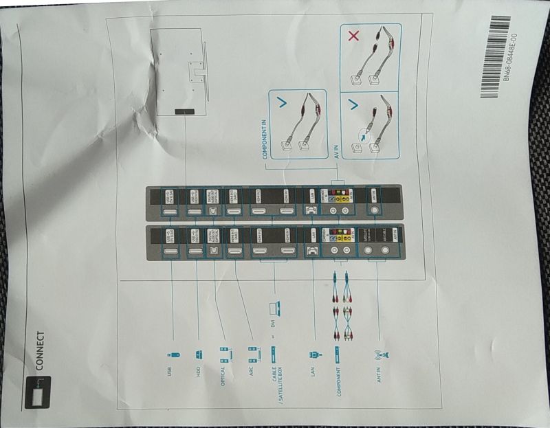

    Insert photo sockets from the back of the TV.

    Genius SP-HF1800A
    I don't have to pull the TV off the wall now - I took a photo of the entry list. Samsung UE55MU6172U TV: Trouble Connecting Speakers - Guide for Audio Output Setup

    Genius SP-HF1800A - these are the speakers, and I was still asking about the amplifier.
    You cannot connect the speakers under the TV.
    No eggs for an apology.
    @olador - they are active speakers.
    Active - i.e. they have a built-in amplifier, as if a colleague did not know or did not deign to check.
    @ feiran.zg - I reviewed the specifications of this TV and it has no headphone jack, which would be the simplest solution.
    A friend will make sure and check on that TV just in case.
    And if this output is not available, then only the use of the DAC converter remains.
    There are a lot of topics in this section about connecting a DAC converter, also a colleague will search.
