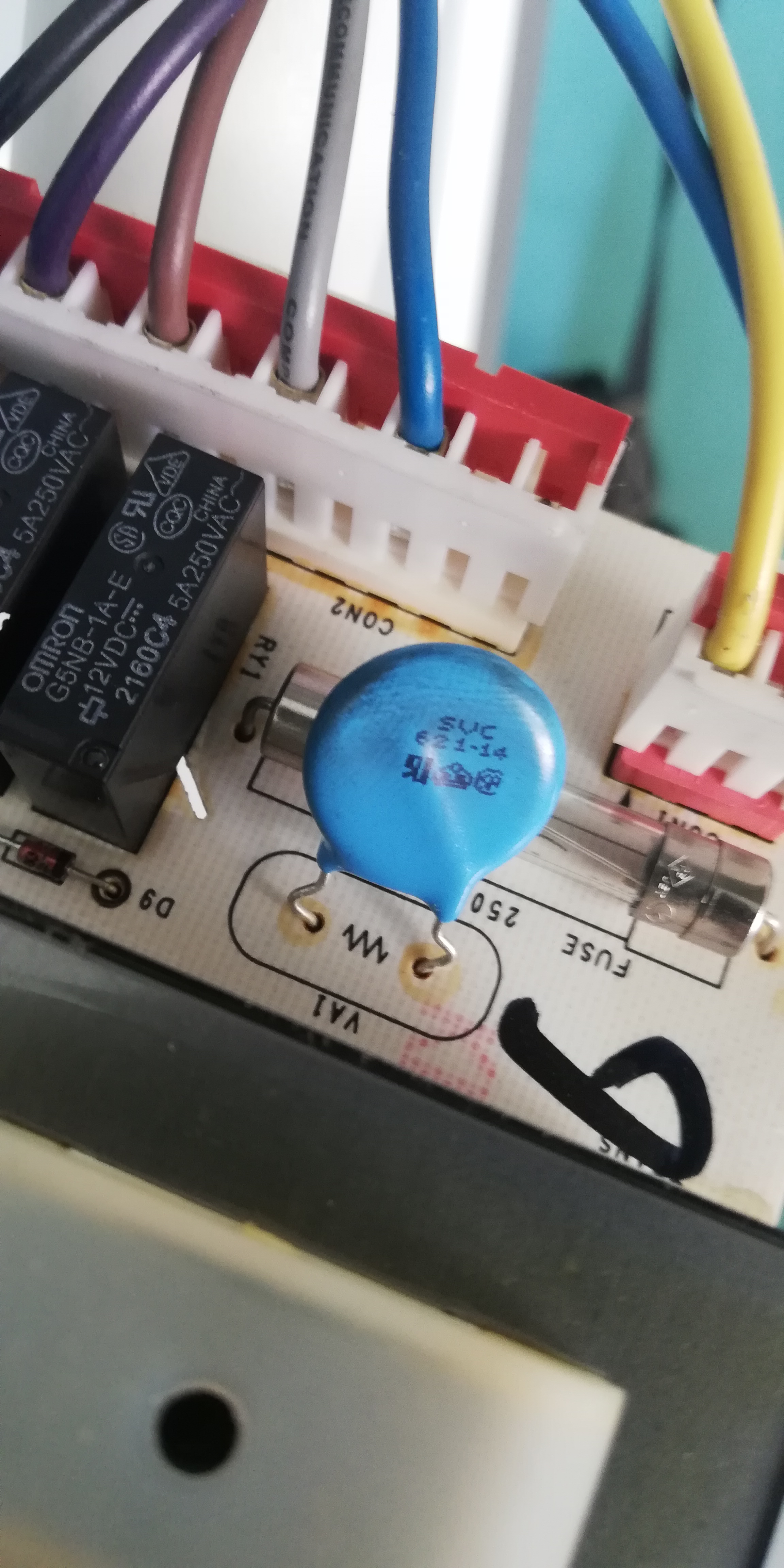

    Hello, I have a question whether this warostat has blown, how to check it?

    The fault will have a short circuit / or a resistance close to a few ohms. Another symptom visible to the naked eye is nadpalenie / charring / rupture

    A ten warystor?
    • Varistor Efficiency: How to Test If It's Blown? Troubleshooting Tips & Techniques IMG_20180802_140604.jpg (2.23 MB) You must be logged in to download this attachment.

    Buddy, any meter in your hand set to Ohm and work. Of course, we do all work with the power off!
