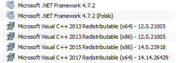

    Is there anything else missing besides:
    Fortnite Application Error: Game Won't Start on i5-7400, MSI H110M PRO-D, GT 440, Win 7
    i5-7400
    MSI H110M PRO-D
    Corsair 2x4GB 2400MHz CL14
    GT 440
    Windows 7

    Zainstaluj WSZYSTKIE wersje MSVC++ (32 oraz 64bit):
    Microsoft Visual C++ 2005 Redistributable
    Microsoft Visual C++ 2008 Redistributable - x64
    Microsoft Visual C++ 2008 Redistributable - x86
    Microsoft Visual C++ 2010 x64 Redistributable
    Microsoft Visual C++ 2010 x86 Redistributable
    Microsoft Visual C++ 2012 Redistributable (x64)
    Microsoft Visual C++ 2012 Redistributable (x86)
    Microsoft Visual C++ 2013 Redistributable (x64)
    Microsoft Visual C++ 2013 Redistributable (x86)
    Microsoft Visual C++ 2015 Redistributable (x64)
    Microsoft Visual C++ 2015 Redistributable (x86)
    Do tego DirectX.

    I have installed everything, however still nothing has changed.
    Can it be affected by the lack of any system updates?

    SpyShelter was the problem, namely its key encryption driver. Disabling this option, or the entire program, did nothing. Only when I unchecked this driver during installation did the problem disappear.

    I installed the Microsoft visuals from the list above and the game works.
