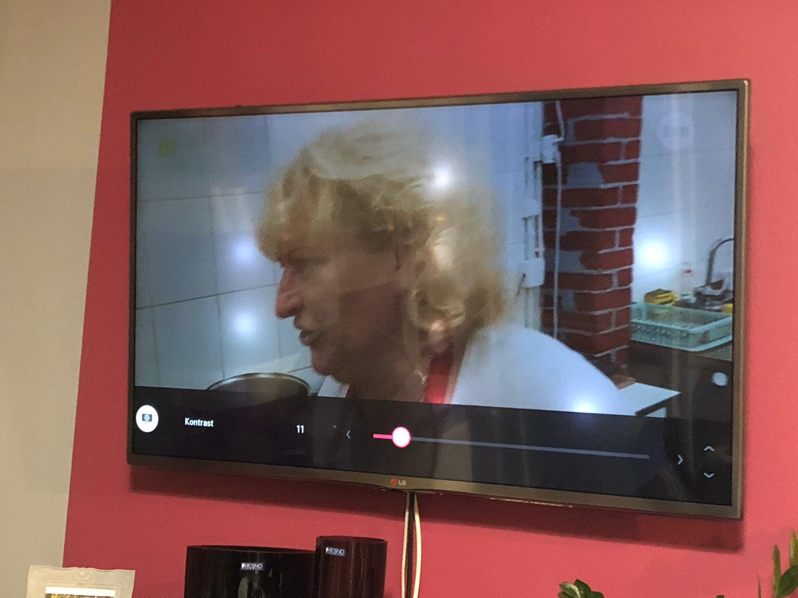

  • #19 18467726
    ertivo
    Posts: 47
    Rate: 24
    We have the same on LG TV, I wonder whether to buy a new one, or to undress and try to fix it?

    Buddy ertivo do not go this way, do not do it yourself because you will damage the matrix. Not long ago a colleague wanted to replace the backlight and is now looking for "display".
  • #22 18468578
    czajnik23
    Level 22  
    Posts: 407
    Help: 51
    Rate: 169
    Repair certainly costs less than buying a new tv, replace with new strips.

    ertivo wrote:
    Can this one undress and try to fix it?
    Try it if you have technical skills, because electronic skills are not needed here. You have everything on the tray.
    #25 18470716
    KAROL19766
    Posts: 218
    Help: 5
    Rate: 37
    You need to replace the new led strips and that's it, the most important thing: when removing the matrix and inserting it the most important CAUTION !!!!
