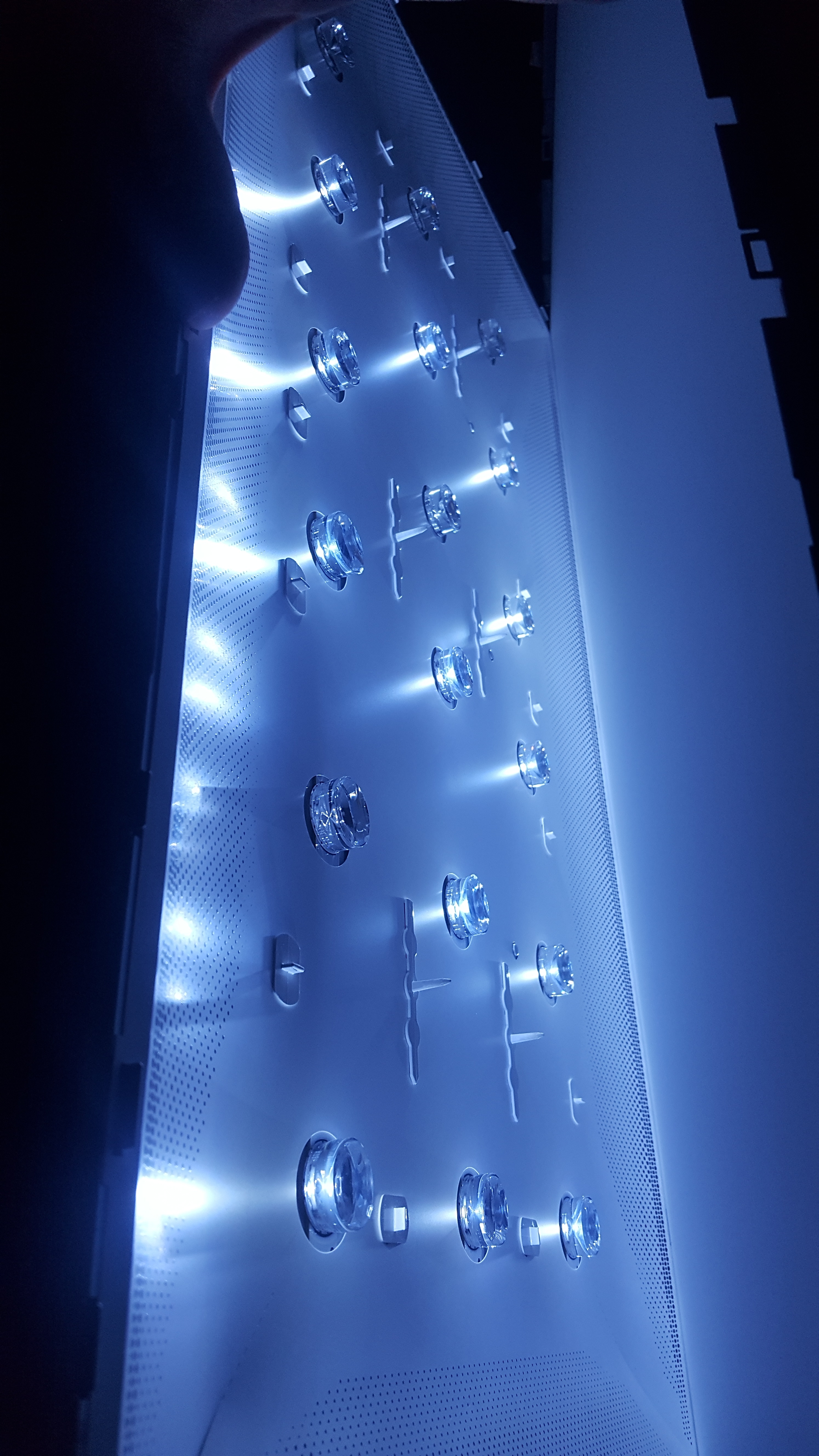

    I replaced the LEDs, but I have the effect of visible LEDs on a light background: / probably badly matched LEDs?
    the matrix is
    • TV LG 32LF5610 Dim Screen Issue - Power Supply Replacement? (Photos Included) matryca.jpg (221.4 KB) You must be logged in to download this attachment.

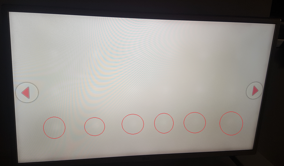

  • #17 17535408

    As for this ... etc ... (I did not select all the diodes - because you know)
    Well, that's the charm of Chinese strips. They seem to glow stronger than the original ones, which I have observed myself. Maybe they have other diodes? Other lenses?
    And I did not write to take the original? :D It was only PLN 70 difference and it would not be a problem. I avoid them and put them on only as the original is not available.
    And the fact that they are on a metal strip and that they dissipate heat better does not appeal to me. Some Vestels also have metal slats and they also burn out.

    It looks like there is no matrix in this photo :-) , provide a photo with some content.
    Preferably "input" twice.

    You will get used to it over time, and it will not be so visible during the day.
    And you do not have the impression that the image is brighter with these Chinese LEDs and you need to go down with the backlight (not brightness) slightly?
