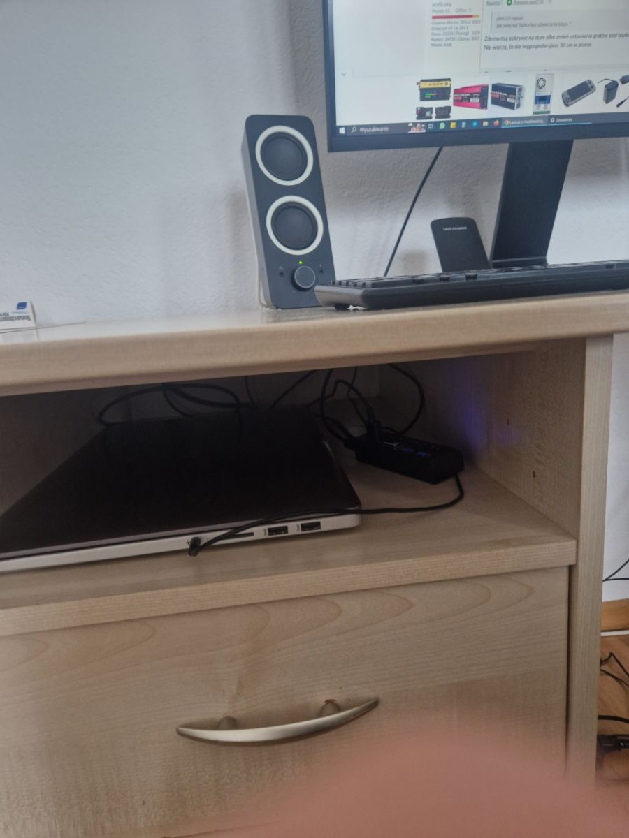

    gilek123
    Posts: 6
    And what, masters, is there any solution? I hid my laptop under the desk, the problem is that I can't turn it on because I have to open the cover with the screen and there is no space under the desk. How to turn on the laptop without opening the lid?
  • #12 20420297
    vodiczka
    Posts: 30276
    Help: 1185
    Rate: 4311
    Remove the cover permanently or change the position of the items under the desk so that the cover opens freely. :D
    I don`t believe you won`t be able to find 30 cm vertically.
  • #13 20420323
    gilek123
    Posts: 6
    Well, unfortunately I don't have room... Choosing a Laptop with Power-On via External Dock for Photo Editing & Gaming
  • #14 20420379
    vodiczka
    Posts: 30276
    Help: 1185
    Rate: 4311
    gilek123 wrote:
    Well, unfortunately I don`t have room
    Well, you don`t, but the laptop is in the desk pocket, not under the desk.
