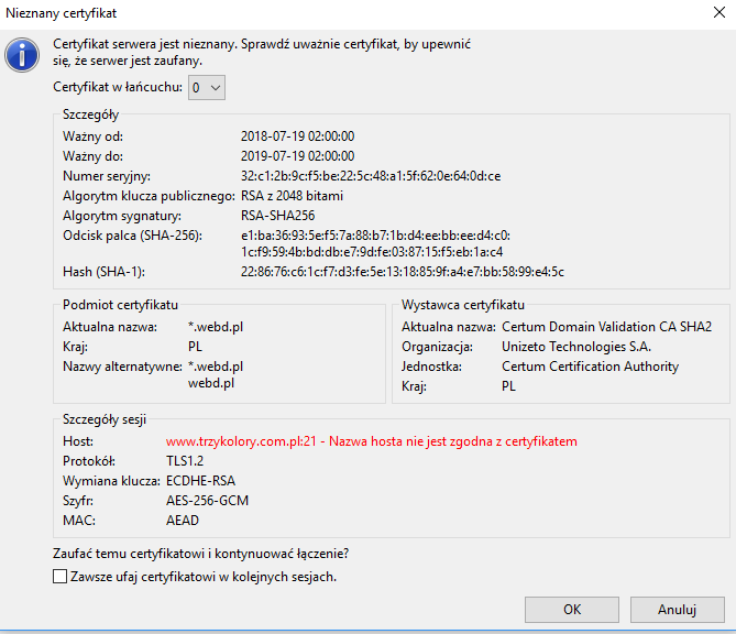

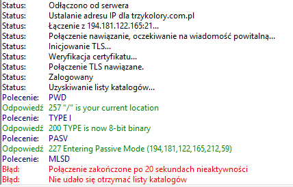

    Thanks for checking out. Unfortunately, the problem is more difficult to solve, because I can't log in via ftp, i.e. I log in, but cannot view the directories. And when it comes to the change I made, it was only a change from HTTP to https.

    I know what's going on, but I don't see any catalog, not even the main one. I know it's weird because I didn't expect it, but it is.
    Wordpress panel - You cannot log in to the admin panel at https
    The problem probably also applies to the security certificate, but I do not know why it affects the root directory.
    At the moment, the situation seems to be without solution. I wrote to support the server, maybe they can somehow improve it.

    Gentlemen, thanks for all the advice and ideas. I learned a little bit about SSL over this failure and how to better not rummage in wordpress :)
    After reporting my problem to my domain's technical support, the site was restored. Login via ftp now also works. However, I do not know what the gentlemen from the domain service did, that it all started working again.
