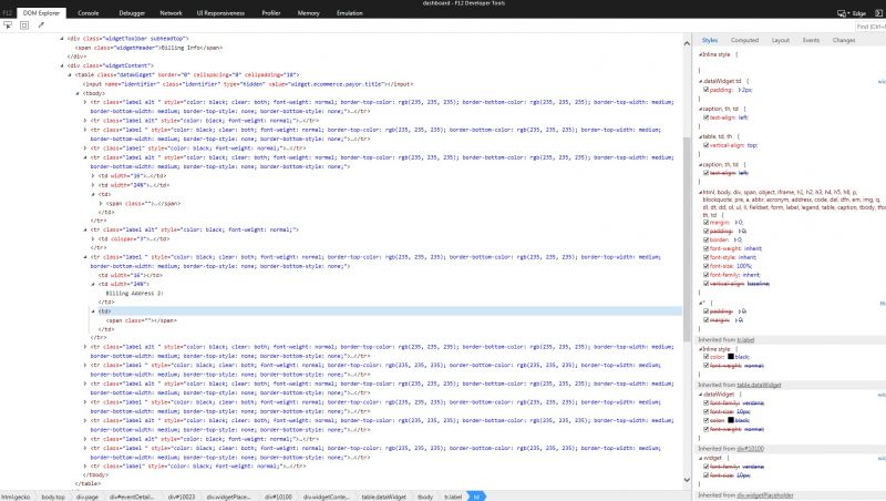

    Please help. I have to download data from the website, but unfortunately no element on the page has its own ID, name, etc. Therefore, the use of .getElementsById or .getElementsByTagName is probably out of the question (or at least I don't know how to connect it). Below I am attaching a photo of the script from the website.
    I am asking for help if you can play specific data or transfer everything to Excel so that I can "work it" further. I will be grateful if someone has already written code that downloaded such data and will make it available for inspection.

    I don't know much about VBA, but html elements can be downloaded e.g. by tag name or class. Here 'document api': https://developer.mozilla.org/en-US/docs/Web/API/Document
    It is worth paying attention to the querySelector and querySelectorAll methods: https://developer.mozilla.org/pl/docs/Web/API/Document/querySelector which allows you to very precisely define what elements you are looking for. Thanks to this, perhaps we can do without some loops by elements

    I recommend running the development console and testing the selectors there to find the right one. Some example: document.querySelector ('. DataWidget tr: nth-of-type (3) td: nth-of-type (2)');
    Instead of nth-of-type, you can use querySelectorAll and select the appropriate items from the array. You need to familiarize yourself with the basics of using the console in the browser.
    If you throw in all the sample html and say which fields you are interested in, I will try to help with the selection
