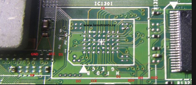

    How did you manage to read the emmc memory. I am using TNM5000 and it does not detect emmc via isp.
  • #41 17986308
    balus1
    Posts: 17
    You gave power to the 3.3V panel
    or emmc bad

    I give 3.3V on BD1301 - according to the isp pinout (PCB BN41-01587E) [/ center]
  • #43 17986603
    balus1
    Posts: 17
    external power supply
    • Seeking EMMC NAND SDIN5D2-2G OneNAND KFG1GN6W2D BN41-01604C Dump for Samsung UE40D6000 TV D6000.JPG (65.67 KB) You must be logged in to download this attachment.

    This is a picture from the "Lam forum", main BN41-01660 from UE ** D55 **, stupid attempt to count OneNAND without soldering. :D :shocked!:
