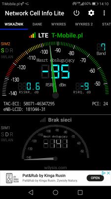

    Hello, this is my first post in this forum, so please be understanding.
    Two days ago I bought the B525s-23a router together with the lte T-mobile INTERNET MAX internet offer. I set the router in the best possible place using the Network Cell Info Lite application (I transferred the card to the phone and checked the whole house including the roof). Strangely enough, I got the best results on the 1st floor by the window (standing on the roof above this window, I got worse results?).
    B525s-23a Router Performance with T-mobile INTERNET MAX: Speed Variations and Optimization
    Here is the screen from the roof, in the room I obtained -92.
    When it comes to speed tests, I have a good lottery. B525s-23a Router Performance with T-mobile INTERNET MAX: Speed Variations and Optimization B525s-23a Router Performance with T-mobile INTERNET MAX: Speed Variations and Optimization
    And once I was able to have "even" 26 Mb / s. So you can say that depending on the time and I do not know what it gets from 1 Mb / s to 26 Mb / s. For PLN 80 a month it is a pathetic result and I would like to do something about it but I do not have adequate knowledge. I thought that the antenna on the roof could somehow help, but since the measurements from the roof were worse than from the room in which I currently have a router, that's probably not the problem.
    Do you have any idea how to improve the quality of the connection?
    In addition, I am surprised by one thing, the router generates two wifi networks 2.4 and 5. Amazingly, the 2.4 network has a much better range, what could this be caused by?
    Thank you in advance for all the help, I've only had Internet for two days, but if you can't do anything about it, I have 14 days to return, so I have to act quickly so I don't get stuck with such an offer for two years.

    And why don't you use B525 for testing? check the LTE2600, LTE1800 and LTE800 bands as well as the LTE2600 + 1800, LTE2600 + 800 and LTE1800 + 800 aggregates. check eNB, CID BTS, signal parameters on each and do evening speed tests. For now, the phone connects to LTE2600 T-mobile on BTS NetWorks Nowa Wieś. It can, however, change both BTS or bandwidth, on this in N.Wsi operate 3. There are several other NetWorks BTSs in the area. What is your location?
    Thank you for your answer. How to do tests using B525? How to check the bandwidth and aggregation? How to check eNB, CID and BTS? I would like some links, I will try to "comprehend" them myself, but if you would like to explain it to me in this thread, I will be very grateful. My location is Mikołaja Reja 10 town Granica.

    B525 works with http://www.mediafire.com/file/79obbe81eufdt7t/Huawei_Manager_1.2_PL.apk/file This is an Android application, you connect the phone with WiFi via B525, log in to the application at 192.168.8.1 and you can force specific LTE bands and LTE band aggregations. I will also show eNB, CId BTS and signal parameters. You do a speed test on each. This way you will get the data you need and choose the optimal band / bands and the antenna for it. There are 2 BTSs in Komorów but only LTE1800NetWorks on them.
