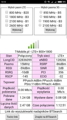

    Hello, today I bought a subscription in T-mobile unlimited home internet up to 60Mb / s
    along with the Huawei B528 router, when I put the sim card on the phone, I have about 10Mb / s, but when the same card gives to its right place, i.e. to the router, the internet after wifi drops to about 3-4Mb / s. I will add that, to my surprise, I have 1 range on the router and 3-4 on the old phone. My location is Węgrzce Forteczna, I wonder if the router has such an acoustic range, maybe an external antenna will do just what?
    I will add more
    RSRQ: -14dB
    RSRP: -108dBm
    SINR: -8dB Best Antenna for Huawei B528 Router: Improve T-Mobile Unlimited Home Internet Speed & Signal

    Force LTE800, LTE2600 and LTE1800 in turn on the router and LTE1800 + 800, LTE2600 + 800 and LTE2600 + 1800 aggregation, use HManager band management for http://www.mediafire.com/file/99t05l2dv6vany8/Huawei_Manager_1.1_PL.apk and above test this in Węgrzce and not in Krakow on BTS from Kalwaryjska on overloaded LTE2600 T-Mobile with poor LTE signal parameters.

    Correct signal parameters from LTE800 at BTS Insurgents 50 in Krakow, show DL / UL because low SINR can testify that BTS is clogging up. Check LTE1800 and LTE2600, work on this BTS and LTE bandwidth aggregation. Aggregation uses several LTE to DL bands, on B525 two LTE bands are aggregated, and LTE 6 category modem. With the help of HManager it can be used to force LTE2600 + 1800, LTE2600 + 800 and LTE 1800 + 800, check the parameters of the signal, CID and speed. Tests best in the afternoon at the internet peak.

    Good grip with this aggregation LTE 800 + 1800 looks best, about 36Mb / s, the question I have is one more thing to take underneath the external antenna to improve these results, and of course does it make sense?

    Screen with HManager on LTE1800 + 800, plus speedtest in the evening. Speed is not everything. How does LTE2600 and LTE2600 + 1800 look like?

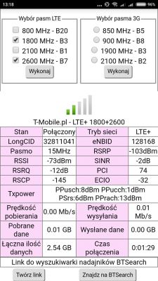

    And so it gives screana: Best Antenna for Huawei B528 Router: Improve T-Mobile Unlimited Home Internet Speed & Signal Best Antenna for Huawei B528 Router: Improve T-Mobile Unlimited Home Internet Speed & Signal Best Antenna for Huawei B528 Router: Improve T-Mobile Unlimited Home Internet Speed & Signal
    Speeds at LTE2600: ping- 22ms download-4.65Mb / s upload-2.82Mb / s
    Speeds at LTE2600 + 1800: ping- 73ms download-6.23Mb / s upload-2.26 Mb / s

    On LTE800 + 1800 it is BTS from Powstańców. At LTE2600 and LTE2600 + 1800 it shows BTS Kalwaryjska in Krakow, but it is impossible. Parameters of the signal on LTE1800 + 800 where the basic band is LTE1800, if the speeds are satisfactory then you can use without the antenna.

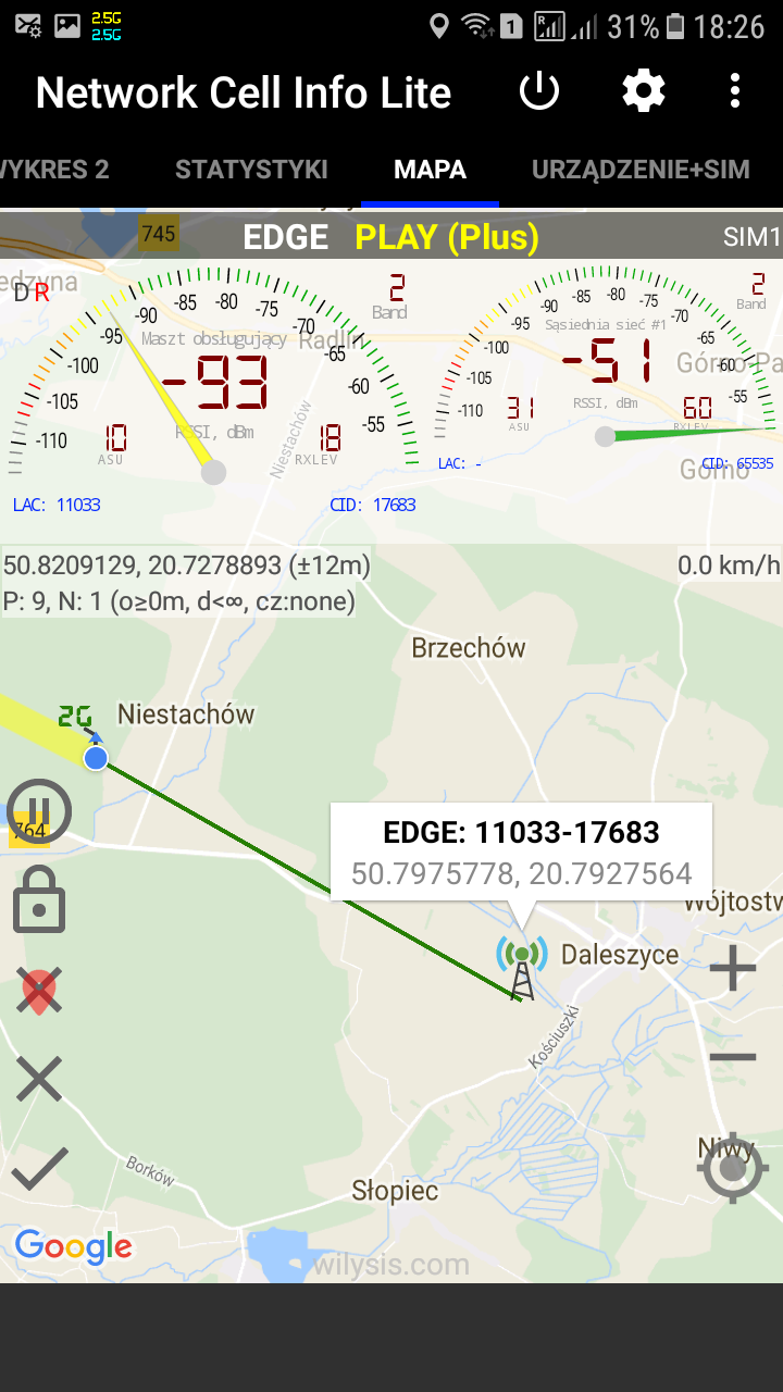

    I'm going to ask you about the antenna for this router. The coverage is fatal - tests on the network cell of all operator cards show instability .. even no speed test shows. Location Niestachow nr73w, connects with bts in Daleshyts.
    I need equipment that will increase the signal, thanks to which there will be any internet.
    I've also got the routers on the concentrator better in this situation. Please say something because a madman goes without a net ...
    I will add from the internet card it sim2 on screenshots

    Location among forests but not too bad. BTSs of all operators at a distance of 6-8 km in different directions. Play test on your phone at home or outside? Connection to LTE800Play in Daleszyce very poor signal parameters. Roaming Plus on 3G with UMTS900Aero2 in Górny. Did you do any Orange, T-Mobile tests? They have coverage from their own LTE800 BTS in Kielce, W polsk and Górno.

    All tests outside Today, he is buying an orange starter and we will see.
    Until recently, the Internet from the play hulal well but for two months sat down unmercifully ..
