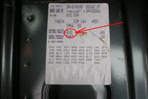

    Engine code would be helpful.

    Can you tell me how can I tell the difference because it's not my car but my girls? Some differences. Because I actually read on the net and there are AUA, BBY, BKY engine codes, how can I define it?

    Stuck in the trunk
    • EGR Error Persistence in Skoda Fabia 1.4 16v 75km - Exploring EGR Emulator Efficiency kodfab2b.JPG (51.65 KB) You must be logged in to download this attachment.

    Tomorrow, when I go to work, I will check it and write it on the forum
