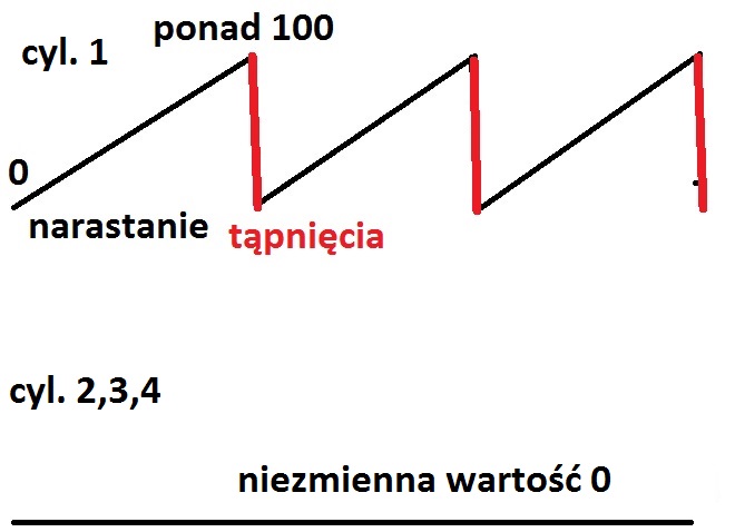

    The case concerns the skoda fabia II, 1.4 16v 86HP, BXW engine, 2008. mileage 140kkm. Here is a brief history of "maturing" faults.
    June - July 2016
    Noticed very sporadically and hardly perceptible, occurring every few, several seconds single "vibrations" transferred from the engine to the cabin felt at low speed. Firing dynamics, flawless combustion.
    30/11/2016 - first check on the board, error canceled, everything is ok except for the "twitching"
    17520 - Oxygen (Lambda) Sensor Regulation: Bank 1: System too Rich
    P1112 - 000 - -
    Readiness: 0000 0000
    12/01/2017 - second check on a board, error canceled, everything ok except for the still "vibrations"
    P1112 - 000 - -
    16685 - Cylinder 1 Misfire Detected
    P0301 - 000 - - - Intermittent
    mechanic diagnosis: replacement of candles with new ones (they already deserved it) and replacement of the coils with places with another cylinder and drive for a while as it appears again, it needs to be repaired
    24/01/2017 - third check and the following errors
    P1112 - 000 - -
    17519 - Oxygen (Lambda) Sensor Regulation: Bank 1: System too Lean
    P1111 - 000 - - - Intermittent
    P0301 - 000 - -
    Readiness: 0000 0101
    After the third check, the car clearly already has a telepiece engine, it seems to be driving but it lacks power. Clearly mussels on Pb and cold engine when accelerating, more vigorous gas pressure causes a noticeable throttling of the engine, warmed up is slightly better. After firing on a cold engine runs evenly without throwing errors until "overheating" then "vibrations" appear.
    On warm, "vibrations" are felt all the time, ignition loss occurs only on 1 cylinder both on Pb and on LPG, but on LPG it is much more intense, the change of coils between cylinders does not matter. The car fires normally from the shot. Engine operation deteriorates with its warming up, the warmer it is, the worse. Compression pressure on all cylinders equalized and is above 13.6-13.5, so healthy as a bull.
    Where do you advise to start replacing components so as not to charge at unnecessary costs probe for the first fire?

    Something else I remembered the candle on the 1st cylinder was black with soot after the thread, the other cylinders 2,3,4 candles with clear correct coating. Porcelain insulating the central electrode of all 4 candles as white as a box from the box no raids.
    Even while the engine was running, the work of the cylinders was monitored and the 2,3,4 cylinders had a zero value (I do not know only what parameter was meant but the topic experts will know) and for 1 value it increased in a dozen or so seconds from 0 to over 100 times, and the chart was like the teeth of a saw, growing and rocking to zero. As if something was reset or exploded in this cylinder and in time of these drops with an irregular shift in time, you can feel these "twitches" just not every time they coincide but I think it results from the differences in refreshing the information transfer to the diagnostic computer.
    Maybe in this cylinder there is no fair spark or it is not every time and there is periodic ignition is possible? Maybe the ECU was gone?
    I apologize for the amateur painting but I try my best to describe everything.

    The revs on the tachometer are even, the pointer does not fluctuate according to the computer fluctuations between 780-820 rpm, the engine runs quietly only.
    Yesterday evening I talked to a mechanic and says that the damage to the gasoline injector on the 1st cylinder came out and the mixture was too rich.
    He claims that the gasoline injector "hangs up" and does not work properly, then the computer tries to correct the composition of the mixture to the maximum value of corrections that can be made, catches an error and after switching to LPG it does the same on the gas injector and hence these vibrations, because in some at the moment the corrections are restarted and an attempt to return to the optimal values is still in progress in the loop. If, in fact, the gasoline computer then controls the gas injectors directly or indirectly, or even has an effect on the LPG system controller, then maybe this error is later transferred to the LPG injector and due to the fact that gas is a slightly different fuel than gasoline, these vibrations and silting on gas is more noticeable.
    My question here is: if petrol injection gets dirty, why can't LPG get the correct settings? In fact, the ECU "remembers" this error rigidly?
    As for one more thing, he told me that the engine can not be screwed in revolutions "to the section" only the tip of the tachometer comes under the red field and then as if there was no "forces" there is no typical sections only as if damping, mulching (I do not know how to specify) turnover according to it only indicates a malfunction of the fuel system because electrically it claims that everything is fine.
    As for the mechanical defects of the timing system at the moment they are excluded by the mechanic, auscultated the engine and claims that picking the head will be the last resort.
    I do not know this so much and it is difficult for me to determine whether this is how the computer actually works. What he says has a logical sense but is it really so?
    What do you think about it?
    The mechanic confirmed - as colleague Grala1 wrote - that if there was something with the valves, it would wave and revolved once in a 1.4 VW engine.

  • Burnt valves and carbon deposits caused the misfire
    #15 16249640
    Bambek
    Posts: 266
    Rate: 93
    The reason for the fault were burnt out valves, very large amount of carbon deposits in the channels. One of the valve stems looked like a mouse was eating it. I was surprised myself that after 140kkm the head could be so devastated, the fact that from the first kilometer the car had factory-set gas.
    The mechanic says he is very surprised that the engine kept the compression so high and even.
    Maybe it's the fault of a poor landi renzo installation, what do you think?
    The head has been completely regenerated with the replacement of valves, guides and sealants, etc.
    The car is currently being assembled at the workshop, I hope that was it.

  • Failed LPG injector caused cylinder 1 misfire on gas only
    #17 16251012
    Bambek
    Posts: 266
    Rate: 93
    Well, all signs indicate that after repairing the pest will recover. I'll call you when I pick up the car for today was not ready because I had to do the timing, 40kkm only but as they say "go cow let go and body".
    Edition from 07.02.2016 at 8:00.
    Auto made engine on Pb works perfectly without any interference, no vibrations.
    On LPG, however, the check crashes and the same error numbers as before on the 1st cylinder. Feel the continuous uneven operation slightly different than before the regeneration of the head, now it is light but nevertheless noticeable and continuous shaking and "wheezing" from the exhaust. After returning to Pb, everything stops and works perfectly again.
    Today visit to the gasman, suspicious LPG injection rail.
    Edition from 07.02.2016 at 21:55
    After visiting the gas supplier. Completely fallen LPG injector on 1 cylinder. Mileage 80kkm. Once, at 60kkm, the strip fell, but it was replaced with an identical one under the warranty. Now she fell for the second time after 80kkm it seems that this is some terrible crap.
