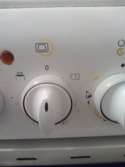

    I have a problem, I can't find the instructions (the cooker is not mine, the plate with the serial number is so greasy that nothing can be read) and I have a problem. Namely:
    Indesit Oven: Need Help with Worn Markings & Missing Instructions (Serial Number Unreadable)
    I really have no idea what is what. If anyone has a manual or preferably a photo of a cooker with unabraded oven markings, I would be grateful for help :)
    Thank you in advance.

    It's hard to say what should be in place of the worn icons. From what I can see there should be 6 items + 7 off. Most likely it will be what is in the picture below, taken from here: :arrow: link
    However, without the function second from the right, i.e. ... pyrolysis? Since the photo shows a copy with 8 items). It also depends on whether you have an oven with:
    1.) thermocirculation = heater + thermocirculation fan
    2.) only the circulation fan
    3.) no heater and fan
    It's best to check organoleptically: on a cold oven, turn on each function for 5 to 15 seconds and check which heater will heat up (provided that they are all operational).
    Indesit Oven: Need Help with Worn Markings & Missing Instructions (Serial Number Unreadable)indesit-ku...218392.jpg (41.36 kB)You must be logged in to download this attachment.
