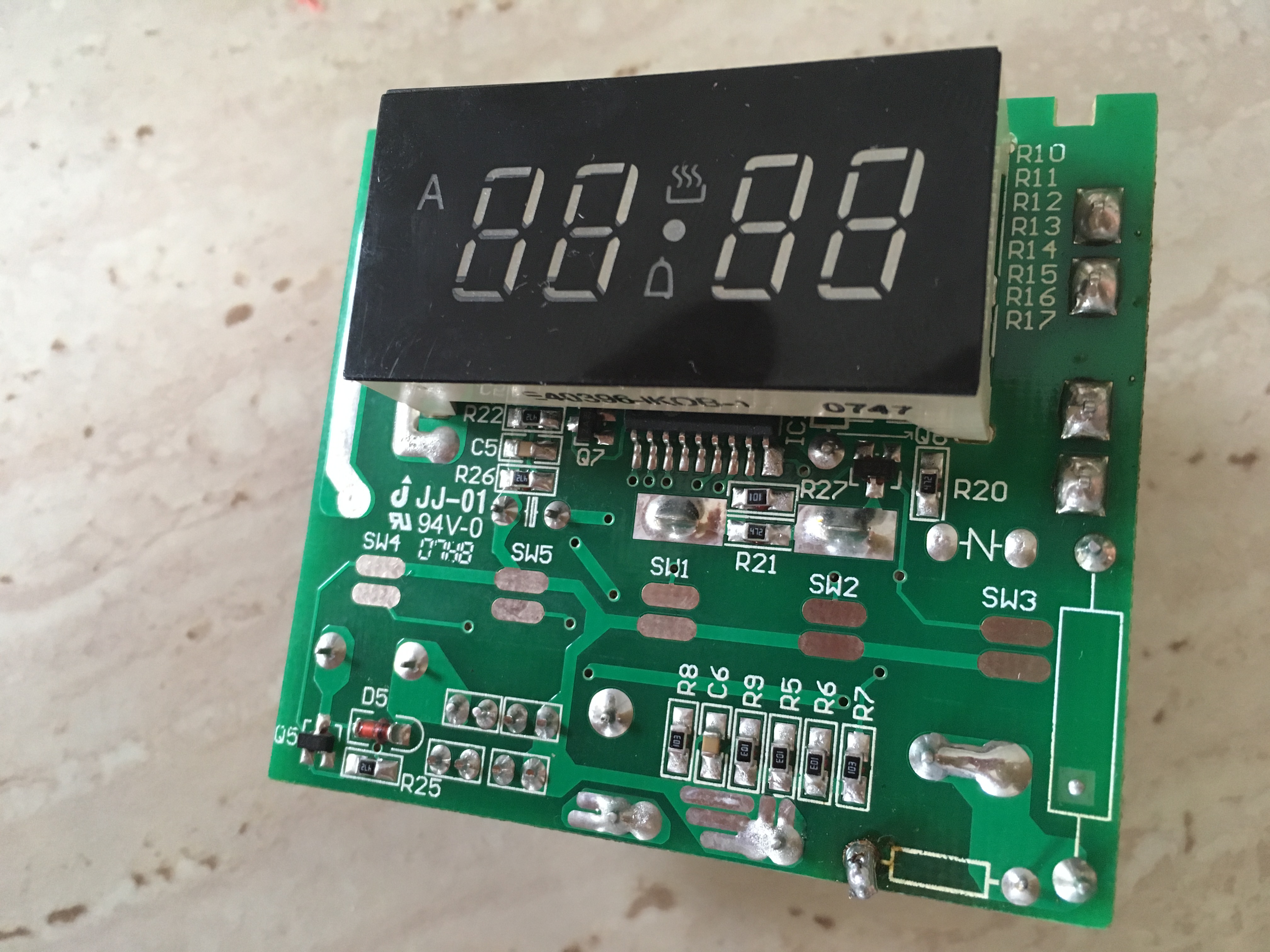

    Hello!
    I need help - which connectors should I solder to start the oven, I would not want to burn the controller, so I count on tips that will help me resuscitate the stove.
    Thanks in advance for helpful advice and tips.

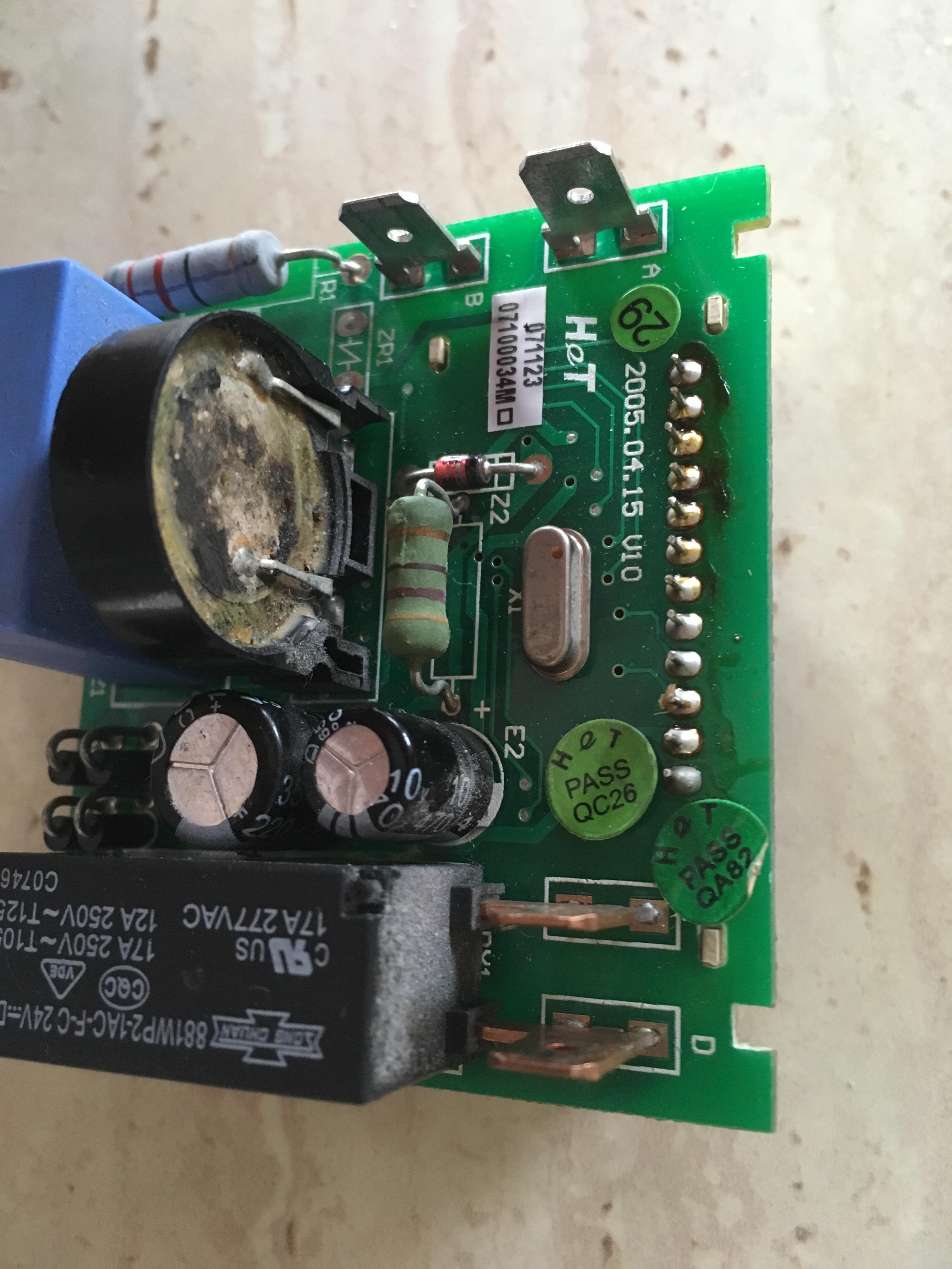

    Take a picture from the side of the connectors (on the other side of the board) which terminals are supplied with power (a, b)? I think the power source is the terminal (a, b) check the resistors, capacitor, diodes on the rectifier bridge on the power supply and there is probably a zener diode there.

    Pictures in the attachment

    In most ovens, a timer must be set to activate the oven to activate the relay. If for some reason this cannot be done, the easiest way is to bridge the relay contacts. The cables must be attached.

    At the bottom of the board you can see some cold solders.

    There is an even simpler solution, without a clock. Connect the wires themselves and insulate them.

    Hello, of course you have managed to start the oven :) each of the ways resulted in activation. I checked everyone and everything worked out SUPER. Thank you for your valuable advice
