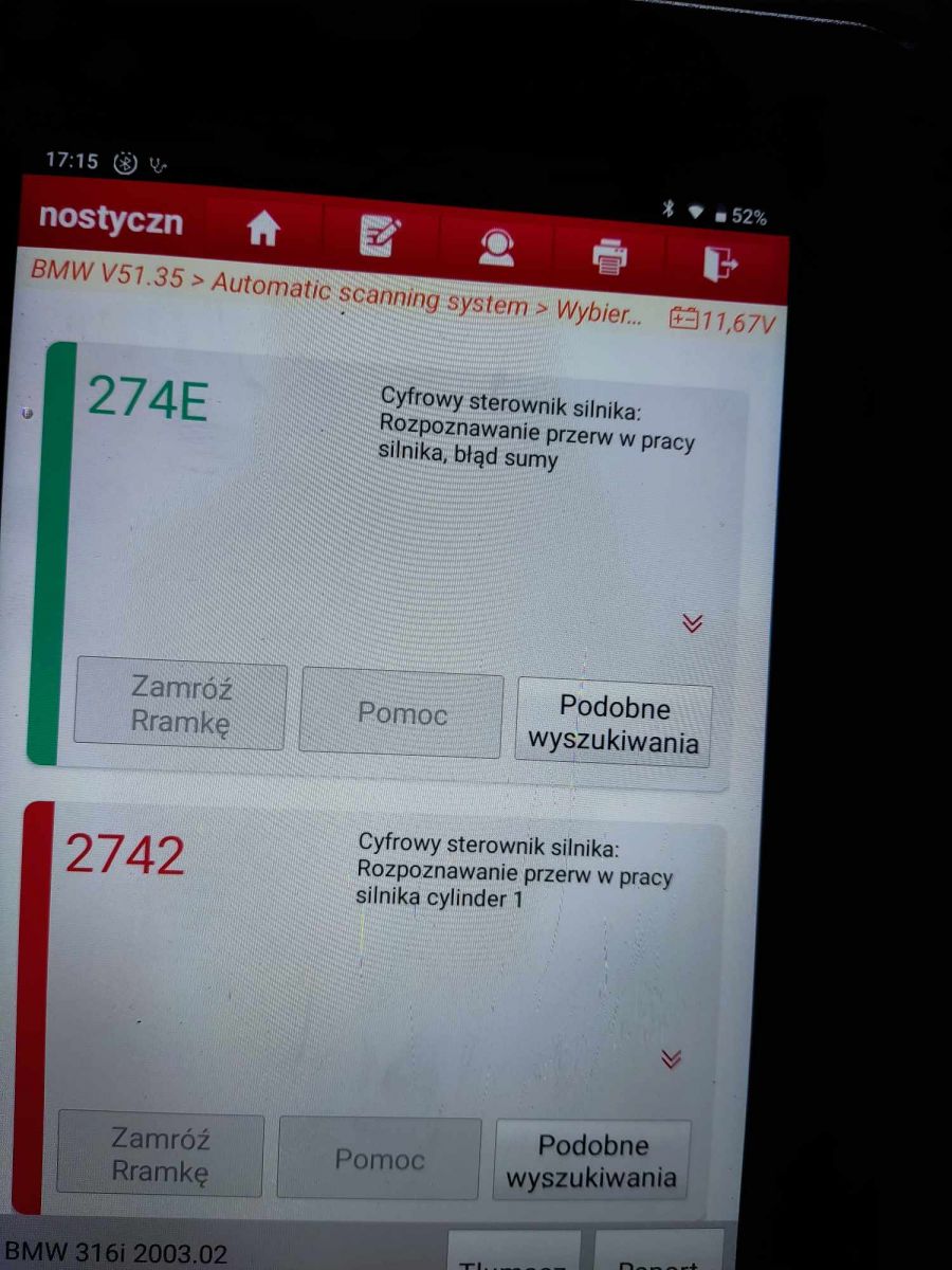

  • #13 20958875
    swiatelkowemgle
    Good evening. I would like to warm up the topic ;) Unfortunately, the engine error light came on permanently. After uploading it to the computer, it read: 274E - digital engine controller. Recognition of engine interruptions. Total error. And 2742 digital engine controller. Recognition of interruptions in engine operation, cylinder 1. BMW E46 with 1.8 engine. The car has traveled approximately 290,000 km. The mechanic immediately said that it was Valvetronic, so it was a skin for layette.... has anyone ever experienced that it was something else? I'm a bit under the illusion that it's a valve lifter issue. Is it worth investing in it or giving up? I will add that I am a typical layman and I am afraid that someone is just trying to scam me. Maybe you have a trusted workshop where they will honestly tell me what and how. I would be grateful for any suggestions.
    Image of a screen with BMW engine error diagnostics.
  • #14 20959132
    Strumien swiadomosci swia
    Posts: 27417
    Help: 1403
    Rate: 6391
    It could just as easily be the coil or spark plug or a leak. Change the workshop for sure.
