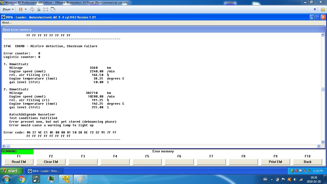

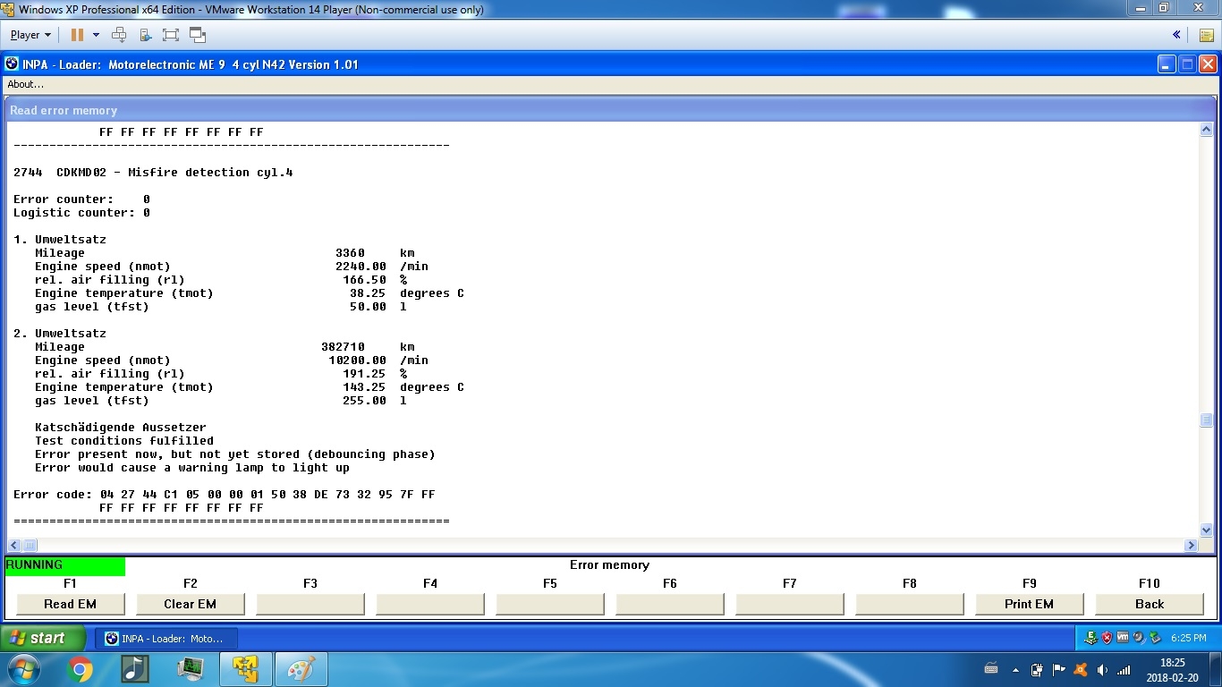

    After connection, it no longer gives gasoline but continues to collapse into the suction manifold. After checking it, some errors appeared on the computer:
    o 2731 timing. Inlet adjustment
    o 27BB Exhaust Inspection Control
    o 28D7 Communication Alternator
    o 27ED messages to ASC / DSC
    and sometimes ignition on all cylinders and with this ignition on the 4 cylinder

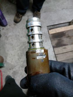

    Added after 5 [hours] 4 [minutes]:
    And this is how Vanos (electrovalve) looks like. I will add that both look like that. They were rubbed by the chain when adding gas.

  • #15 17058714
    marszałekkom
    Posts: 1625
    Help: 212
    Rate: 510
    This seems to be the engine in which you have to replace the tensioner and guide skids, because the factory has a congenital defect, and through them the chain jumps.
