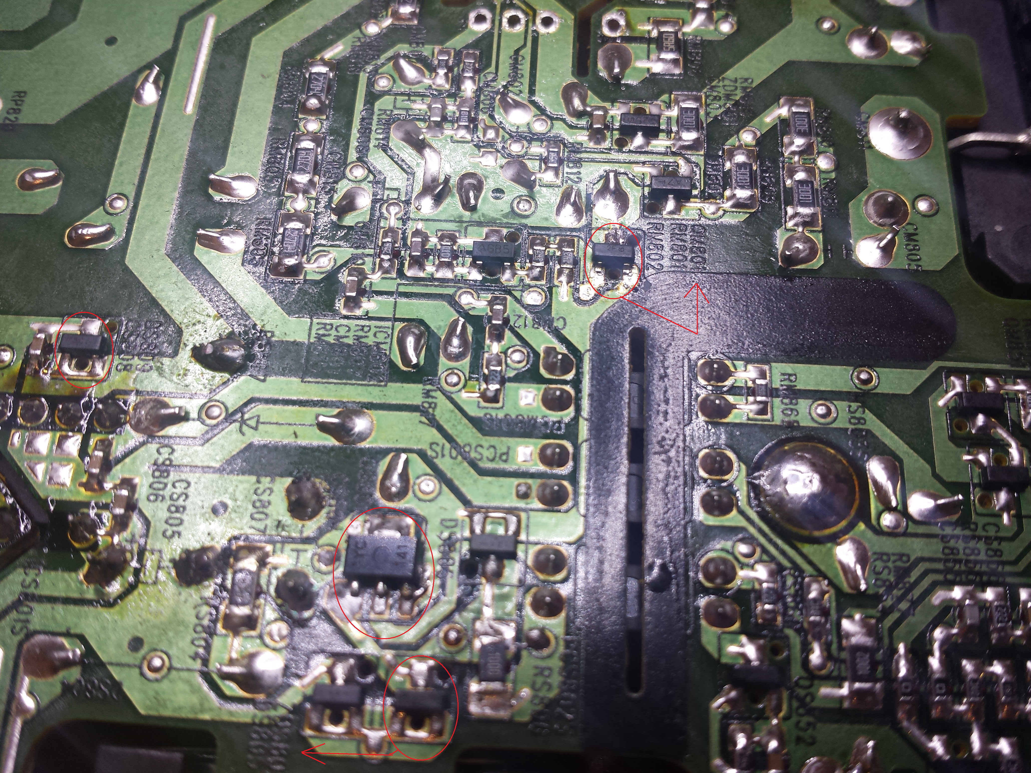

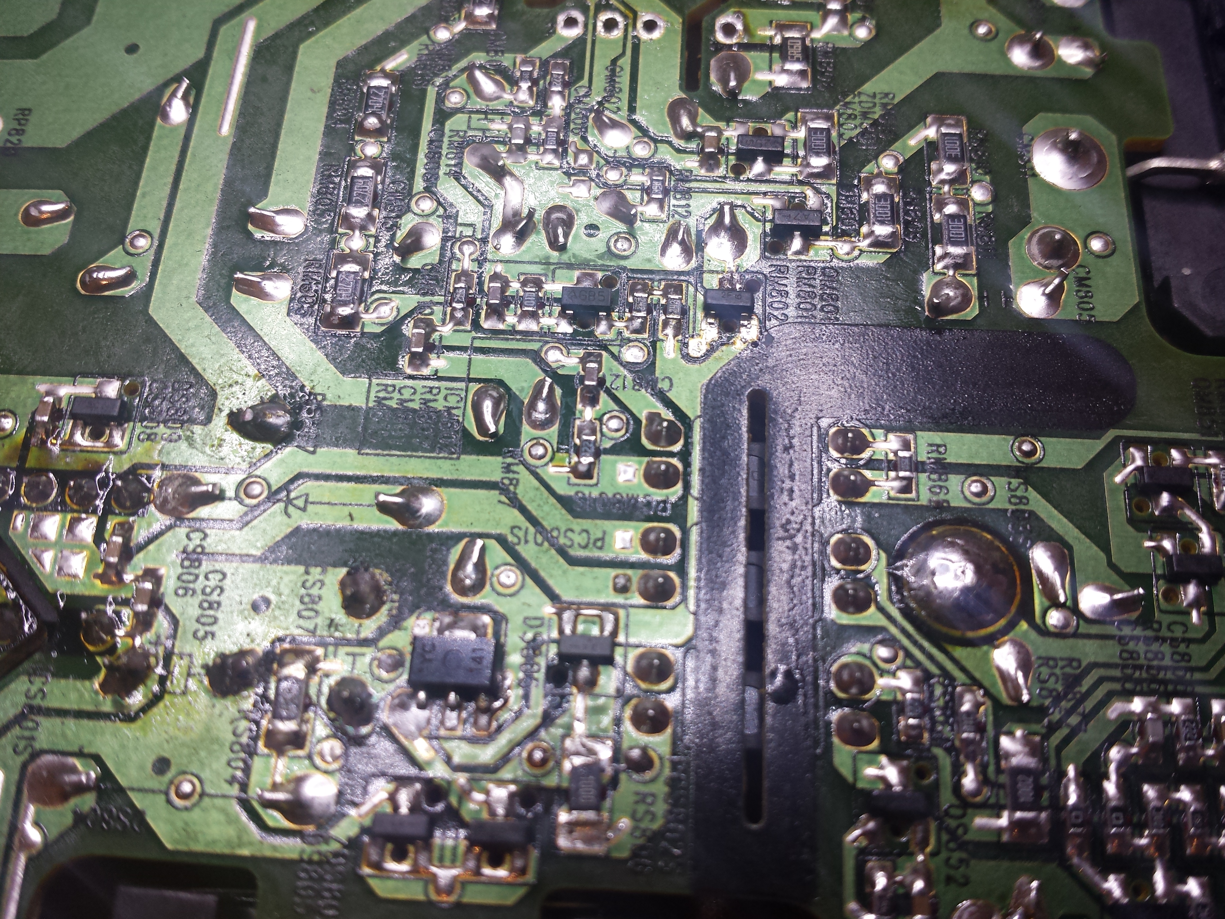

    Hi Guys,
    I find similar thread in Polish language and reply there in English, but they said to me that I have to open new thread in English for my problem.
    Old topic:
    https://www.elektroda.pl/rtvforum/topic2959174.html#14913477

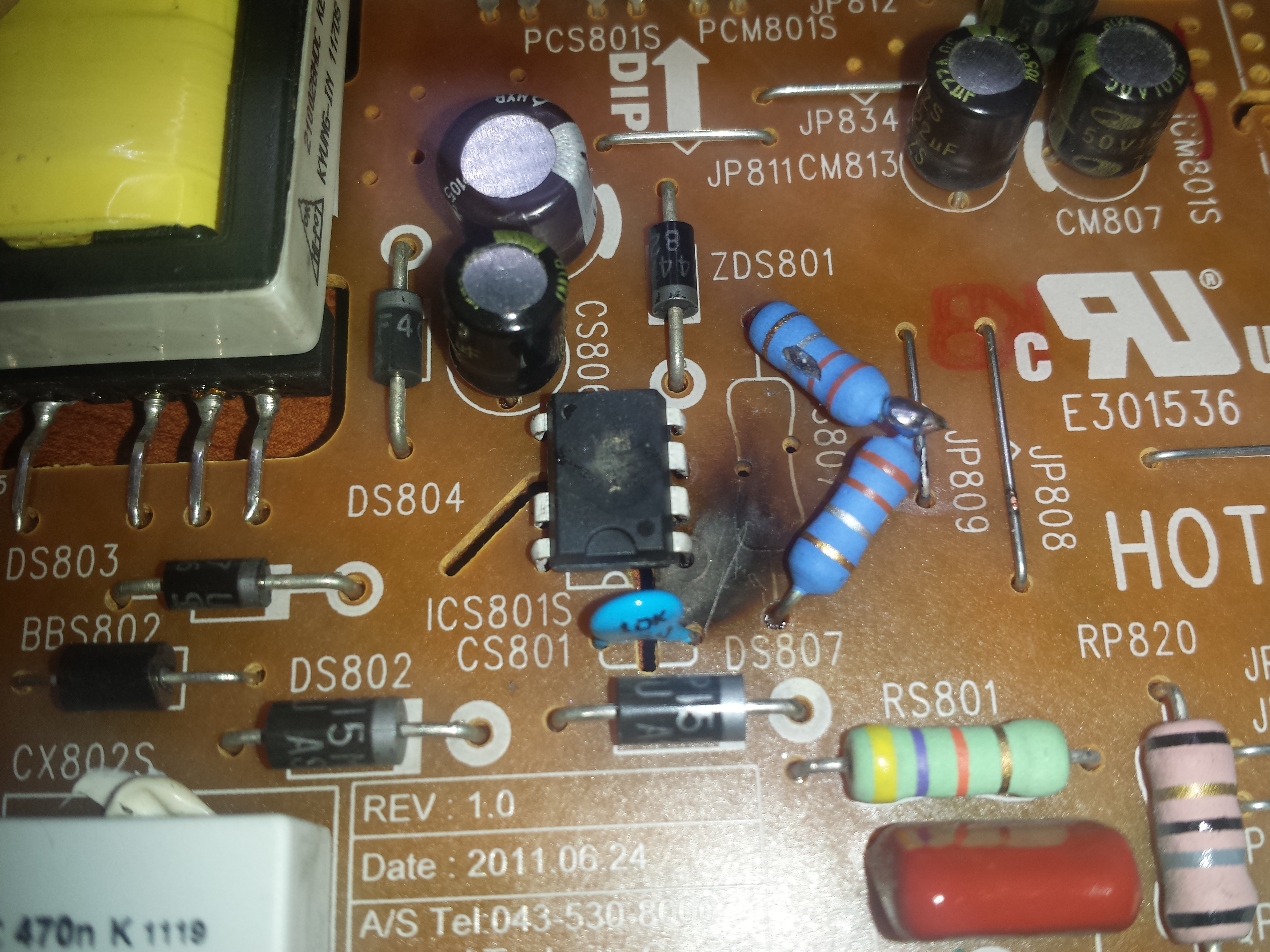

    ICS801S - STR-A6052M (blown)
    RS807 - 0.65Ω (blown)
    DS809 - ??? (questionable) - in parallel with RS807
    ZDS802 - BZX84B16LT1 (questionable)
    QM801 - ???(2F) (in short circuit)
    ??? - ???(°YC 141) (in short circuit)
    Does anyone know which is this diode (DS809), transistor (QM801) and ??? (YC)?
    Where can I buy these three on the internet ZDS802, because I doubt that I can find it in Croatia? Maybe if I replace it with something familiar.
    And if someone knows what else can be problem that STR-A6053M explode?
    What do I have to look for that I don't blow another STR?
    One is approx 9 euro. It's not too cheap.
    Pictures are in attachment.
    Sorry for my bad English.
    I appreciate any help.
    Thanks.
    Edited:
    I managed to find this site:
    http://alltransistors.com/smd-search.php?search=Yc
    http://alltransistors.com/transistor.php?transistor=56516
    And I think that (°YC 141) is this transistor from SANYO:
    http://alltransistors.com/pdfview.php?doc=2sc5994.pdf&dire=_sanyo
    For: QM801 - (2F) I think it's one of these:
    http://alltransistors.com/smd-search.php?search=2f
    Like: BC850B or something similar.
    I think it's all pretty much the same, just different vendor.
    When I get home I will check all other transistors or diodes and try to measure their dimensions to see what exactly is.
    • SAMSUNG UE40D6000 (BN44-00482B) - Identifying DS809 Diode, QM801 Transistor, and YC Component IMG_20150812_233430.png (17.37 MB) You must be logged in to download this attachment.
    • SAMSUNG UE40D6000 (BN44-00482B) - Identifying DS809 Diode, QM801 Transistor, and YC Component IMG_20150812_233430.jpg (5.76 MB) You must be logged in to download this attachment.
    • SAMSUNG UE40D6000 (BN44-00482B) - Identifying DS809 Diode, QM801 Transistor, and YC Component IMG_20150812_233238.jpg (4.44 MB) You must be logged in to download this attachment.

    hi
    if you please you are working without plane .. and that is wrong in this job ..why ?
    because you will damage more components and spend more mony .
    if you look to components you will see that some of them have suffix diferente from the other .ex ICS/ICM ..it is IC but S for standby circuit..but M for main switching circuit . standby cir must works first to produce 5v to supply the main board . I see the problem is in the standby cir (S) your job is to measure component related to it .
    another note there are different places with burned fiber ..it makes short cir ..it must be deleted completely before put it to supply .
    here is ps pic very near to your power supply I hope it will help you in repair this ps
    thanks
