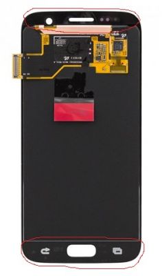

    This and I will be a little hooked on the subject. I need to paste the display to S7 and such a question how to spread the glue? Applies to glue B7000
    I think about the place where the buttons are most. Do I give it all or just about? Top and edges are known not to cover the camera and sensors, but as with the bottom. Is it better to buy a sticker?

  • #9 17551098
    seba1601
    Posts: 17
    In places such as buttons / sensors, I try to distribute the adhesive in the least amount possible, so that it does not get to places not intended for this
  • #10 17551162
    blahfff
    Level 42  
    Posts: 4972
    Help: 1036
    Rate: 1301
    In this case (and other models with thin OLEDs) nowhere. I would definitely recommend buying the original, cut double-sided tape that will have the correct thickness. You can then optionally add gently T7000 on the top and bottom edges, but if the frame is fine, there is no curve etc., then you should not need it.
    In turn, I would not recommend gluing this type of display (only) on liquid adhesive for safety reasons. They are delicate and can damage them if they are stressed. I would not advise giving extra double-sided tape or b7000 under the display.

  • #12 17551231
    blahfff
    Level 42  
    Posts: 4972
    Help: 1036
    Rate: 1301
    Everyone has their own experience and learns best on their own mistakes. I have already seen S6 or S7 pasted on some normal two-sided and also worked, but I also saw such where after a week or two suddenly the display was stained with stress or cracks somewhere underneath which could have been made or badly cleaned frame, or also with glue which he could get somewhere underneath.
    The original S7 kit comes without glue at the factory - it's not the only one, but it's already inconsistent with Samsung. Personally, I put only cut org in this model and give a little B7000 on the edges (top and bottom, I do not move the sides at all) and I have no problems. Expensive, when it comes to this model, they are not honest, there is not even anything to think about. In other models - at least the J5 or J7 2017 series similarly (there the double-sided org top and bottom is very thick), where it also adds b7000 also to the display itself, where the glue org was.
  • #13 17563793
    marcin7904
    Level 28  
    Posts: 944
    Help: 138
    Rate: 257
    As he wrote blahfff the original is without glue. I ordered the sticker and gave it gently B7000 on the edges and gently on the edge and is great.
