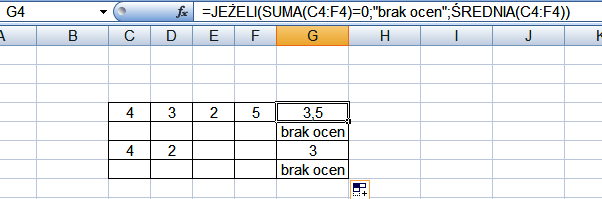

    I suggest a formula like in the screenshot :idea:
    Creating an IF Function in Excel to Display 'No Grades' in Empty Cells2018-11...png (12.54 kB)You must be logged in to download this attachment.
