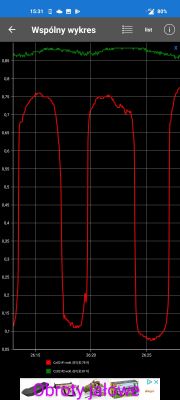

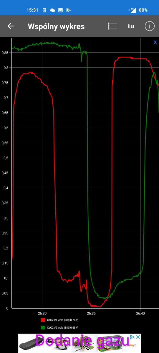

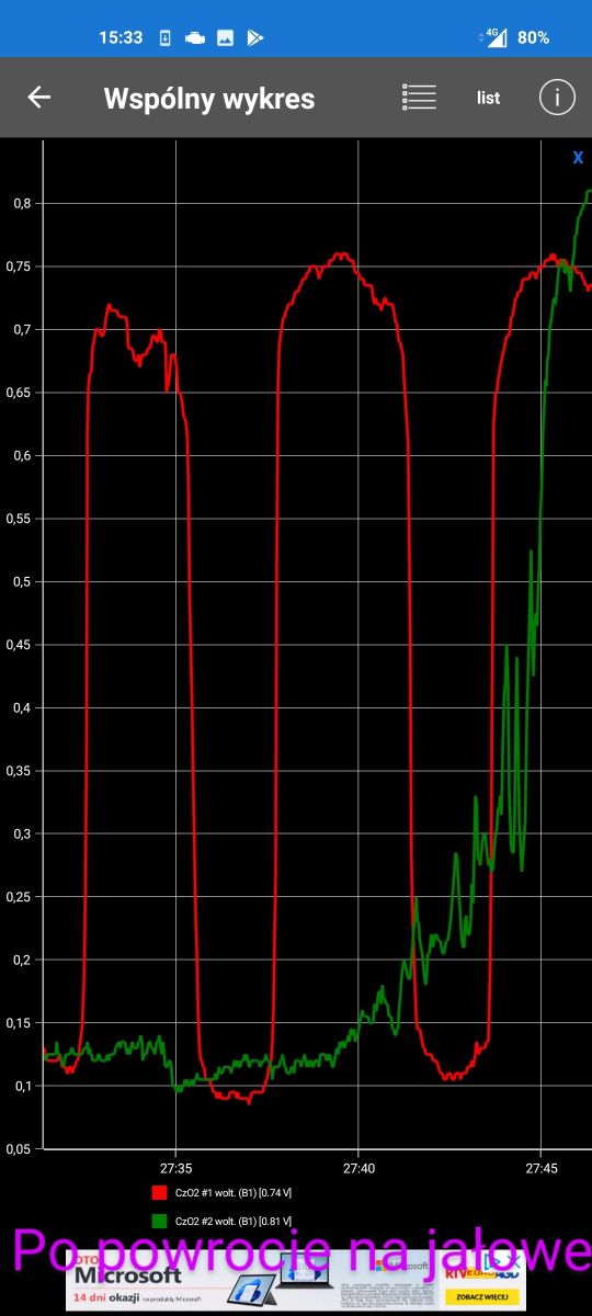

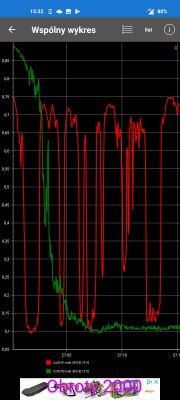

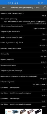

  • Requesting diagnosis from oxygen sensor voltage graphs
    #9 20034018
    chojnacki987
    Posts: 29
    I have also been tired of the error P0171 for some time. The frozen frame read from the application speaks of a closed loop that uses the feedback concentration of the oxygen sensor to determine the fuel mixture. I checked the voltage graphs from both probes but they don't tell me much. The unknown influence of the second probe on the fuel dose is also interesting, I do not know if it should be so or if something is wrong. I attach charts and a frozen frame, someone can determine if any of the probes is the cause of the error, and if not, where the problem may be.
