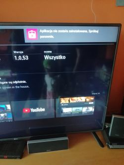

    Hello everyone, I'm new here so please be understanding.
    I have been the owner of the Lg LF592V tv for over 3 years. I have had a problem for some time because I cannot install any applications from the LG store. The problem appeared when updating YouTube, before starting the message UPDATE REQUIRED appeared after clicking Update, the installation process starts and an error appears The application has not been installed. Try again. This message appears with all applications, I will add that the browser flashes without a problem. New software update is not approved, all marked I do not know where to look for the exit. I count on it for your help. greetings

    Haven't you run out of memory?

    Where can you check it? I don't have any applications what would the space take?

    It should be somewhere in the settings, but the easiest way is to uninstall something and then check it.

    There is nothing to uninstall anymore, so I don't think it's a memory problem

    In that case, it probably remains only to restore the factory settings.

    Well, unfortunately, I did 2 times and also no effect ...
    Added after 5 [hours] 9 [minutes]:
    PROBLEM SOLVED!
    I connected the TV to another network and managed to update the applications ? after connecting to the old network, the applications work properly but it does not download other ...

    I recommend that you change the DNS in the advanced network settings of the TV to one of the following two
    9.9.9.9
    Or
    8.8.8.8
    After setting, turn off the TV for more than 1 minute.
    After turning on the TV, I launched the lg content store but I got the info that it is temporarily unavailable. After the second click on lg store it worked and the applications are already being updated and installed.
    DNSes have been recommended to me by an LG telephone consultant. These nines work for me.
