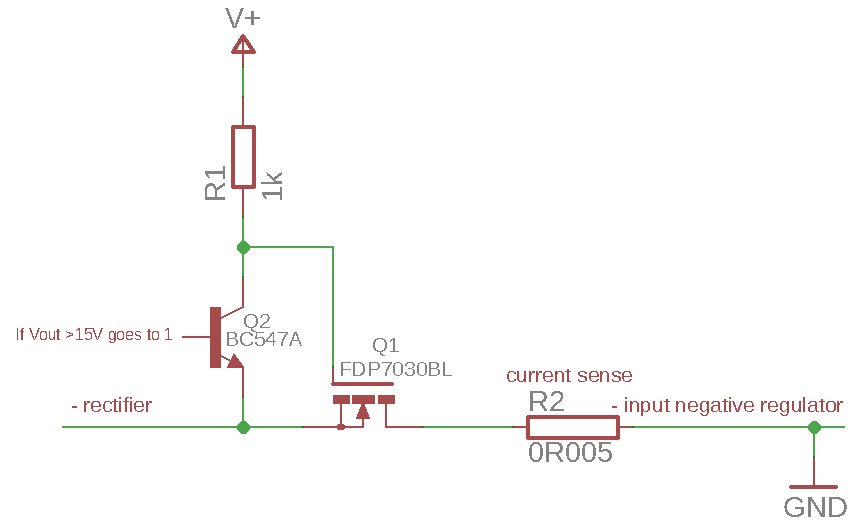

    Hi there, I want to install a protection system using a transistor like a switch in the negative rail of my ham radio power supply. But before need to know which is better a power N-MOSFET like IRF3205 or an IGBT like SKW30N60 or a more powerful one.

    You are looking for protection what for?
    Only for power supply?

    Not to protect the power supply, protect the load, or my radio, the semiconductor will stay in series with the negative output connector.

    Hmmm to protect your radio or load connected to power supply?
    Over voltage protection? Or over current?
    Any schematic?

    Well, to protect my radio from overvoltage like a SCR crowbar does but instead burn a fuse it opens the negative rail. I know that SCR crowbar is a very safe topology but it can burn not only the fuse but power transistors, rectifiers the SCR and so on. Using an electronic switch circuit made of a N-channel Power MOSFET I can avoid all these possibilities and either protect my radio, easy and safe!
    After a little search on the net I found some logic N-channel Power MOSFET that switch on with just 5V

    IGBTs are used for high voltages. At 12 volts it makes no sense. There will be more than 2V of voltage drop on the IGBT.

    By what do you judge that it is better?
    What is the current and voltage in your circuit?
