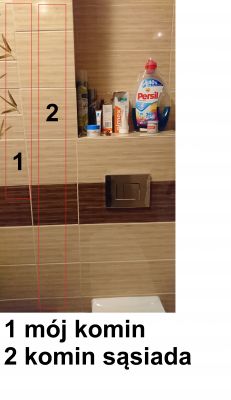

    I live in a block of flats. For some time now, air has been blowing from the toilet in the bathroom - specifically, from the hole through which water from the tank flows into the toilet bowl. From my observations, I concluded that the effect is felt when the kitchen hood is turned on by a neighbor living below. Initially, there was supposed to be a shop next to me, but the plans changed and there is a private apartment there. Their kitchen is directly below my bathroom. We have separate ventilation shafts. Air is also released evenly from the water flush button (I marked the ventilation shafts in the photo). I have been "fighting" the problem since April 2018 with rather poor results, the cooperative will do its best (but does nothing), the guy downstairs won`t let anyone into the apartment. The problem also occurred with the neighbor above me with the same symptoms. The entire bathroom smells of cooked food and burning pets. How is it possible for odors to escape through these holes? I don`t know where to look for help anymore. Who to approach with the topic? Will a building inspector do anything?
    Regards

    The apartment was bought new, I am the first owner. The plans I have show that the ventilation shafts are not designed for hoods, but for gravity ventilation (I think that`s what it`s called). That`s all I found on the Internet. Oh, and I remembered something else. On the left side of the visible chimney, there is an electrical socket (in the photo), from which there was also blowing, but I sealed it with some mass and it`s ok.
    So it doesn`t have to be connected to the chimney I marked in the photo, right?
    There is a turbo extractor installed on my chimney - something rotating.

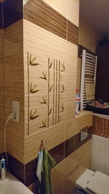

    The last inspection looked like this: a guy from an external company came and put a fan on the ventilation grille and that was it. He wrote something down and wanted to leave. When asked why it rotates so slowly, the answer was that this is what happens in bathrooms. And that`s it. He just had to take a measurement and he did. He wasn`t very talkative. I didn`t pursue the issue with the cooperative and now I see that it was a mistake.
    The construction was done by professionals on my recommendation. I visited them practically several times a day and watched how they were doing.
    At first everything was fine. I`ve been living here for several years. It started less than a year ago when I wrote.
    In general, getting something done in a cooperative is almost a miracle. This institution is one big concrete, only the president has the decision-making power and we depend on her whim when and what will be done or repaired.
    The photo shows a floor plan of the apartment with the bathroom marked. You are better experts than me, maybe these chimney markings will tell you something more. I don`t know how the other pipes go. Perhaps next door, since there is a toilet planned there - I didn`t move any drains, everything is as built.

    In my opinion there are two possibilities:
    1. The neighbor on the ground floor connected the kitchen hood not to the ventilation duct, but to, for example, a technical shaft intended for water and sewage installations
    2. During the construction of your bathroom, the ventilation duct of the ground floor apartment was damaged, as a result of which the fumes find an outlet in your bathroom.
    Perhaps the unpleasant situation is intensified by the chimney cowl on your ventilation duct, or perhaps your neighbor`s ventilation duct is partially/completely clogged and the air escapes through the smallest available gaps.
    Either way, a local inspection by a reliable chimney sweeper is essential. Call several companies providing such services in your area and ask if they would try to find the source of the problem. With today`s technical aids, this shouldn`t be difficult.

    Let`s hope it doesn`t turn out that when installing the toilet frame, your installers destroyed the wall of the neighbor`s chimney shaft. If you had the opportunity to check your neighbor`s chimney with an inspection camera to see if the shaft at the height of your apartment is damaged. Chimney sweepers have such cameras. Because you may look like a fool if you fight and it turns out that the problem was caused indirectly by you.

    Maybe I expressed myself incorrectly because I meant the ventilation duct. Previously, there might not have been a problem because maybe the neighbor did not have a hood with forced ventilation in the past. As for the installation shaft, I rarely did it in blocks of flats, but I saw that it was always bricked up.
    In the photo and project, the neighbor`s canal is right next to the frame, the hole theory is very likely.

    After long struggles, something finally started. It turned out that the guy from downstairs had penetrated the pipe from the hood into the space where the toilet drain pipes are. The wall in the staircase was chiseled (several attempts) and so far it`s ok.
