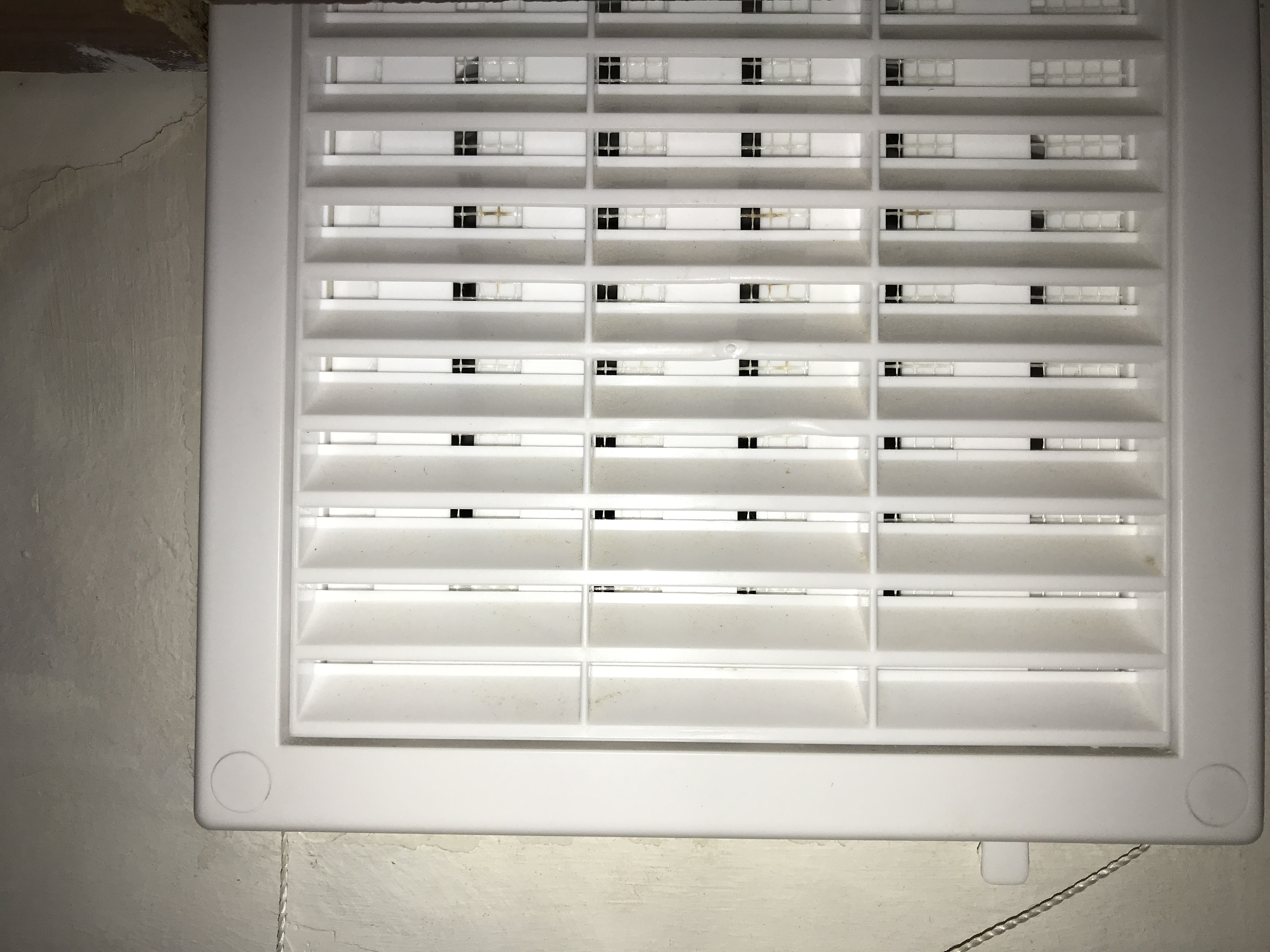

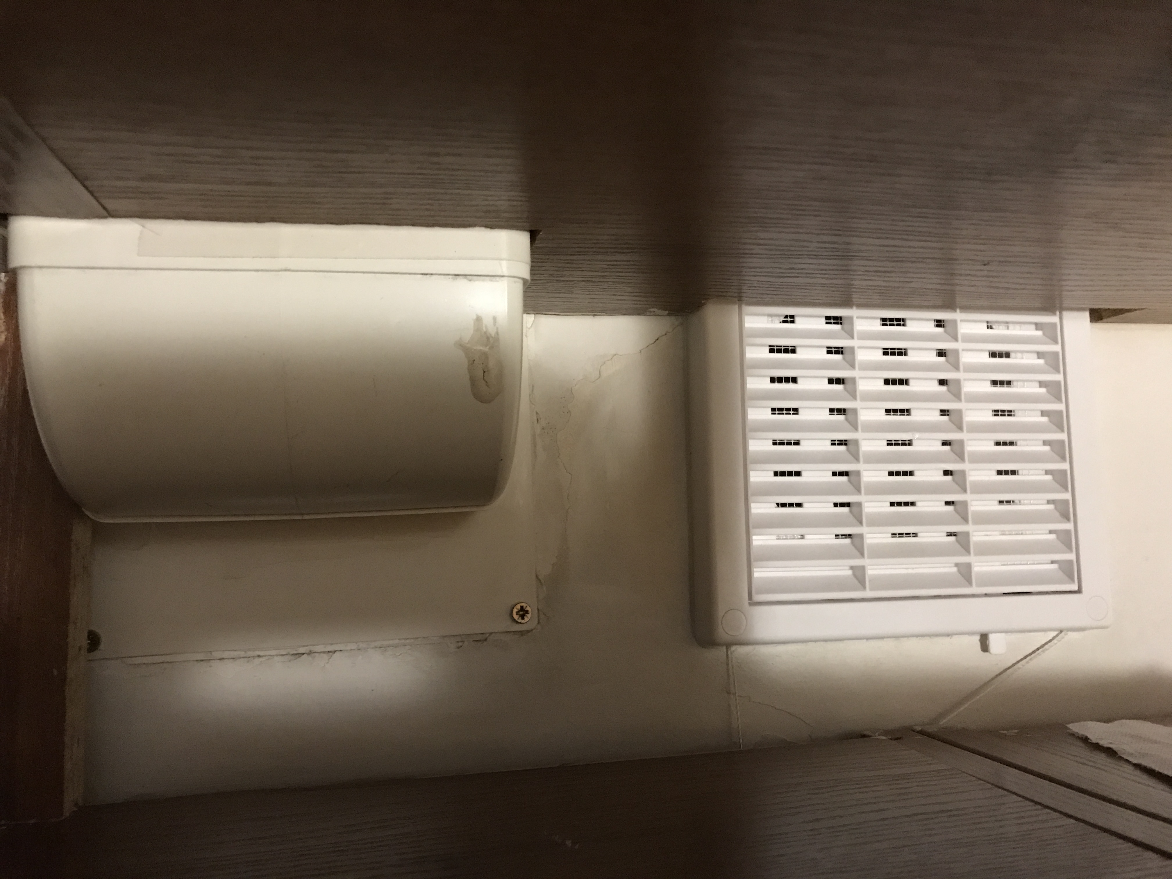

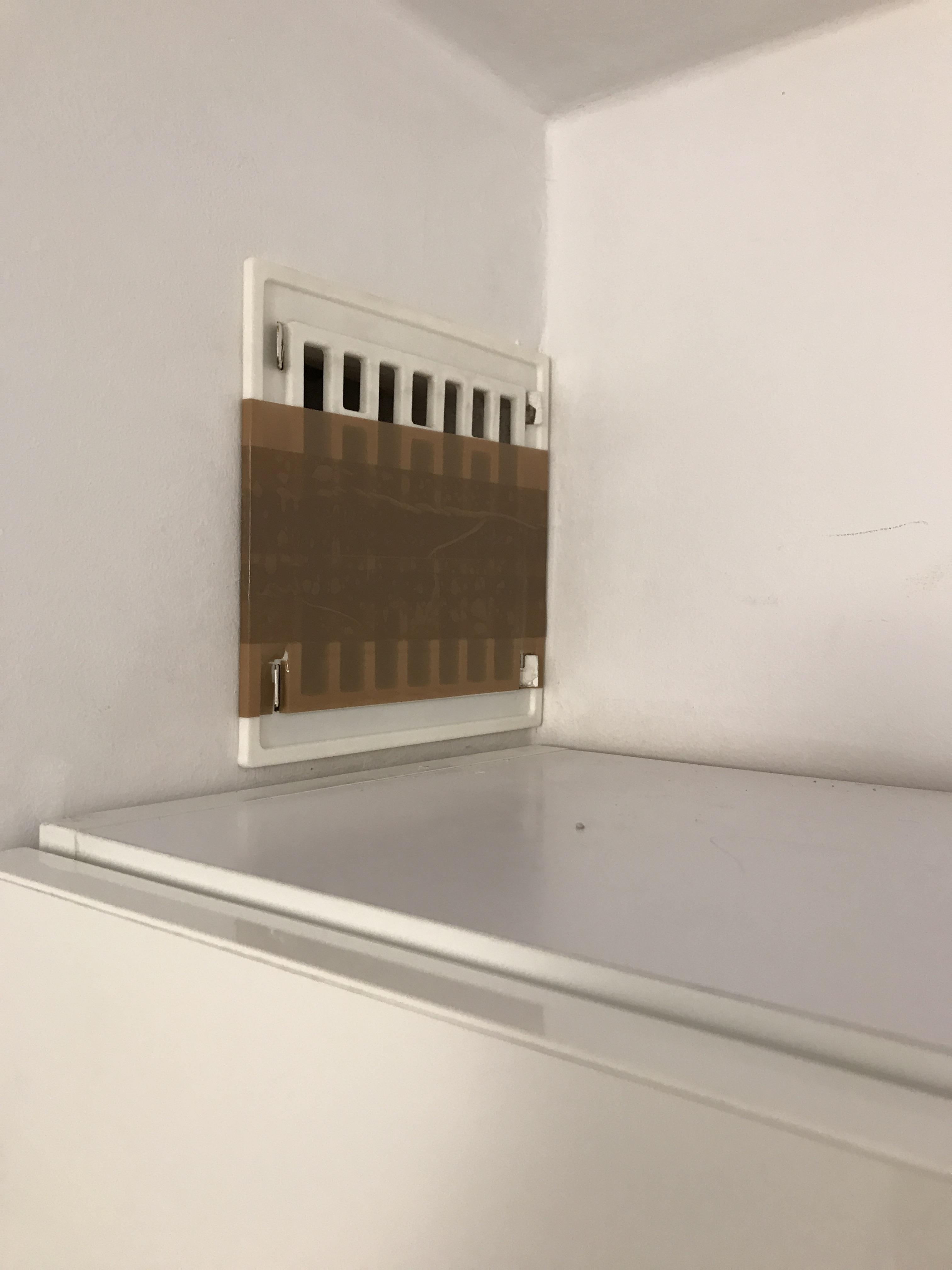

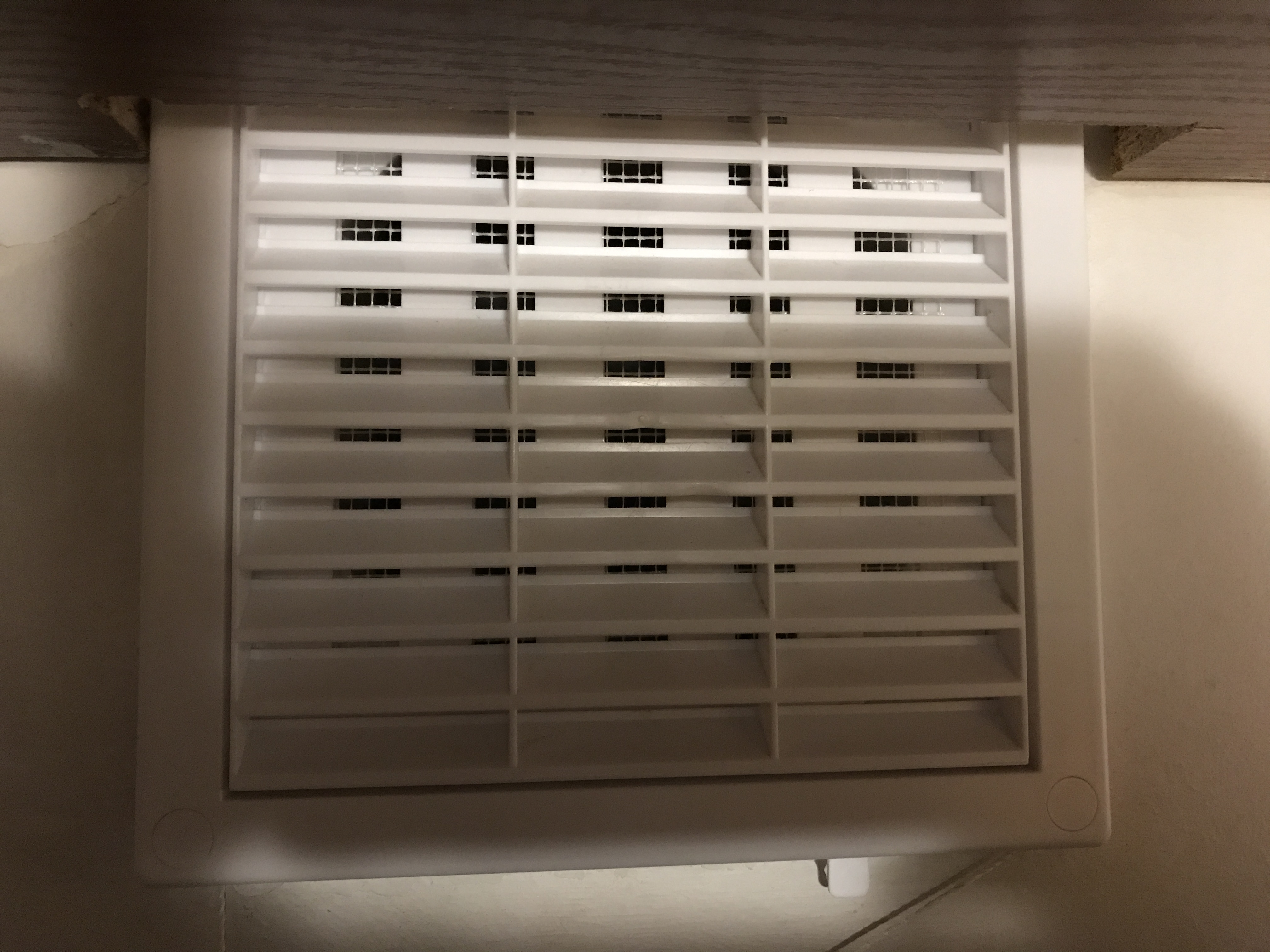

    The block from 2002 boilers was not planned. In the kitchen I put on an adjustable grille as in the picture. In the bathroom all the time one grille is covered. Mounted diffusers are Ventair II Trdn with an air flow of 25m3 / h. The hood is Faber Synthesis x 90, I was looking for specifications in the network and I think it should have a blocking valve, but I'm not sure. I screwed the diffusers to a minimum gap, because they cool the room very much. I wonder to completely blind the eaves grille from the inside, because I do not use too often only in cooking, but then I still have to open the window. Also, I think I would just open the window while cooking.

  • #5 16953457
    Wlodek22
    Posts: 1790
    Help: 78
    Rate: 526
    You must understand how gravitational ventilation works.
    It will always be accompanied by the phenomenon of "cooling" the rooms. You have to come to terms with it and simply adjust it.
    If you limit the inflow of air, on the other hand, already with two ventilation risers, vertical back draft with weaker draft may occur. So limit and align the flows on the sheets and do not limit the diffusers.

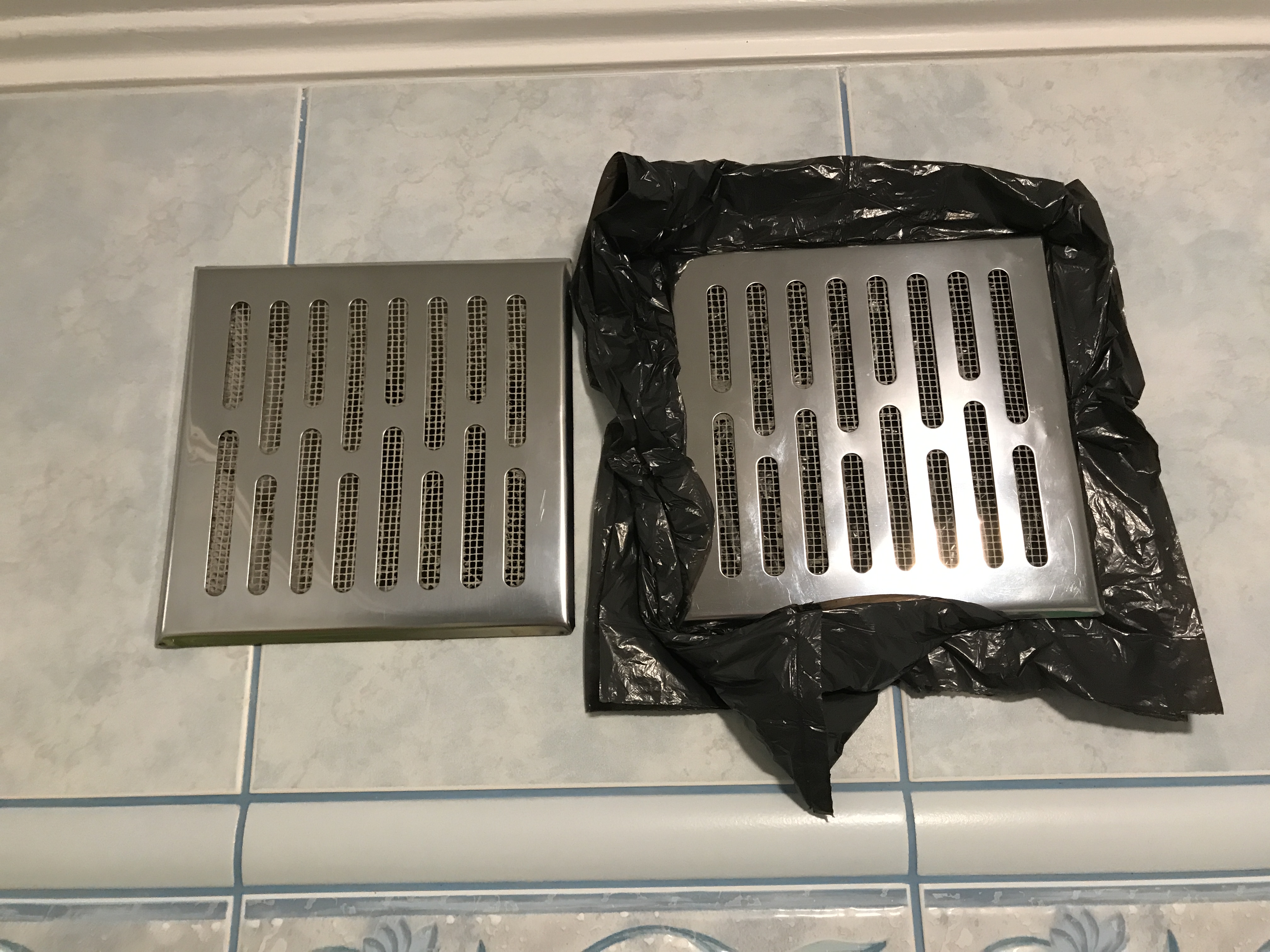

    In your opinion, which grids should I restrict in the flow? Hood and toilet?
    I blocked the eaves duct. In the toilet I covered half the grille. In the bathroom, as you said, I blocked one box. Diffusers open for max. Blows from them sharply ...

    The door can't break. I covered the boxes as in the pictures. The string may not be spectacular, but it is. Diffusers in the kitchen and in the large room (one side of the apartment) blows gently. However, in the bedroom and the smaller room (the other side of the apartment) the diffusers from the bathroom grille blow as if more air was still needed to be replaced, despite the fact that the bathroom grille was 3/4 grille. Please look at the pictures. According to me, with such a reduction in the area of grates, the supply of air to the apartment should be stabilized, and it looks like it would be best if I was in the bathroom probably sealed the grille, and I can not do it. I don't know what else to do ...
    Maybe the kitchen door and the large room are suppressed by the internal door.
    The second thing is that in the kitchen there was reverse thrust, then the riser is cooled down and it takes time to heat it. Similarly, with a reduction in cross-section, the plummet must "cool down" so that the vacuum decreases.

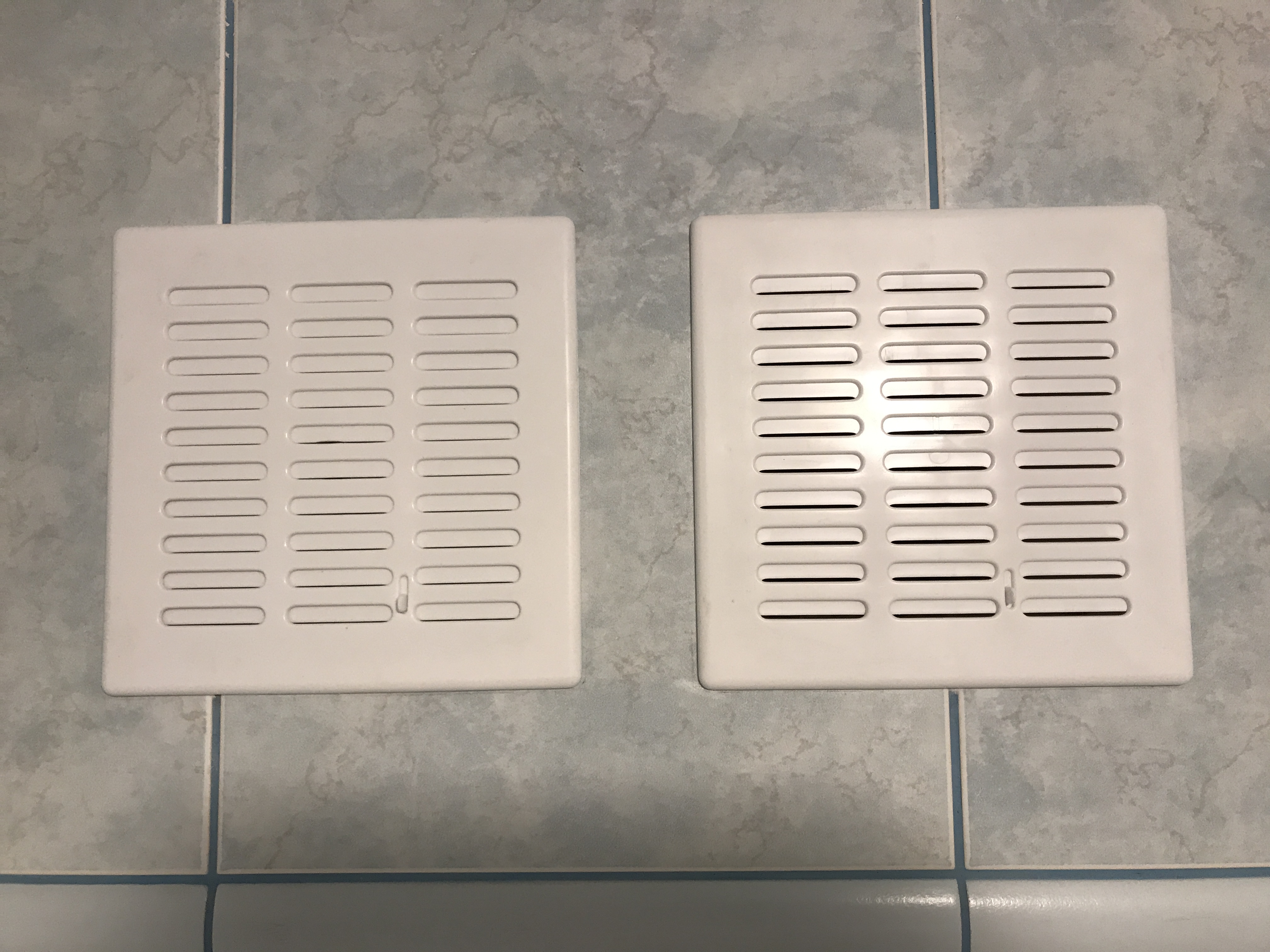

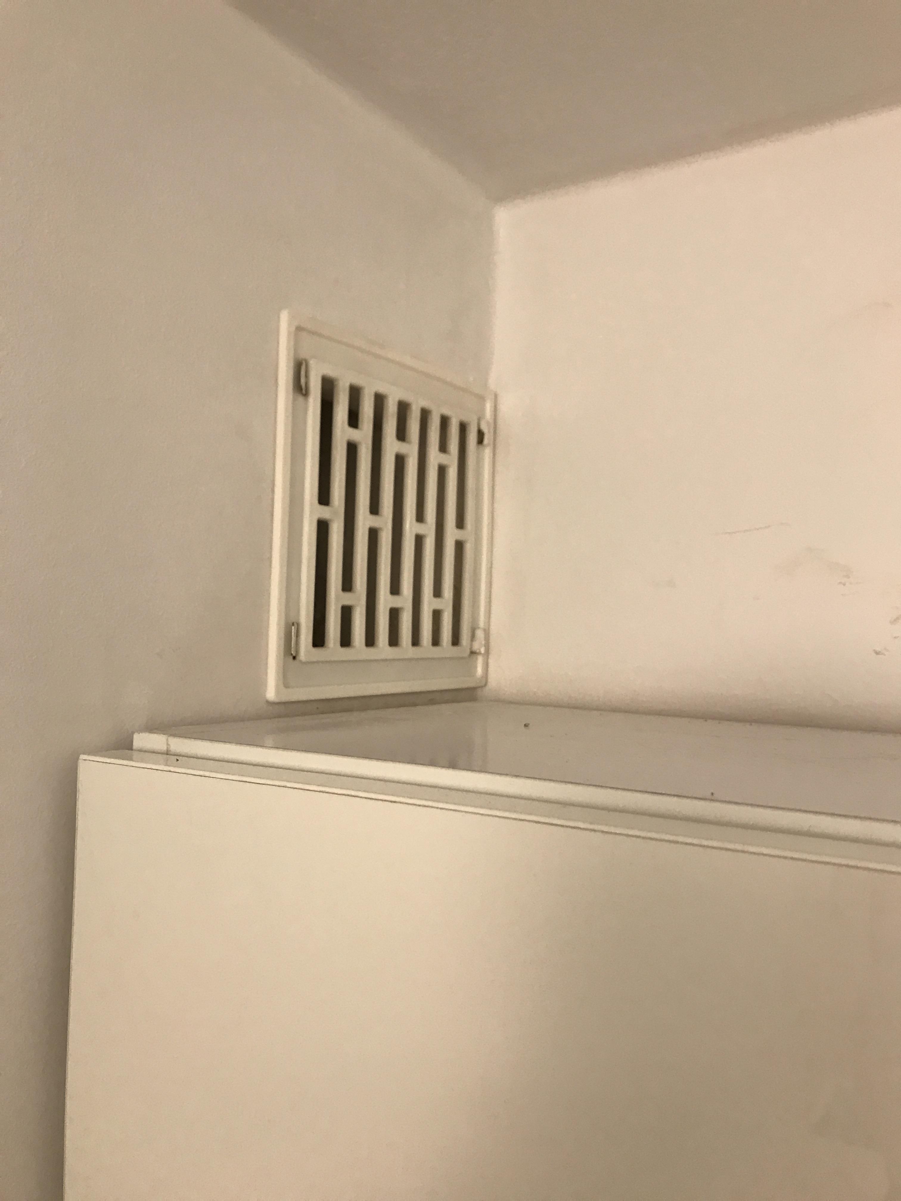

    The door in the apartment is locked only in the bathroom. Will these sealed grilles not cause insufficient ventilation in the apartment?
    I changed the grilles in the bathroom, set the flow in the kitchen, bathroom, toilet. I have inserted a backflow preventer valve into the hood duct. The entrance door in my opinion is very tight, I did not notice the possibility to remove the seal, unfortunately. Still, in my opinion, too little air gets into the apartment. This is demonstrated by the flows on the diffusers. Windows evaporate after bathing at the bottom seals.
    Unfortunately, the wall in which the ventilation chimneys run is icy 16 degrees, which translates into temp in the toilet. Gentlemen, what else can you do?
