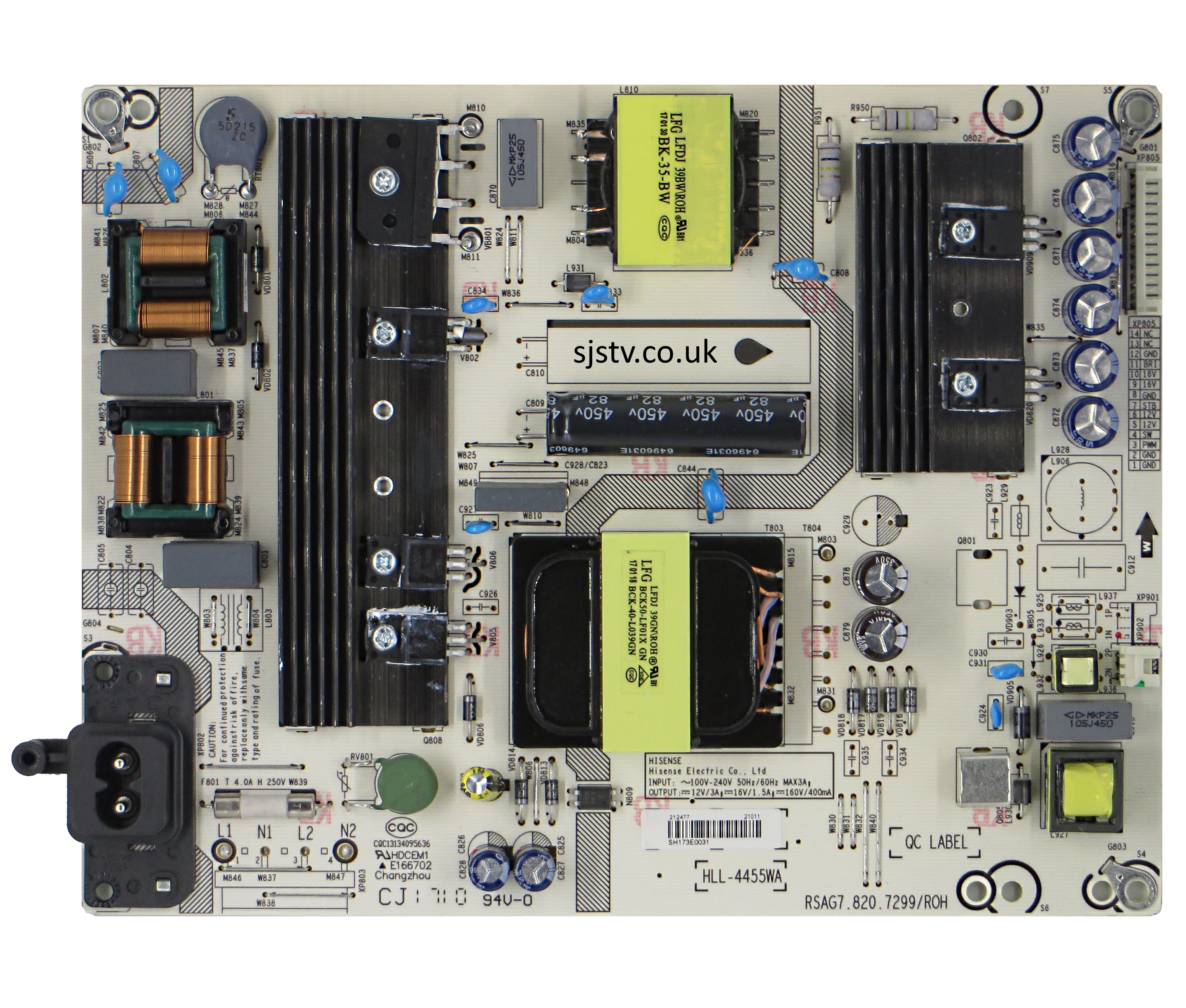

    U on C809 is just 370V and I believe is not enough power to transfer in secondary circuit of power.
    If I disconnect tcon or just display the tv don't go to stby.
    Do you have diagram of powerboard HLL-4455W?

    Such
    HiSense H49N5700UK
    * also for H43N5500 / H49N5500
    - PSU - RSAG7.820.7299 - HLL-4455WC - 213880
    - H45N5750UK ... HLL-4455WA (RSAG7.820.7299) / * right photo
    HISENSE H49N5705 - Goes to Standby After 10-15 mins: Low U on C809, T-Con, Need HLL-4455W Diagram HISENSE H49N5705 - Goes to Standby After 10-15 mins: Low U on C809, T-Con, Need HLL-4455W Diagram
    Look for this SM ( rsag7.820.4614 ) Link
    OR ( rsag7.820.5687 ) Link
    On (ebay, picclick ) there are a whole bunch of them , price from 25-35 Eur/ 25.GBP

    I had the same problem.
    Instead of the w825 jumper, I put a 560kom resistor.
    FCP voltage measurement branch on c809, 3x 3.3Mom.
    The voltage on the c809 increased to 388V.
    The TV does not turn off.
