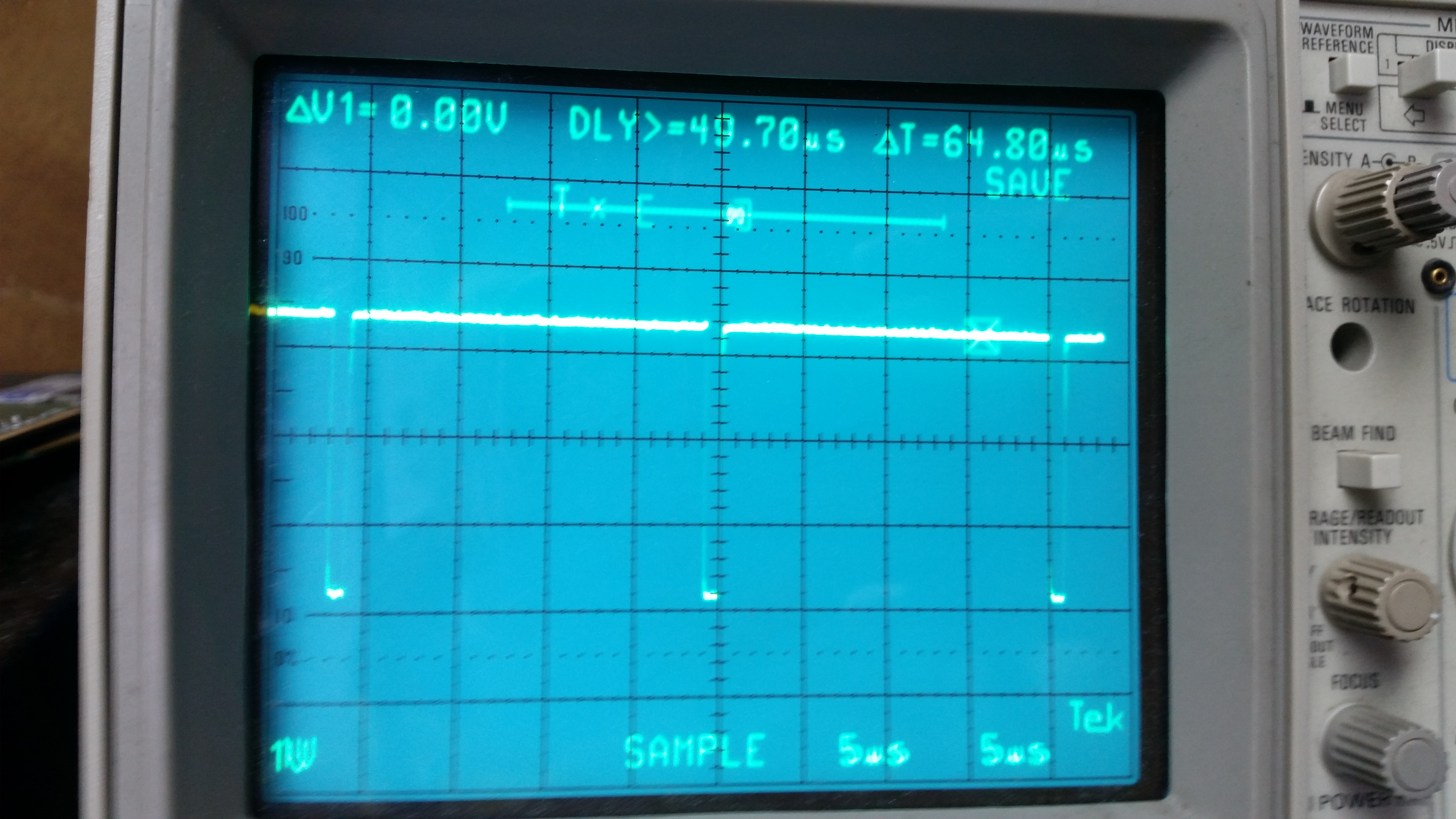

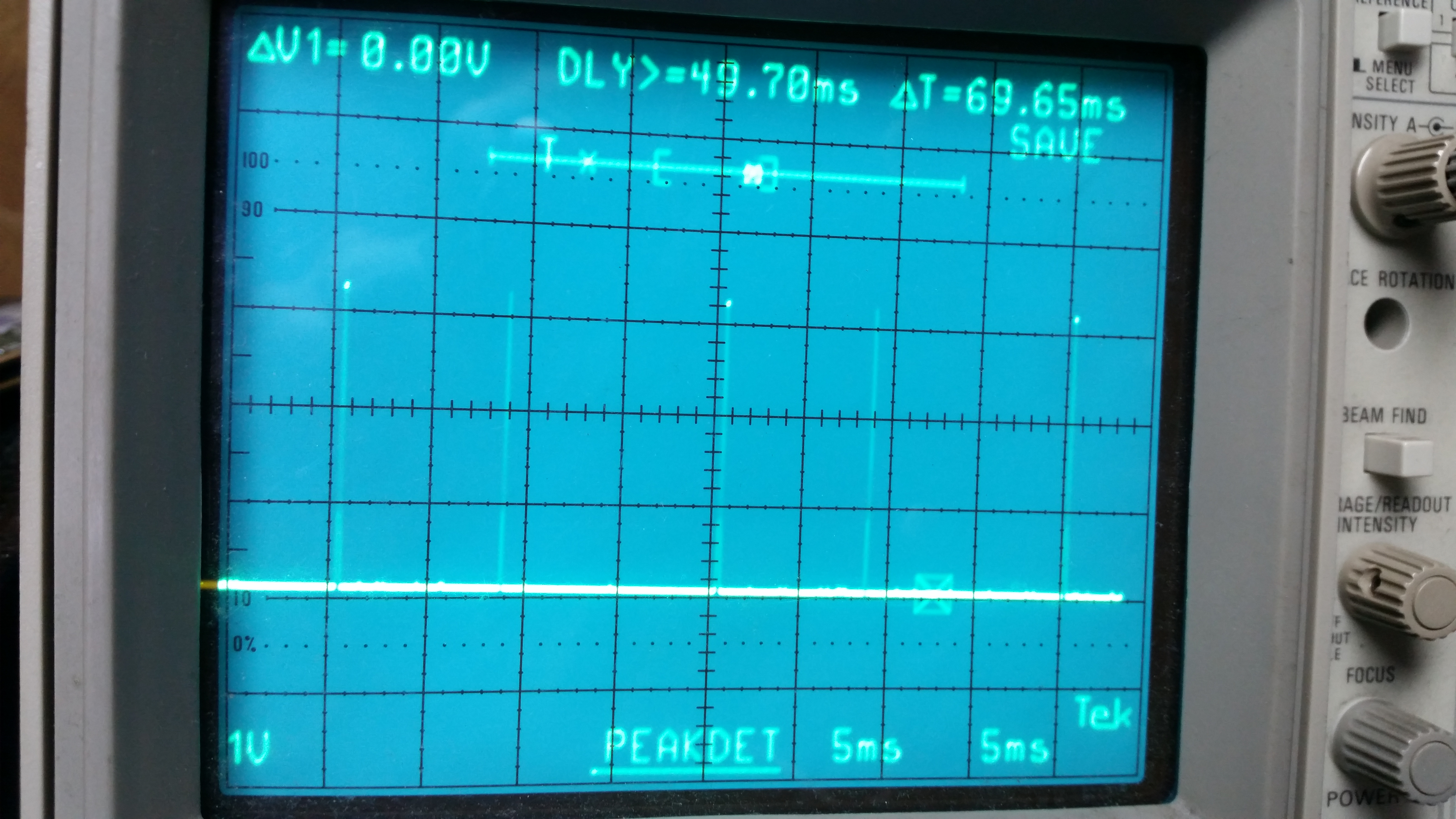

    TV as in the description. After switching on the network, the LED lights up with continuous light indicating work on st-by. After switching on, the LED blinks and stops all the time anyway. In general, TV can not start. I suspect T-CON, but I would like to make sure. Unhooking him does not change anything. After unplugging the BLU on / off from the connector on the power supply board, the backlight gets up without any problem (when the panel is off, the signal is shorted to ground). The problem seems to be on T-CON. The STV1 and STV2 signals are in the form of extremely short "pins" and have a voltage of about 4mv on the meter. I do not know if the main panel is waiting for a response from the logic if there is an image and only then is trying to highlight it. Voltage on the power supply all in the standard.
    T-CON -> LSF460HJ02 (BN41-02069)

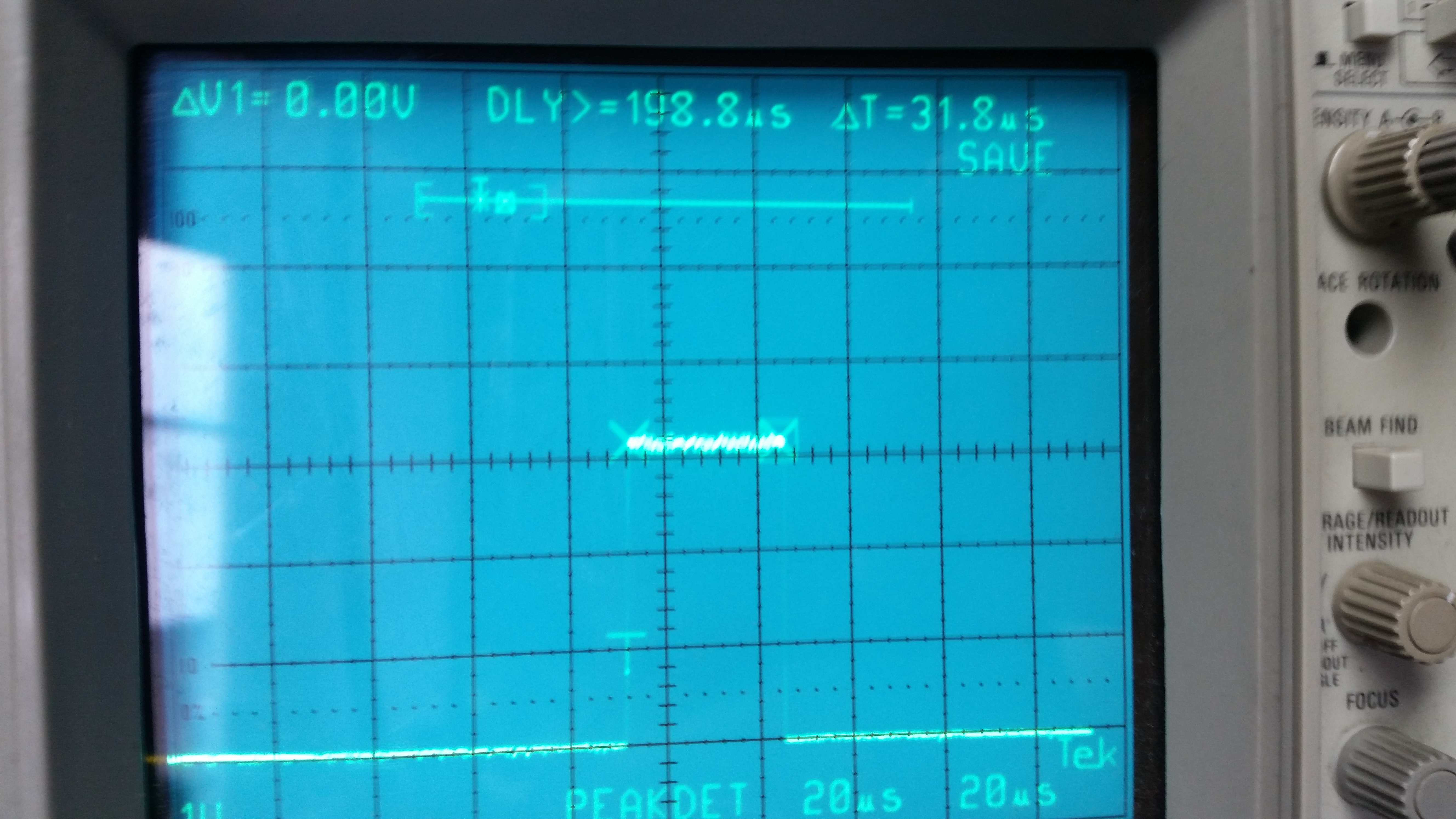

  • #8 15452971
    elec
    Posts: 297
    Help: 11
    Rate: 21
    These are valid values
    P_DIM = 3,9v
    BLU_ON = 4,92V
    Col. you wrote
    Quotation:
    After unplugging the BLU on / off from the connector on the power supply board, the backlight gets up without any problems
    Explain it?
    Blu it normally has 0.2V. Removing this pin from the connector going to the main causes the backlight to turn on and then it has a value of 2.9V, in order:
    PWM DIM1 = 1.02V
    PWM DIM2 = 0.85V
    PWM DIM3 = 0.85V
    PWM DIM4 = 1.23V
    The release causes ignition because in the main this signal is shorted to the mass of the transistor at the moment of the absence of the matrix ignition signal.
    I will try to measure the tension soon, although probably there is a problem because probably not all are described, because I know that I could not find something there.
    STV signal
    Samsung UE40f6650SS - LED Blinks but Won't Turn On: Possible T-CON Issue (LSF460HJ02 BN41-02069)
    STV signal
    CPV SIGNAL

  • #10 15453324
    elec
    Posts: 297
    Help: 11
    Rate: 21
    They are ledy. All 3 lights up when you try to start the TV. As for the tension:
    HAVDD = 8.4V
    VOFFE = -11,6V
    VONE = 30V
    HAVDD = 8.4V
    VSS_7.5V = - 8.3 V
    AVDD = 17V
    VCS1 = VCS2 = 6.1V
    The rest as I wrote is not described, but I find another description in similar values.
    What you can see SDP1209 becomes quite fast and clearly "warm", even very.
    I have found the voltage which after supplying the T-CON appears with the T-CON READY - 3.3V (3.24V) appears there. In general, it seems to me that the 3.3V branch is quite heavily loaded, even if I raise it from an external source, it always lacks it to a full 3.3V, normally it is 3.26V.
    I also substituted the main memory for sure. Generally reading the forum of foreign colleagues including link from col. Lisek I am thinking about damaged SDP1209.
