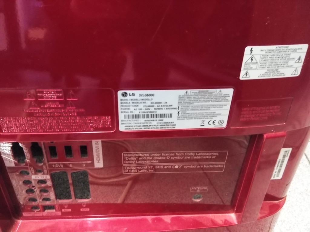

  • Marca LG
    Modello 37LG6000

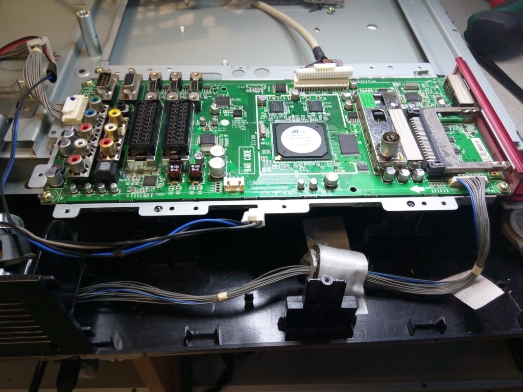

    Main board ebu42372382
    Pannello LC370WUN SA A1

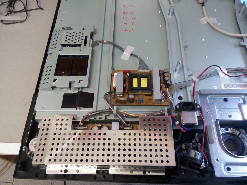

    If the TV is not hot, once it is turned off it will no longer turn on, only the backlight will appear

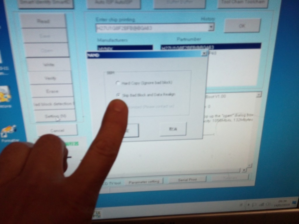

    Fault due to the nand that cooled returns to work

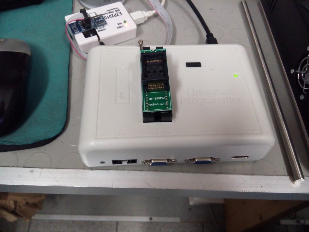

    By removing the bad sectors with the programmer, everything is ok
    programmer rt809h
